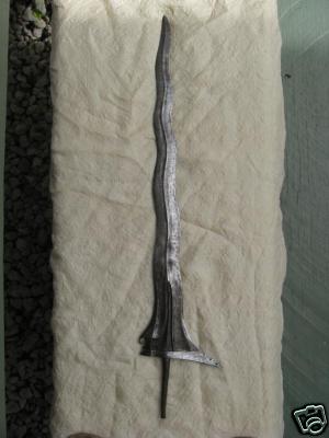

I buy this keris blade from e-bay because I like the shape of the blade.
All informations and inputs are welcome. The blade is 16,75 in / 42,55 cm.

From what I can see it looks nicely executed .
I like the ada ada and the strongly defined work in the sorsoran .
Any ideas yourself, Ferry ?
E. Jawa ?

Thank you Rick for comment. Yes, my guess is also East Java. The long ada ada I also like. Any ideas which dapur this can be?

Ferry,
Regarding the ricikan (details) of your keris, that has a sekar kacang, tikel alis, two sogokan (front and rear), sraweyan, greneng and mainly with ada-ada (a little bit gigir lembu) -- then it has characteristics of keris of dhapur "panimbal". The problem is, panimbal usually has two lambe gajah. But yours has only one...

Dear Pak Ganja,
maybe I am completly wrong, but Panimbal don't have a lambe gajah, or?
PS: my name is Detlef and not Ferry.

I apologize, Detlef for the wrong mentioning of your name... Panimbal usually has lambe gajah. Even there are two different opinions on this. Either one (Mr Haryono Guritno, for instance) or two lambe gajah (Mr Harsrinuksmo)... You may check also in "Dhapur" book which based on Pangeran Hadiwidjojo's sources....

you are right, Haryono Guritno describe it with one lambe gajah and all features you write before. I check my sources and now I am complete confused. Tammens for example describe it without sekar kacang and without lambe gajah (this don't mean so much, it's not the first mistake I found by him). But the same like he describe in his first book I found by picture in the new book "The Javanese Kris" from Groneman on page 167 from an old source from 1859, a drawing described as "dapoer Paniembal" also without sekar kacang and lambe gajah. So Tammens maybe use this old source? And what is now correct for dapur Panimbal? It's a big different if a keris have sekar kacang or not! If there are one or two lambe gajah maybe already essential for a correct description of a dapur but if there a sekar kacang or not, this is a complete different dapur!!!

In my opinion, not a Javanese blade.
That is not a Javanese ada-ada, the ron dha is abysmal, but the overall garap is Bali --- and the length:- 16"? Jawa? Nggak.
I reckon this is a Lombok blade --- they seem to like those funny sticky up ada - ada.

Thank you Mr. Maisey, like usual from you a very logical desicion.
You can give me maybe also a explanation for my confusion about the two completly different descriptions from the dapur Panimbal?
sajen

Sajen, many, if not most things in the world of the keris are not carved in stone.
In fact, in Jawa, it is not only names concerned with keris that change, names of many things change from town to town, village to village and even person to person. The Javanese language is referred to by linguists as a non-standard language. Each speaker of the language seems to believe that each word he utters is his own personal property and he can do as he will with it. Bearing in mind the strict heirarchy of formal Javanese, this phenomenon does seem rather peculiar.
In any case, from this base, we find a lot of variation in definitions of the meanings of words, and this flows through into definition in many other areas. When we look at definitions as they apply to the form of keris, those definitions strictly speaking should flow from criteria set down by the various Karatons, however, at the present time the criteria of the various keris forms, or dhapur, appear to be able to be defined by anybody who has a following of believers.
In another recent thread we found a further example of variation in the definition of dhapur.
Speaking only for myself, I feel it is perhaps best not to become too entangled in discussion of dhapur. You could well have as many opinions on any specific dhapur as there are keris study groups.
Now, in the case of this blade, as I have said, I do not accept this as a Javanese blade, if this is so, it really cannot be defined in Javanese terms, so it is not really correct to try to afix any Javanese dhapur name to it.

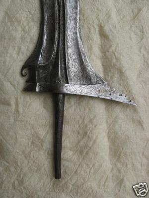

This is looks like an unfinished keris for me. you can see there are so many areas with clumsy tool mark. the sraweyan is not smooth(need more work on this), the pijetan/blumbangan, the gandik, the sirah cecak, another hours of smoothing job would make it beautifull.

Its finished Ferry --- according to the man who made it.
Its just not finished to a high standard. Don't forget that very often a lowly keris will be made with very limited tools. The final finishing was often done with pieces of stone or terra cotta, and the final polish with ground terra cotta and water, or ground coral and water.

Dear Ferrylaki,
I think it is difficult to see it clearly on the pictures from the seller, it is an old blade and what we see is maybe only corrosion. The blade have had maybe harder corrosion and is repolished and this not smooth?
I will try to make better pics when I hold it in my hands.

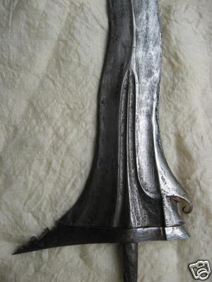

received the blade and it seems to my eyes that the not smooth finish of the blade is a mixture between a really not smooth finish of the blade and maybe a grit blasting and cleaning with crude tools to remove corrosion from a former owner of the blade. You can see many cratches from a file at the blade and unevennesses at the complete blade what let me think that the blade is cleaned by grit/sand blasting one time. It's a shame!

A few hours with wet & dry paper, a light re-etch, and you'll have something pretty OK.
When we buy keris from outside the culture it is not at all unusual to expect to have to do a bit of work to bring them to where they should be.

It looks better in your photograph. look at the pijetan and blumbangan. it still untouched and shows us that it is an old keris. the sogokan loks very fine, the kembang kacang is strong. good luck with the sanding process. you'll find this keris more attractive and beautiful. what style of sarong would you like? 16 inch keris is a little bit longer for a javanese keris, I agree with Alan. or maybe you've already have a warangka for this keris?

Hello Ferry,
thank you, yes also at the peksi you can see that it is an old blade, but some cratches I have to sand with wet paper to get a smooth facing. And Mr. Maisey have been correct when he say that it is most probably a Lombok blade so I have to look for sarung from there. A warangka with this size I don't have. Maybe I will get one by e-bay one day or by my next trip to Indonesia.

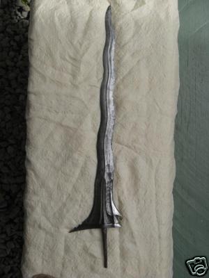

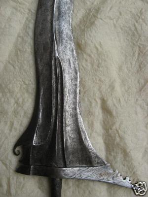

After all the time also this blade has get a new stain and the blade shows a fine pamor. Still don't have a sarung for this blade but like you see I don't forget my blades also when it need some time!
Do you think that this blade is it worth to get a proper sarung?

Detlef, another fine job bringing an old blade back to life. I certainly thing it deserves some good dressing and would recommend something in a Bali form since i believe Alan was probably right about this being a Lombok blade.

agree with you and Alan that it is a Lombok blade. Let us see what I will be able to manage the next years!

IMHO, Jawa or Lombok or even Bali provenance does not really matter, as I believe though the forging is quite well done, the blade was not made by an Empu or at least a Pandai keris. Look at the tips of the sogokan, and compare that with the blumbangan cleavage near the gandik. If its an empu made, definitely the line of the blumbangan would be nicely touch the tips of the sogokan, and cross the middle of 2nd luk. Any blade made by an empu or pande of any provenance / era would stick to this rule.
