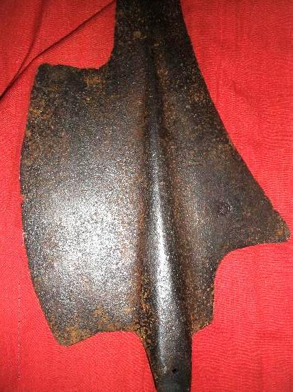

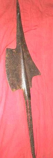

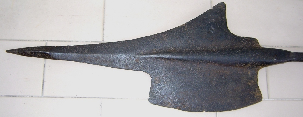

Default Early Halberd for coments

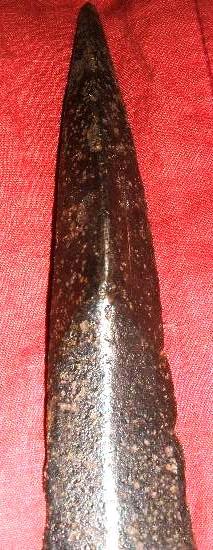

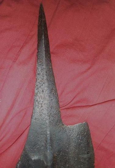

These are seller's pictures, probably taken with a low resolution cell phone.
I assume this is real early stuff ... or i don't know where to hide from myself .
Probably with me next week; better pictures to post, then.
To ID the maker's mark will be my main score!

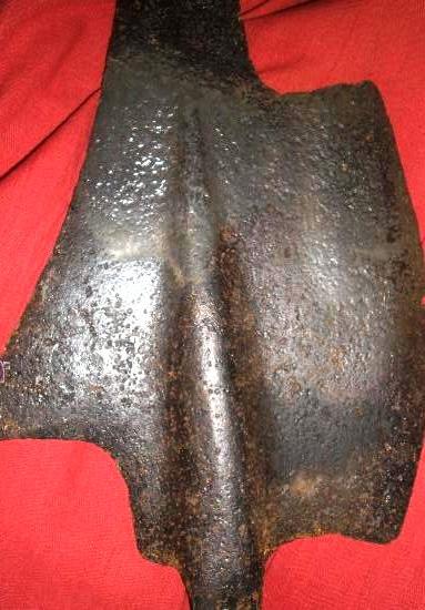

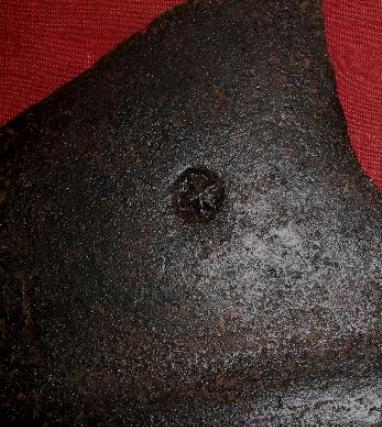

So it has arrived.
I didn't expect that the spear was reinforced in a such a sturdy manner; what a nasty lethal weapon this is.
It is now possible to figure out the mark is an eight pointed star. This type of marking is consistent with its aledged period (late XV beg. XVI century), as mentioned and shown in the work HAFTED WEAPONS IN MEDIEVAL AND RENAISSANCE EUROPE by JOHN WALDMAN.
I hope the experts like Matchlock come around, to either confirm or correct this assumption.

Old 1st July 2011, 02:13 PM   #3
A Senefelder
Join Date: Jul 2009
Posts: 214
This earlier form of halberd had a resurgence in the late 16th century. With the nice long langets this example has I would lean twords the 16th century date assigned to it by the seller. The nicely thickened tip makes this a good fighting, rather than ceremonial, example from what I can tell.
A Senefelder is offline   Reply With Quote
Old 1st July 2011, 02:37 PM   #4
Thank you for your coments, A Snefelder .-
Yes, definitely a fighting piece, much earlier than those which were (also) used to guard palaces and march in cerimonies.

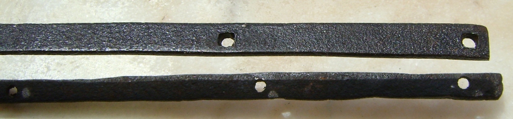

The langets are indeed impressive, with their 71 and 73,5 cms length, respectively ... socket cone excluded. One is shorter than the other, as the nail holes are offset. I beleive that this, together with the fact that the cross section of the langet bars is rather irregular, confirms the early age of this example.

Old 9th July 2011, 11:53 AM   #7

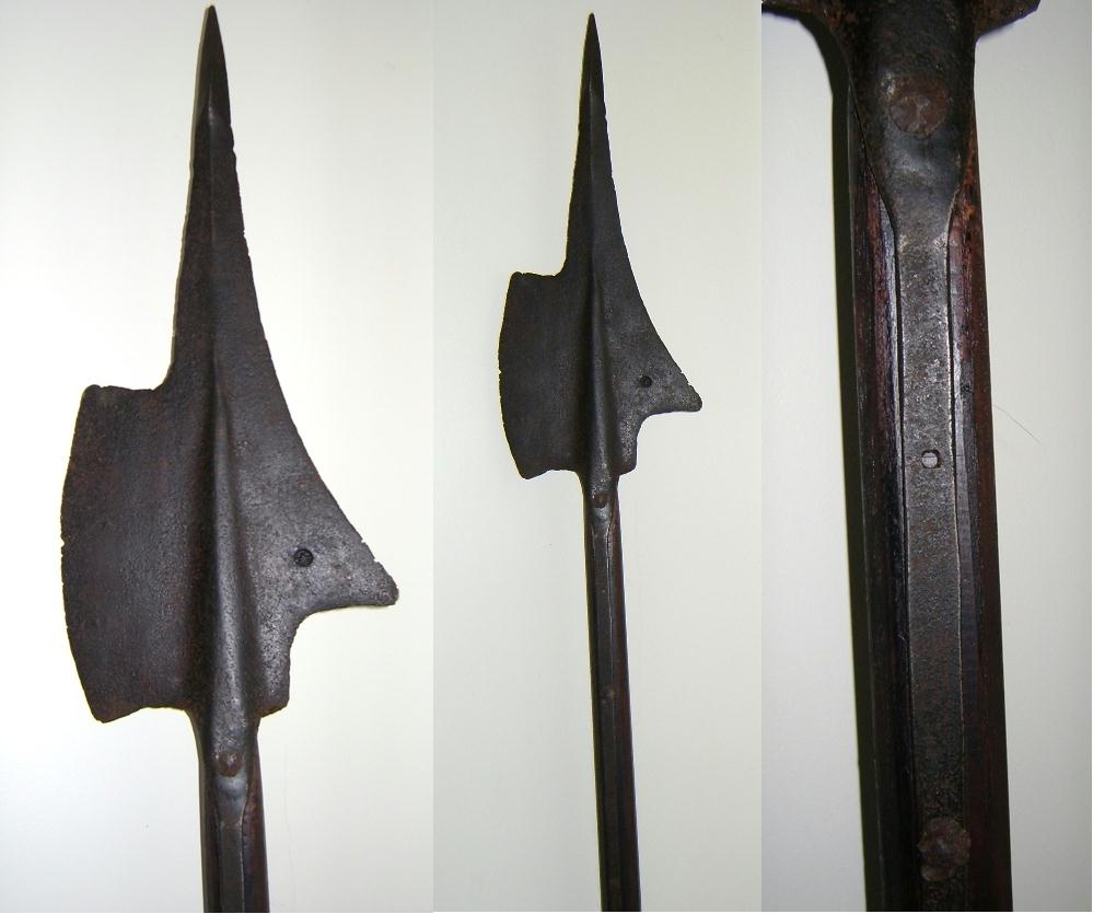

That's how it looks, after a bath of olive oil in the blade and a new pole in oak, with a rectangular section and the corners flattened ... with a hand plane, to give it a rustic look. The nails used are hand made ancient stuff. But as the langets holes were numerous (18) i only applied 10 nails in the vital places, as they are to thick and very hard to thin, shorten and sharpen.
The dark colour in the shaft was obtained wuth three hands of "vieux chaine".

Wow! That looks great. From the pics, you can't tell the shaft is modern. This is an exceptional piece as always, my friend. If you ever decide to throw it away...

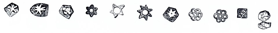

O.k., this is what I found out.
My first guess was mid to 2nd half 15th c., ca. 1450-70.
This surmise is backed up by the existence of a very similar halberd, Swiss, dated to the second half of the 15th c., and preserved in the Historisches Museum Berne. I attach scans from Wegeli's well known inventory of 1939. The text mentions that the lower end of the haft has a pointed iron shoe, just like my earliest halberd of ca. 1500. This is a feature which does not occur after 1500.
Please also refer to my thread
http://www.vikingsword.com/vb/showthread.php?t=7450
Congrats once more, 'Nando, you made a fine bargain and did good hafting work as well! Your new acquisition may well be of Swiss origin.
Various star shaped makers marks similar to that on your item are also to found on these Berne halberds.

Thank you ever so much for the precious data, Michl.
... and so good you posted those star marks; i will keep them in my files. The second one looks a lot like mine.
