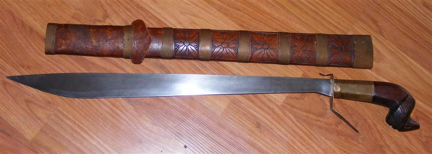

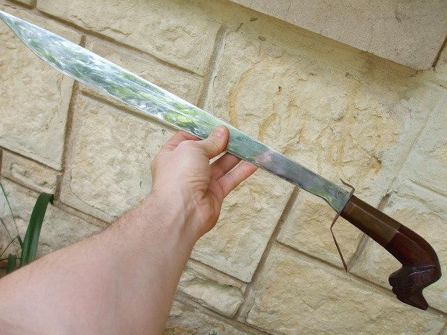

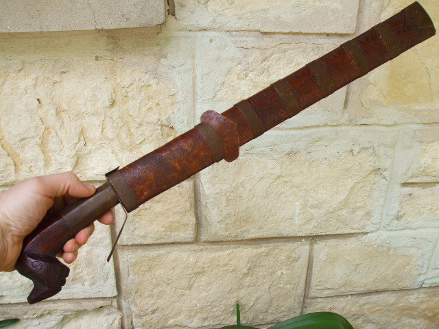

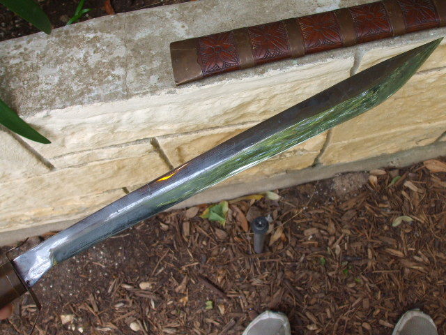

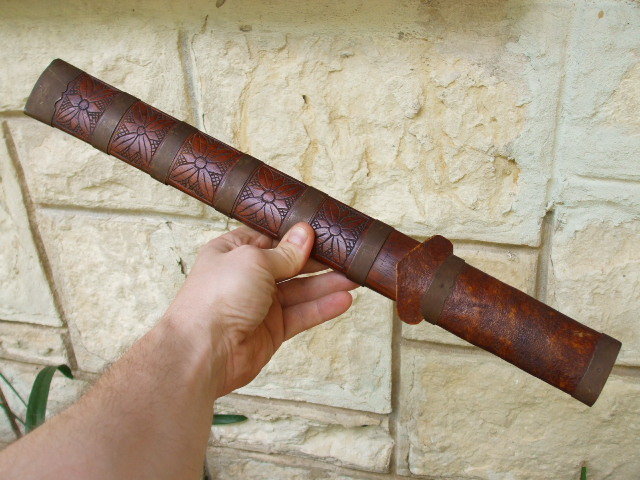

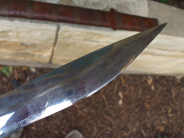

Here is the latest example that I ran across. I just don't want to change anything that could be original to this by mistake even though I am not fond of chrome and think it would look better without it. Here are some of the auction photos.

I always take off the chrome/nickel plating. It is never original to the piece.

To answer your question more specifically, to my knowledge it was not common practice for Filipinos or Moros to chrome plate their blades.

Thank you all for your opinions on what should or should not be done about the chrome plating on this piece. Now that I have read the rest of the comments and found that it was not a common practice in the Philippines to do this type of plating I think that I will be removing the chrome sometime in the future.

I do this carefully with varying grades of sandpaper and stones. I resist using a machine sander because there are little swirls it creates.
Also difficult to tell if it is chrome or nickel plate (which adheres closer to the steel and also not used in the Philippines in general nor Indonesia).
Hopefully yours is chromed which should come off easier.

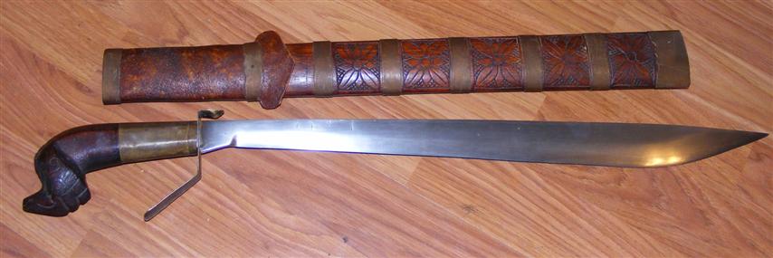

Here are a couple of pictures of this item after the chrome was removed and a light etch applied to the blade. The blade does have an inserted hardened edge but it is hard to see in the pictures as I had to take them inside, it is raining here again today. Now a light cleaning to the brass fittings and I'm done. Removing the chrome was a pain in the (insert appropriate word of your choice here) and I am very happy that I only have one more item that this needs to be done too.

I have to revise my opinion in post #11, the blade looks much better than before and you have done well to decide removing the chrome.

Hello Detlef, I'm glad that you like the results. I just wanted to try to return it to something close to what it was intended to originally look like. The etching was more to remove some of the gloss from the blade left after removing the chrome than it was to try to find any pattern in the steel. Again I am glad that you like the how it turned out.

I'm glad you went ahead and removed it Robert. Looks much better...
