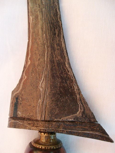

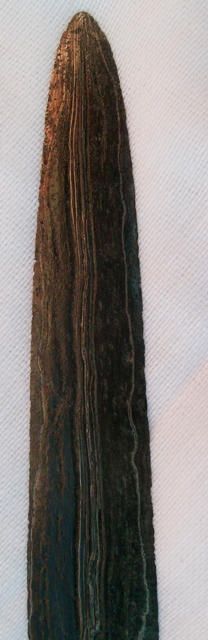

Today i did find a new keris but can someone help me out with the pamor ?
So far i know we can give it two names Sada saler wenkon or ..adeg wenkon
what would be the proper name
thanks ,

Hi Danny,
nice keris again! I think both is correct. personally I would call it sada saler (sak ler) wengkon.

I like this keris Danny.
I would tend to go with your first name, but other's mileage may vary.

It depends upon what school you went to.
I've always called it adeg wengkon, and I cannot think of anybody that I know personally who calls it anything else.
Pamor names can vary a lot, depending on where you are, and what group of people you associate with.

Look how flexible i can be in such matters...i'm more than willing to join Alan's ranks here.
Whatever name you use i still like the keris.

some may call this pamor 'teja kinurung' but i like 'adeg wengkon' too.....

Yes Danny, simple.
But one of the most difficult pamor motifs to make.

Posts: 7,228
All manipulated pamors have their own specific difficulties, and traditionally ron duru was regarded as level 1 of difficulty. It was said that ron duru was the last pamor made when an empu was ready to die. However, any pamor that uses a wengkon requires tremendous control during forging and unlimited patience and application during the cold work.

If i am not mistaken, the ganja iron is also original. Indeed a very beautiful piece of keris.

Yes the Ganja is the same material and the same structure as the keris ,
On top of the ganja there is also a pamor line in the middle .

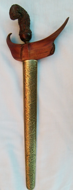

Somebody can tel me more about the mendak ?
Is this one a ''original'' madurese mendak , i never had one like this before.
imo a very simple mendak.
