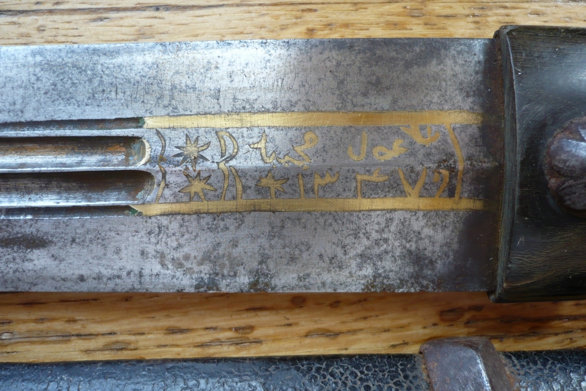

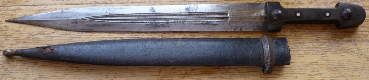

please help me with this nice blade

It Looks like there may be a date (with other characters either end and above) I see 1347 which is 1928 gregorian if it is a date.

Hi Guys,
My guess is 1327 which would be 1909 but there is a character after what might be a date and I'm not sure as to the meaning.

Hi Guys,
Norman.
LOL, at least we're both seeing it as a date
Looks like a persian/farsi '4' to me, but the character at the end is a mystery!
Best
Gene

Gene, Norman, thanks a lot! there is only year? no makers name?
I only have a chance with dates. I can try and get the rest translated, but I will have to share your photos if thats OK?

it seems only readable date on this kindjal
I'm suprised that nobody has translated it yet. Could it be that the other characters are in a more obscure language.
Have a look at Georgian and see if you can see any similarities:

Posts: 1,340
hmm these inscriptions on Kindjals are really hard to read. All i can read is the first word (right to left) and it is عمل Amal which means : work of. Even so it doesnt make full sense because its either damaged or means something else entirely since there is a space between the letter Ma and la which could be just loss to the inscription.
The 2nd word which might be a name i find it very hard to read.
The date could be 1337 if the 3rd number (left to right) has inscription loss.
Well thats three possibilities for the date now: 1327, 1337, 1347.
Do you think the language IS arabic?
Hi Lotfi
you are nearly
our point of view could be:
AMAL MAGUIB either MADE BY MAGUIB
the date is clear 1327 no doubt ...

Dont want to be the party pooper but i really doubt its Maguib.
The word is formed from the following letters : Meem Jeem ba'a ba'a (maybe Ha'a at the end)
The closest readable word i can get from this is Mujabab and it makes no sense to me.

Had a reply 'elsewhere' to the request from back a ways....
Michael came up with this:
"It reads "work of Mohamed something" and the date of 1327 which is 1948"

No way its Mohammed.
Mohammed in arabic = محمد
This word is something like مجببة
Hi,
1327 A.H. = 1909 A.D. [1327 X 0.97 + 622 = 1909 ]
Norman.

Ms Rahill over at SFI has joined the fray.
She sees the date as 1347 (as I do)
LOL, just to confuse the issue!
it's me ... who am confused
I'm bad
(because I have been able to determine that it was written ... in FARSI)
