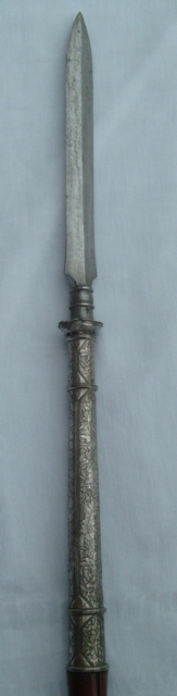

Hi guys
Today i picked up a tombak with original shaft ( shortend )
It Is brought to Holland in 1902 by Henri de Chauvigny de Blot . He was a Resident of madura . I did purchase it direct out of the familly.
Hope some one can tel me some more ?
I have another one , i will post it later .
Total length 2.25 cm.
a nice detail. the shaft is round but the last part is carved different.
Danny

Beautiful spear! It's n great condition! Wonder what a clean up of the blade would revile. Thanks for sharing! I'll be interested to see what other info other forum members will add

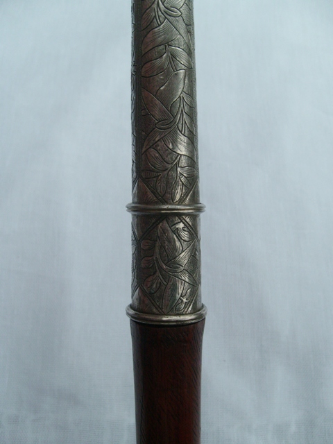

Yes, certainly needs some warangan. I look forward to seeing it stained. The ferrule (is there a traditional name for this part?) is beautiful.

for a miniature it looks quite nicely detailed. getting all that detail into less than an inch is difficult

David, if the spears were Javanese the ferrule would be called either "sopal" or "brongsong".
The butt of the spear shaft when covered with metal is called a "tunjung". The word "tunjung" actually means "lotus" and the tunjung on the end of spear shaft has a little lotus shaped metal knob on it that can be dug into the ground.
The correct terminology is "sopal", but in colloquial speech people very often call it a "brongsong".
Strictly speaking a brongsong is a case for any weapon, it is also a woven basket that we put around fruit when it is still on the tree to protect it, so it will not fall because of wind or ripeness and get damaged .

[QUOTE=A. G. Maisey]David, if the spears were Javanese the ferrule would be called either "sopal" or "brongsong".
@ Mr Maisey . So can i conclude out of the words above that the spears are not from Java ? I.m not sure by myself because the metal of the tombak is verry
dense welded , and the top of the ''bronsong'' makes me hesitate also .

Danny, the spear blade is not Javanese.
The beautiful shaft and sopal are unlike any old Javanese pieces that I have seen.

I did some search last night in the database of the RMV and it,s diffecult to see on the photo,s but i have the feeling i could be atjeh ... but stil not sure.

Danny,
Yes it loooks Atjeh or at least Sumatra.
I would not wrangan them.

Danny, I too say Sumatra.
They both share the form of the silvered one in the Kelling Hall spears I have retained and in general, the spear heads are of Sumatran/Aceh form.

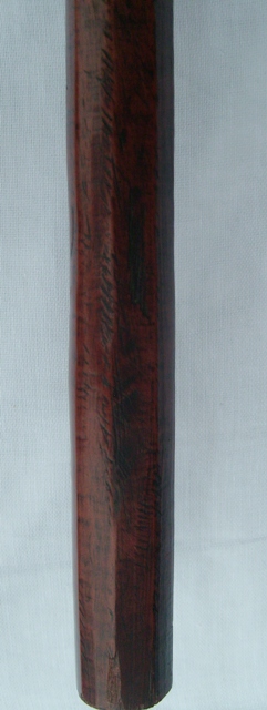

Here 2 spears I have in my collection.
The shafts are round at the bottom and nar the top the are octagonal. made from dark wood.

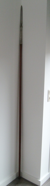

Here two fast taken pictures from a lance of my collection, probably from Atjeh. 230 cm long, end also octagonal and thicker from dark wood as well.

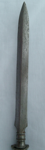

These might be Atjeh, but just the same it might be any other part of Sumatra. The ferrule is not specifically Atjeh, nor is the blade.
Blades like this one are also found on karo batak "lembing raja"
The octagonal wood might be the best indication pointing towards Atjeh at this moment
