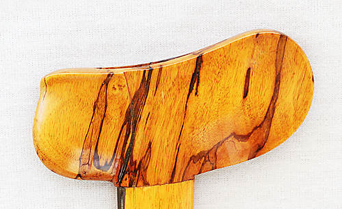

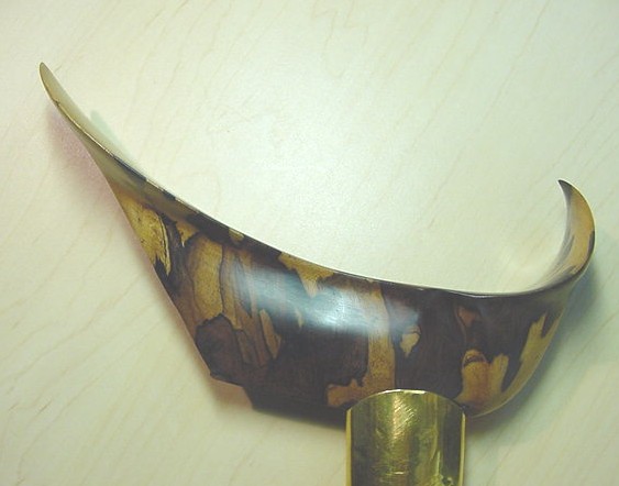

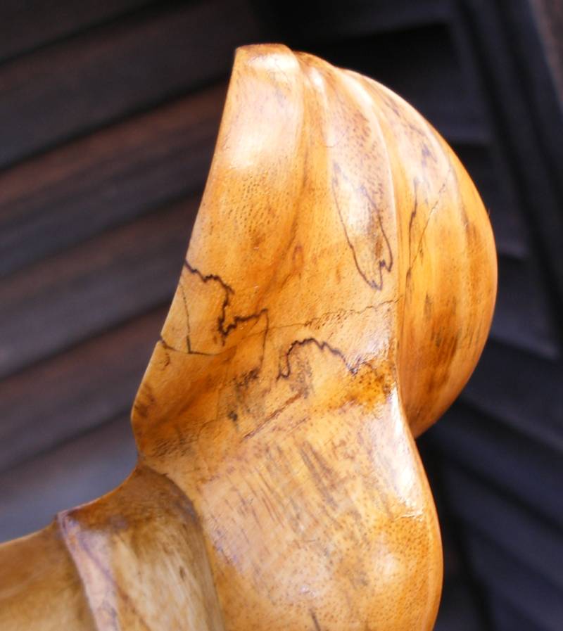

Only rarely do I let things slip from my hand .
Then they have to be fixed; this was a badly shattered wrongko.
Learn by doing ......
Old 23rd December 2006, 03:00 AM   #2
Posts: 7,299
A shame Rick, but a very clean and professional job. What kind of glue did you use?
Old 23rd December 2006, 03:10 PM   #3
Posts: 6,438
Arrow
Hi David,
Carpenter's wood glue; it dried a bit darker than I thought it would.
That end of the wrongko is all end grain carved thin so when this area hit the floor the piece literally shattered; almost impossible to get the edges lined up perfectly and miniscule pieces were just plain missing. I had to reshape the wrongko a slight amount to get it anywhere near decent looking.
The repaired area was finished with 3 pound cut orange shellac; lots of coats, lots of sanding in between.
I hope to never do such a thing again in my lifetime.

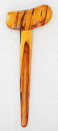

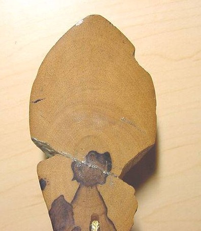

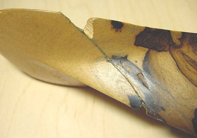

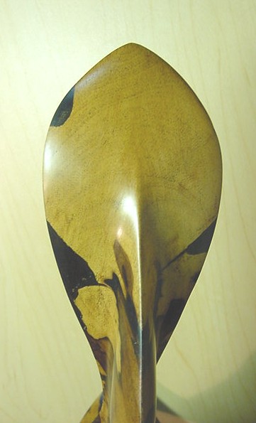

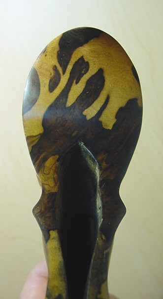

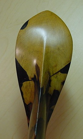

Hi Alan,
The first picture is the completed project; the other two close ups are in-progress photos.
The first few coats of shellac were wiped on then the last coat or two was applied with a brush and wooled then hand rubbed.
Brushmarks?
Me?
Never!
I'm very picky about final finish.
I hope the glue holds up.

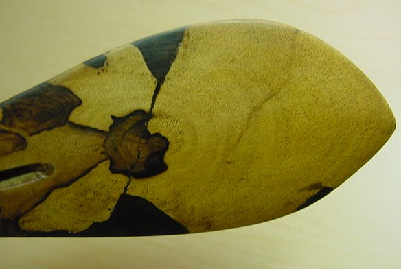

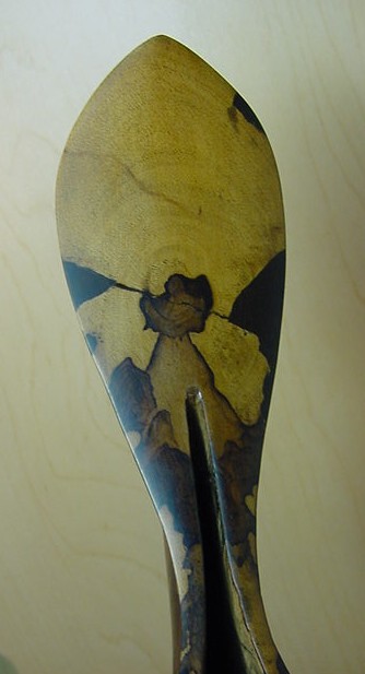

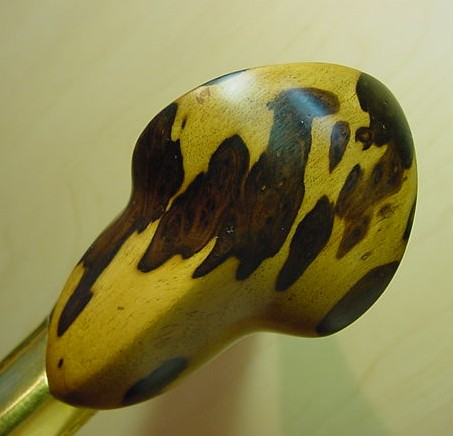

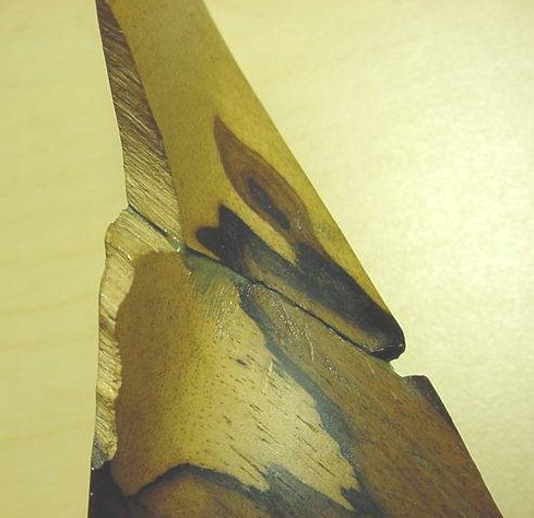

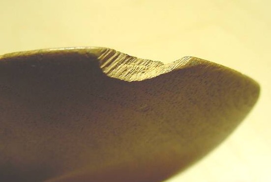

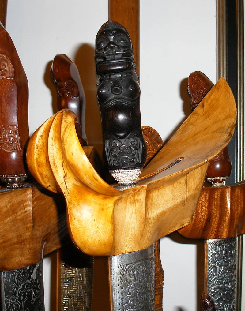

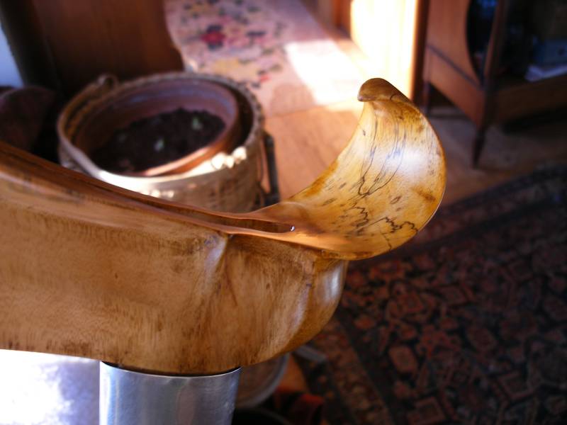

First let me complement Rick on the repair he did, it did come out just fine.
What I wanted to show other forum members, is a wrongko severely damaged that were restored by the best of the best.
I must admit that I had given up on doing anything with it, and was prepared to commision a new one, when I was told that wood of that quality is hard if not impossible to find, and that it indeed were restorable as is, to my big surprise.
I will be posting the "before" photos in this post and the "after" in a post following this one.
I also invite your comments!
The before pictures:
Naga Sasra is offline   Reply With Quote
Old 3rd January 2007, 11:14 PM   #26
Naga Sasra
Naga Sasra's Avatar
Location: Boca Raton, Florida, USA
Posts: 108
The after pictures:

Wow!!!
Boy would I love to read about some of the techniques employed in that repair.
Did you have all of the original broken pieces?
Thanks for posting those wonderful pics.
Jason Anstey is offline   Reply With Quote
Old 4th January 2007, 02:13 AM   #30
Alam Shah
Alam Shah's Avatar
Join Date: Jan 2005
Location: Singapore
Posts: 1,248
Originally Posted by Jason Anstey
... Did you have all of the original broken pieces?
I think there are missing chunks. The good think about timoho or pelet is that, repairs can be camouflaged to a certain extent.
Lovely before and after photos. Thanks for sharing.
Naga Sasra, what was used to fill the missing chunks?
