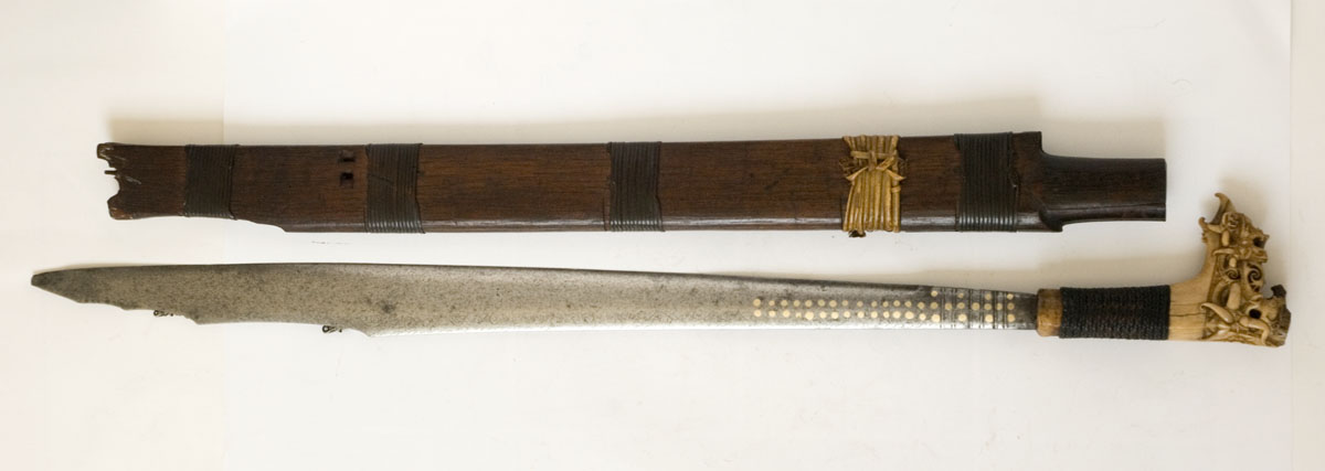

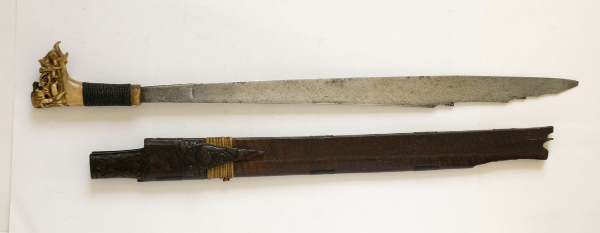

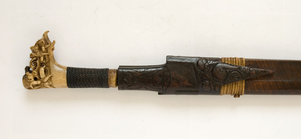

I have bought finally my first Mandau It has a thick and massive convex/concave blade decorated with brass points and ornaments. I do not know a lot about these fascinating swords – any comments?

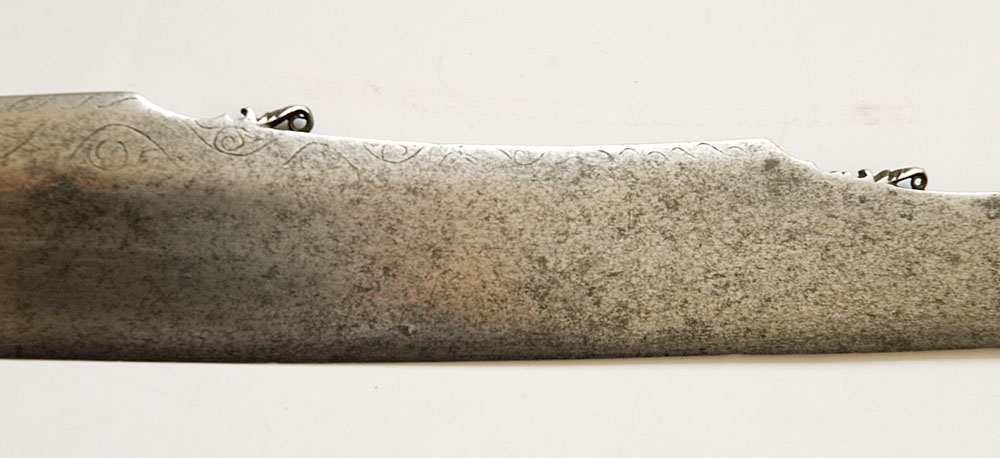

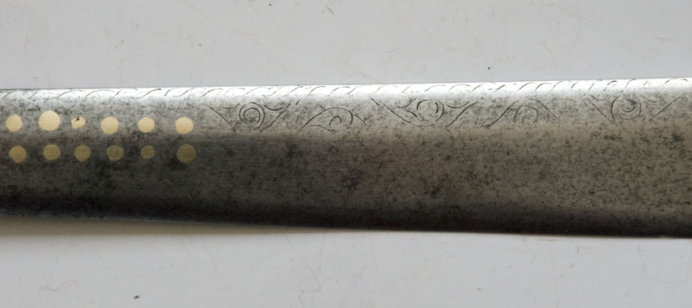

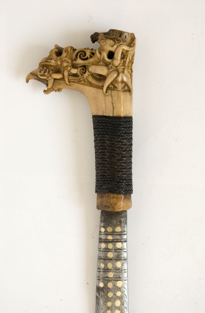

Blade details:

Beautifull handle !
+ blade and scabbard btw. nice one
Old 28th May 2011, 01:43 AM   #4
Posts: 7,417
Yes nice piece. Quality carving.

Hi Tatjana,
congrats! what I like in special is that nice ornament on the back of the handle.
a mandau from the Mendalam river area from last half 19 th century most likely.
you recognise them on the use of the "gearwheel"
Arjan.

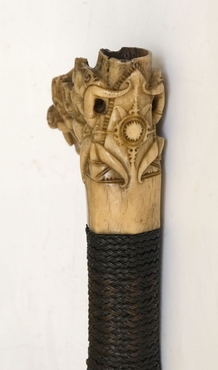

Congrats Tatyana!
Beautifull old piece, and as Arjan stated allready, I also like the beautifully carved handle, especially the backside...
Could you please post a close up from the handle seen from above?

Thank you all for the kind comments and telling the origin and age!
Maurice: I haven't made any pictures of the handle from the top, because there are no carvings there, only the bare old grey antler core But if you still need it, please let me know, I will make it tomorrow.

Tatyana, not necessarily.
I only was a bit curious where the broken piece would be attached...

The carving at the back is indeed very elaborate and extraordinairy.
I like this type of handle a lot. Unfortuately I did not bump into one that was either well carved enough or affordable

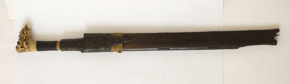

Hello Tatjana, to my oppinion your mandau comes from the Kenya subgroup of Dayak near the border of Sarawak. It are the Kenya who generally use this type (form) of handle and always tend to have a 'busy' decoration with lots of scrolls (the Kajan in comparisson have a more archaïc style of decorating) and the use of the protuding 'points' , which are actually depicting leaches, is more used by the Iban subgroup in Sarawak. Hence my conclusion.
Unfortunately I dont have my map of subgroup locations in Borneo not at hand. So perhaps it would be the upper Mendalam river like Arjan said before indeed or the upper (far inland) Mahakam/Kajan river?
I believe in the book 'hornbills and dragons' there is a map.
Very old blade also. Possibly even older than the handle and scabbard. The very old and best (?) quality blades where called 'mantikei' by the Dayak as they were made by the Ngaju subgroup in South Borneo (slightly up the Baritoriver) in a village called Mantikei. Native iron was used for those blades and even iron from meteorites -according to sayings- was used.
I have had one of those older native iron blades myself and indeed this iron is of the best quality and has more a silver shine in stead of the more common blades who have more nickel in them with a more yellowish shine (in comparisson).
Hope this is of help,

[QUOTE=Indianajones]Hello Tatjana, to my oppinion your mandau comes from the Kenya subgroup of Dayak near the border of Sarawak. It are the Kenya who generally use this type (form) of handle and always tend to have a 'busy' decoration with lots of scrolls (the Kajan in comparisson have a more archaïc style of decorating) and the use of the protuding 'points' , which are actually depicting leaches, is more used by the Iban subgroup in Sarawak. Hence my conclusion.
sorry to add a correction but the style of the handle is surely Kajan ( not Kenya)
examples of this type can be seen in "In Centraal Borneo "by Nieuwenhuis
also the scabbard is typical Mendalam Kajan style, loose Kajan scabbards in this style are also illustrated in "In Centraal Borneo" those where freshly carved during the stay of Nieuwenhuis so we can be quite sure that this design is indeed Mendalam Kajan.
Kenya handles are mostly of a whole different style but the main difference is that a Kenya is mostly " filling spaces with scrolls,dragon and leech motifs"
The Kayan style is somewhat more developped with more arms,eyes etc.
its typical however that it seems that the eyes carved by Medalam Kajan does have teeth what make them look like gearwheels.
Arjan
