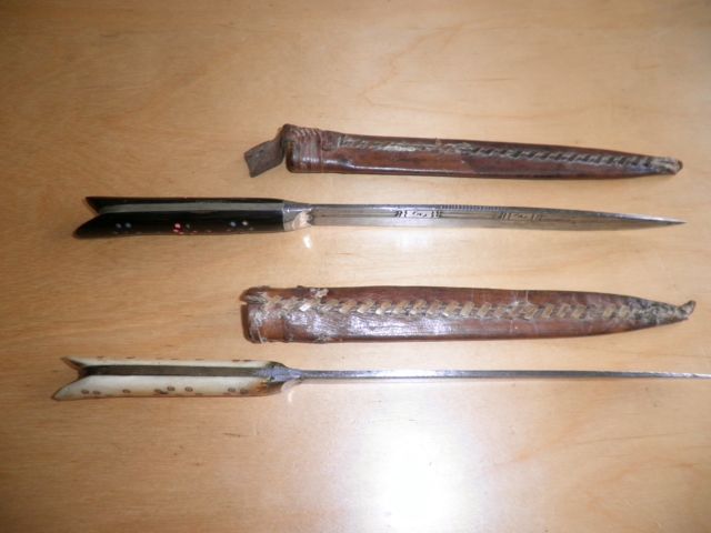

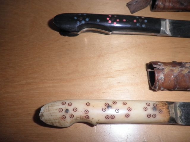

Someone can help me ? What are the origine of its bichaq? are its greek?
Length: 31 cm
Thanks for advance

The fullering, the hilr shape and the hilt decoration all look Turkish to me. Pinpointing it to a specific area is hard, but my best guess would be Bursa.

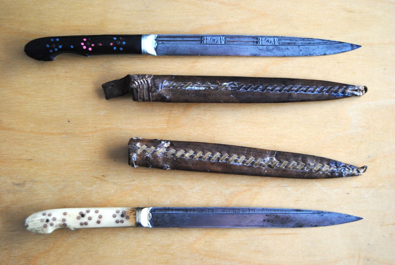

Posts: 3,191

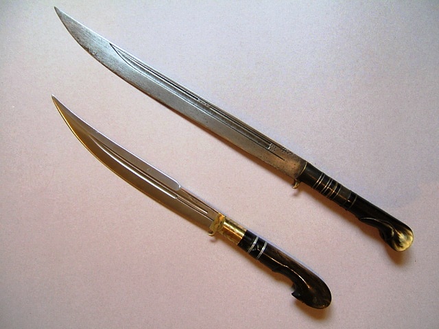

They both seem to be from Trabzon compare them to the two pictured below which are older examples.

Lew, looks pretty spot on for ID on these. When I first saw these, I began thinking of the Cretan daggers, but as I do not have that book with me I really couldnt place. What are the distinctions on the Cretan daggers? It seems like they also have the splayed pommel, but again cannot recall for sure.

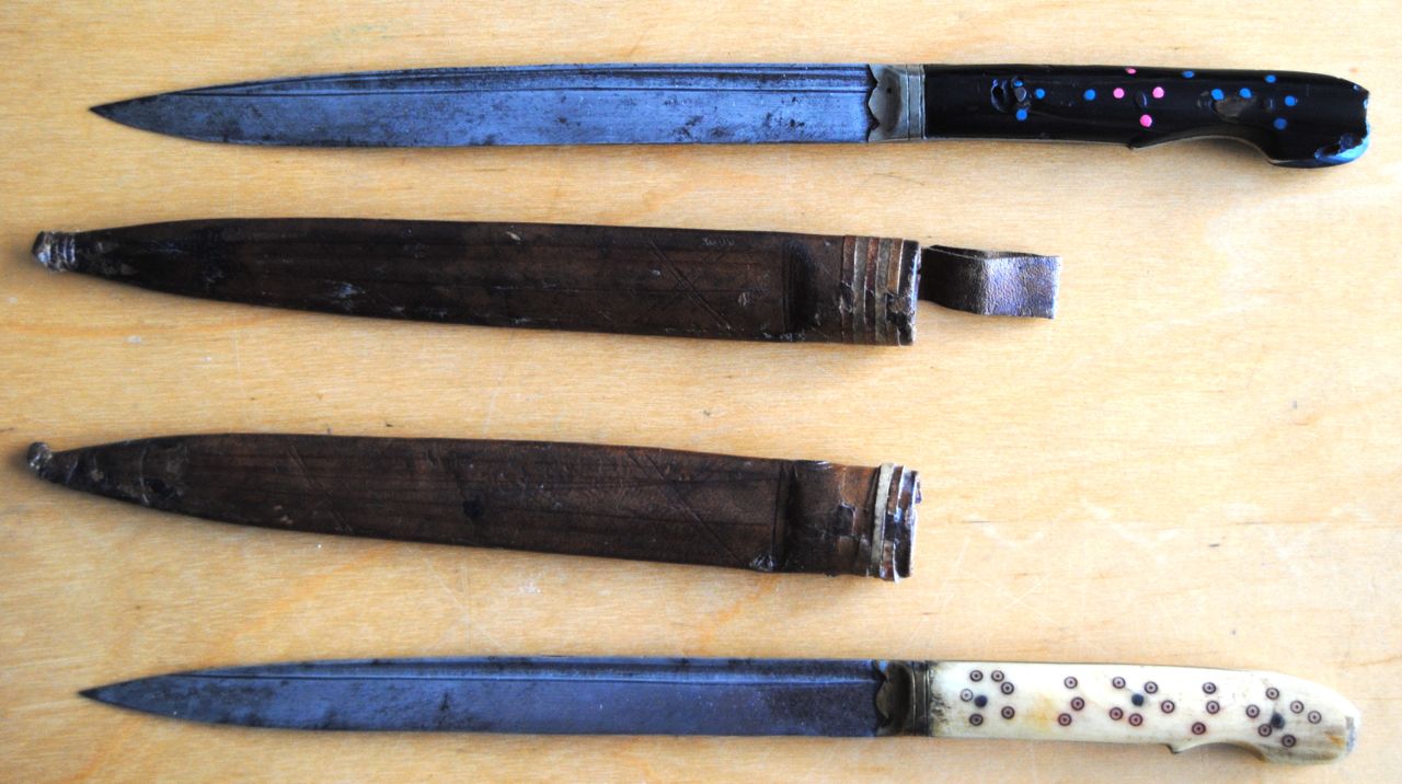

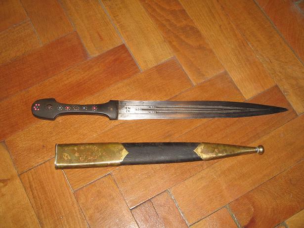

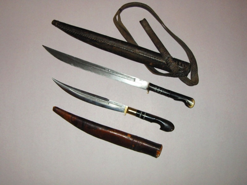

I personally do not think they are from Trabzon - the spliced pommel was popular throughout Turkey and even in the Balkans. I am attaching two mid 20th century knives from North-Western Bulgaria with a spliced pommel and a kama with similar hilt decoration and blade markings, also found in Bulgaria. This is why pinpointing a specific place of origin in Turkey is hard.

They look Bosnian to me. My only doubt is the sheaths that look like some of the daggers I have from central Asia.
