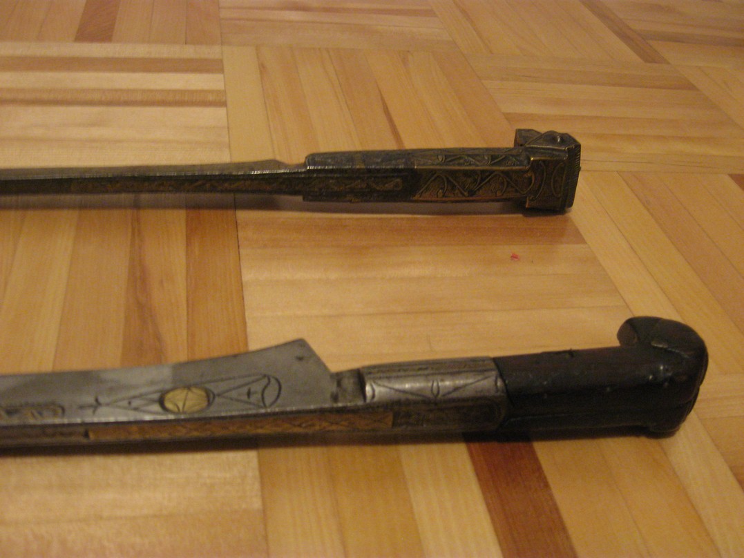

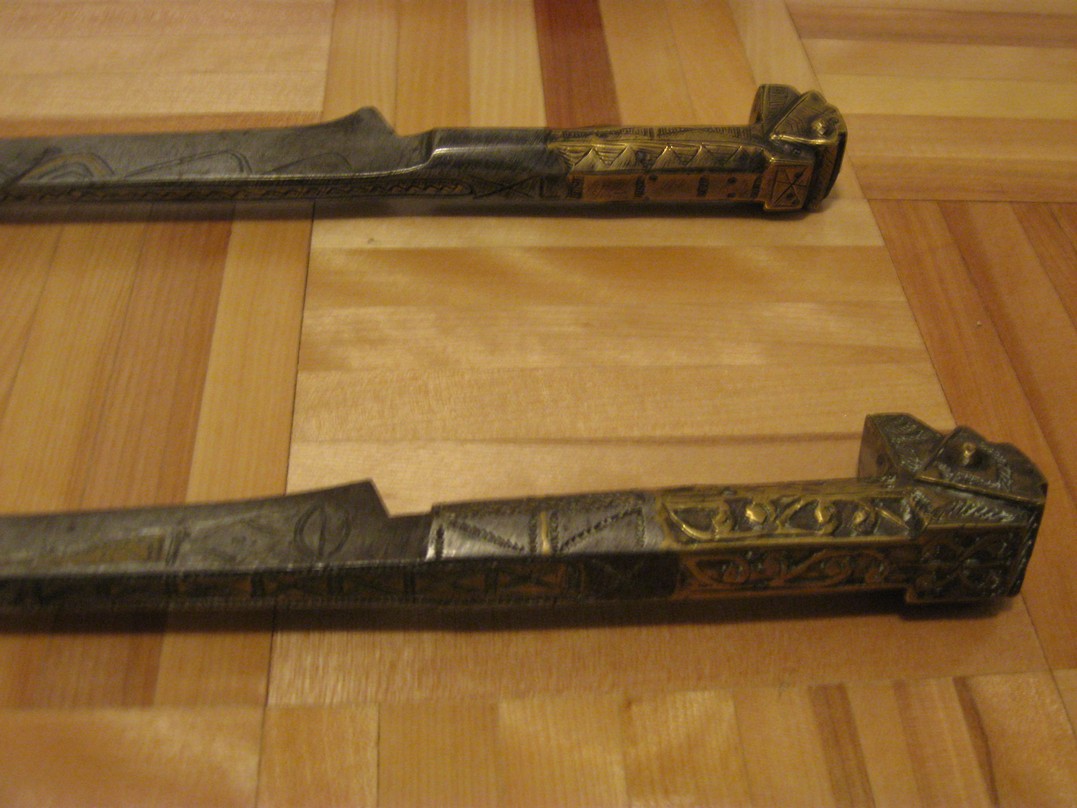

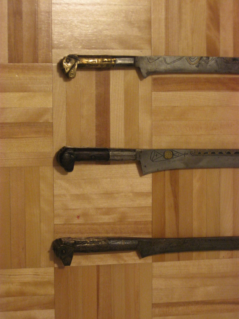

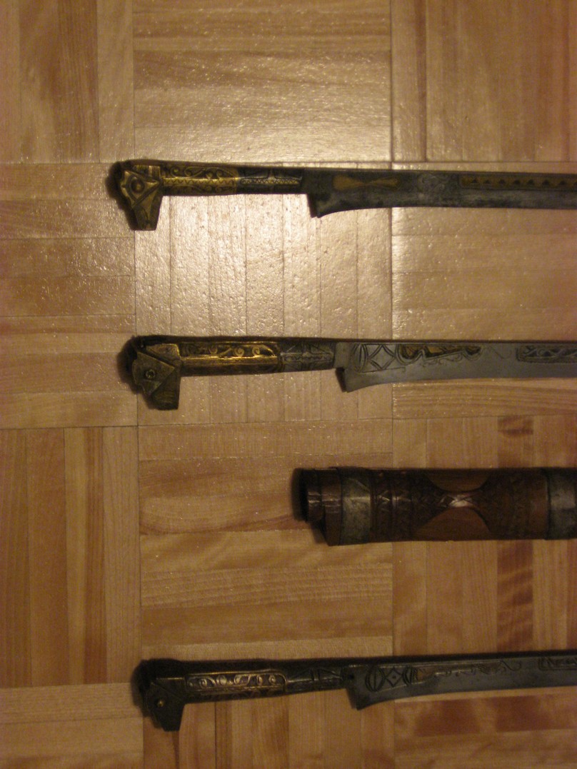

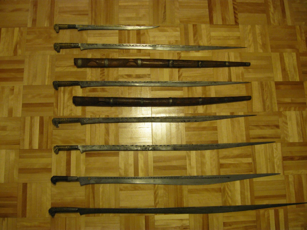

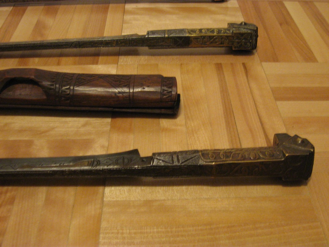

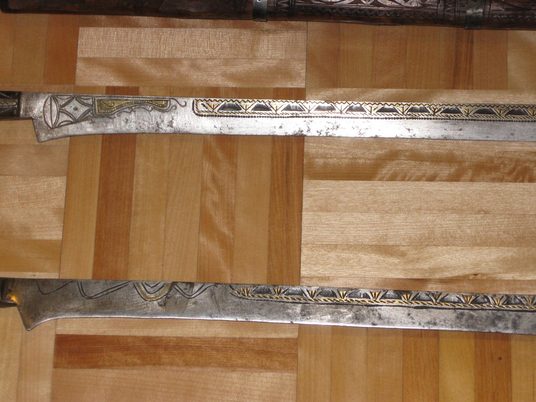

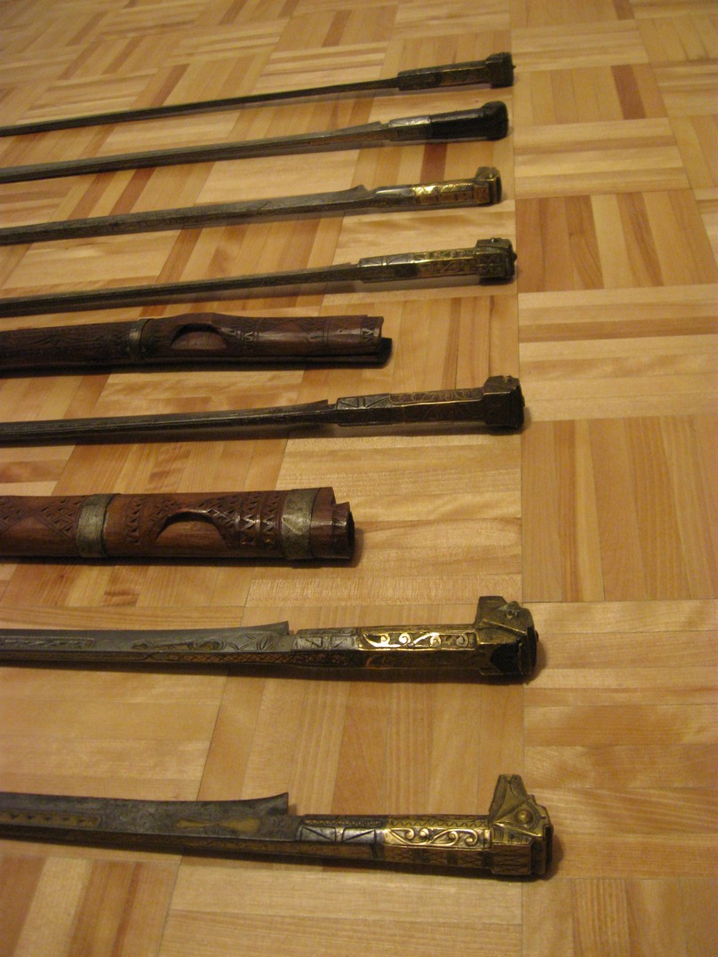

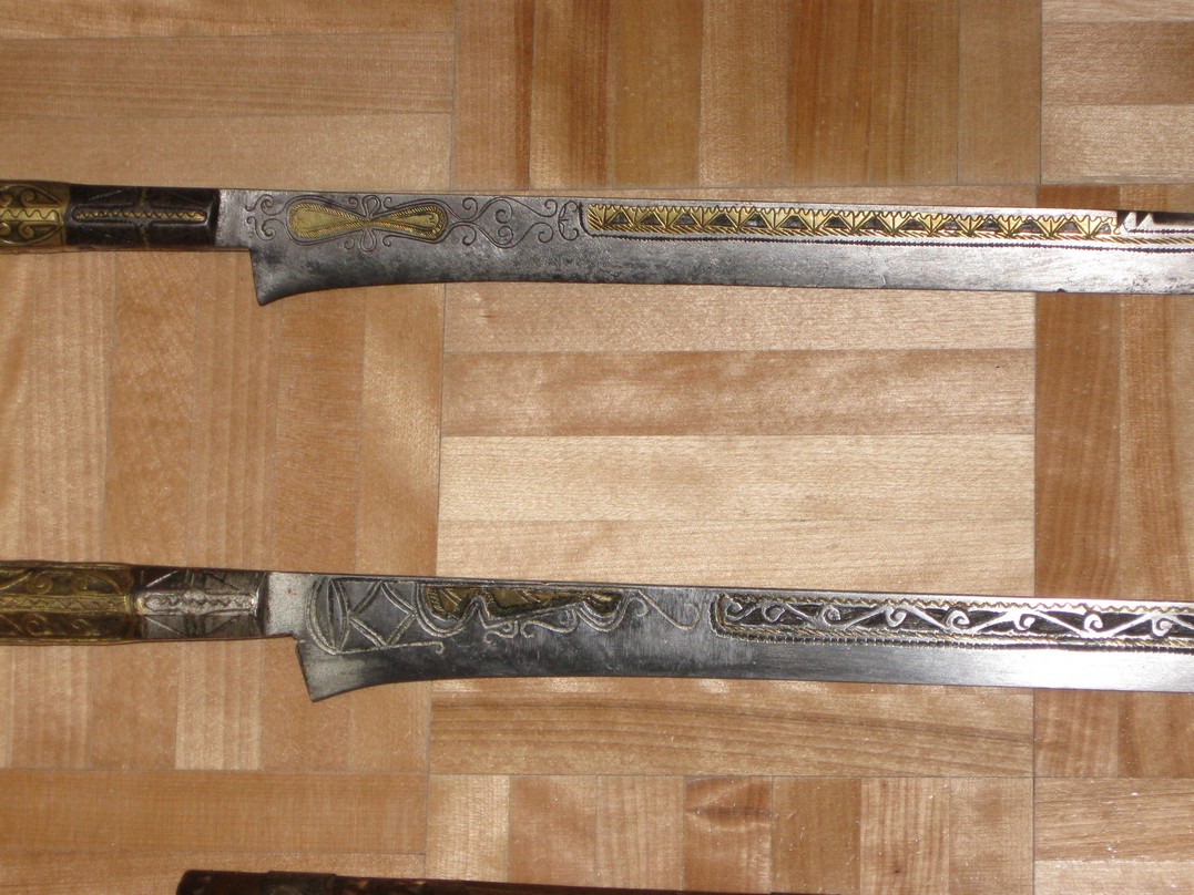

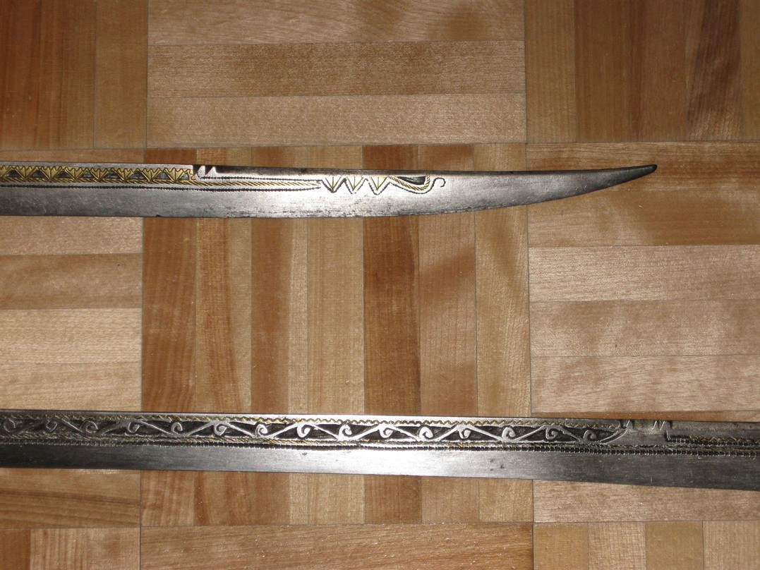

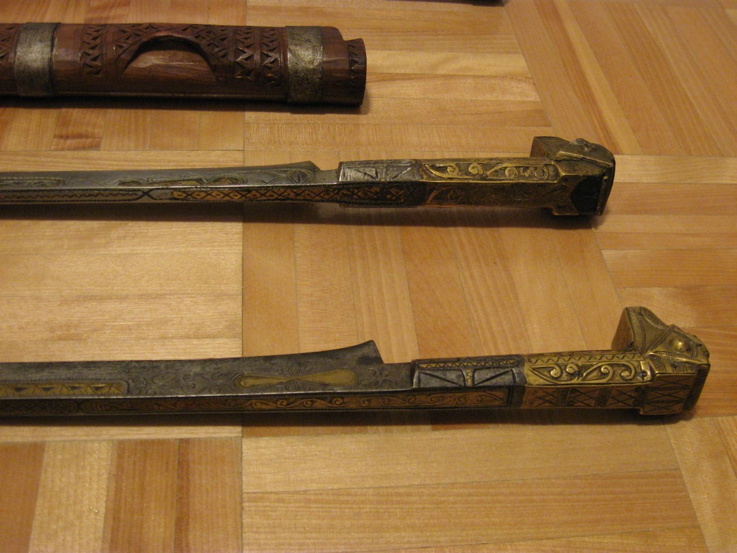

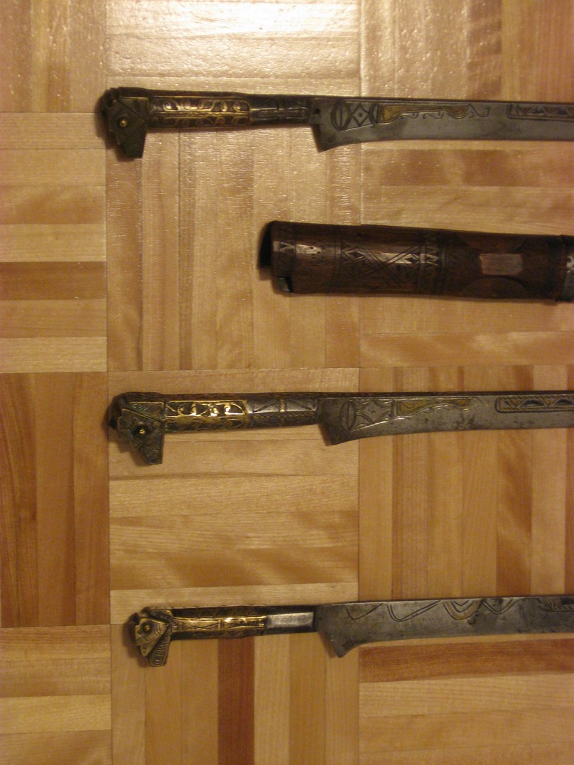

Hello everyone,
I thought I'd throw some flyssa up on the forum since I haven't seen any new ones in a while. The smallest at the top is 16" overall, the longest at the bottom is 46" overall. Lots of variety, no two are alike. The longest is VERY heavy, makes the 36" regular long ones feel light as a feather.
Emanuel

Spines range from 8mm-12mm.

Fantastic collection! Thanks for posting it, I really like group views, helps to illustrate the variety in a given type.
The longest one seems particularly old? Or maybe just the darker patina is fooling me.
Are there good period photos with Kabyle carrying these (postcards maybe)?

My understanding is that flyssas were designed for slashing. But the long ones are almost impossible to wield in any way, except for using them as a lance. Am I right?

It's the balance that I find problematic, not the weight. Very slow recovery from traditional fencing techniques. In estoc the balance is problematic again, you need strong arms to hold the flyssa in a lunge for any length of time. I have some ideas about wielding these more effectively in slashing but I'll need some confirmation.
No actual photos Iain, just a drawing of a "Guerrier Kabyle" in Armes Africaines I think. It's been reproduced here on the forum before.
