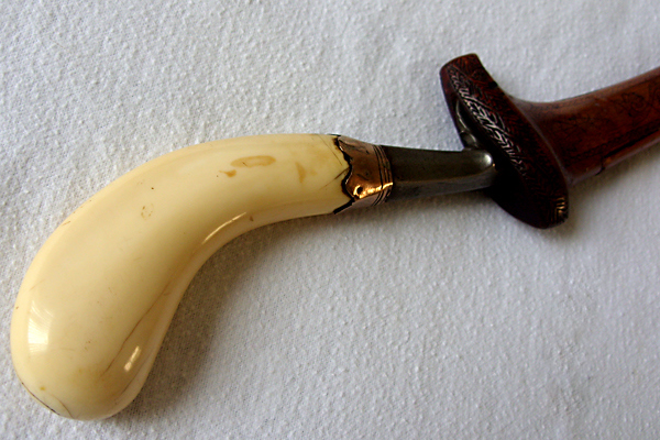

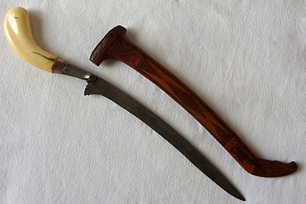

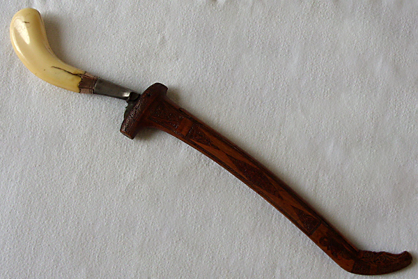

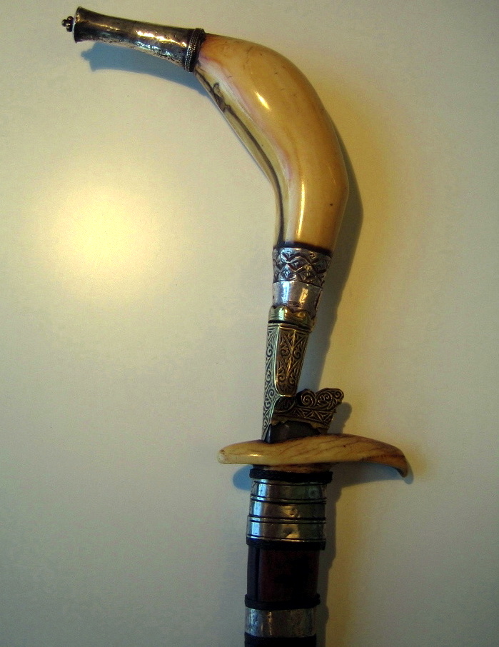

Here is one of my latest gain.
Does anybody knows what area this one could be?
Atjeh? Gajo? It seems to be hard because the appearance of this one isn't clearly Atjeh or clearly Gajo!

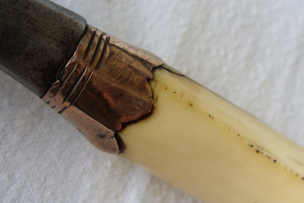

The handle is hippo ivory with a suassa ferrule.
Thanks in advance!
Maurice
Old 16th June 2010, 05:22 PM   #2
Maurice
Maurice's Avatar
Join Date: Jan 2007
Posts: 1,464
Oh, the scabbard by the way is not the original one, but fits perfect!

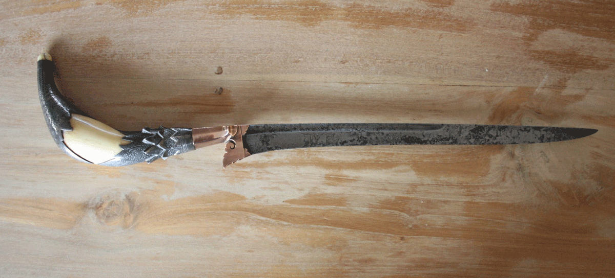

hi maurice
Do I have almost the same! have no idea where it comes from.

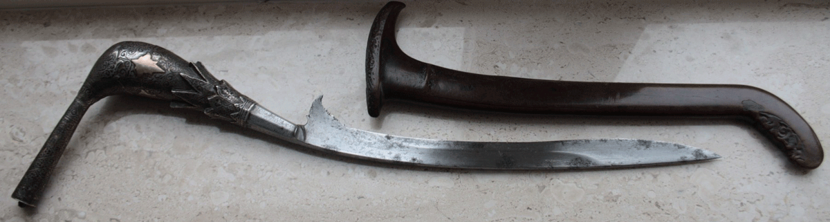

I've got one too Maurice, it came with the Kelling Hall collection;
http://www.swordsantiqueweapons.com/s182_full.html
I look forward to hearing what the Sumatran experts say but my feeling is Atjeh based on the majority of the Collection only.
You are certainly putting together a nice collection.
Gav
Old 17th June 2010, 08:57 AM   #6
Nice one, Maurice!
All 3 examples seem to be hulu puntung variations.
Gavin's piece almost resembles the hulu dandan style. Blade is apparently heavily worn - tough to place this one; the nice scabbard looks fairly typical and I'd guess it's from Aceh if none of the inked motifs suggests otherwise.
Christoph's piece looks odd and the scabbard seems to be a later replacement. I'd really like to see this blade cleaned and lightly stained to bring out the laminations - if it's really antique, I'd believe that the rather stubby blade shape might suggest a Gayo origin. The hilt is also odd but doesn't look like one of those recent oddities fabricated on Java/Madura/Bali...
Maurice's piece is obviously antique and unique. While a status piece, I believe it's original owner was not too affluent: the workmanship of the suasa ferrule is pretty basic and IMHO the hilt suggests that the shape was influenced by the (limited) chunk of ivory available to the craftsman. Thus, I'm not sure we can glean much on it's origin from these features except that it probably doesn't came from any center of power. However, the scabbard this piece had with it is one of the most flaboyant wooden examples I've seen! If really original to this rencong it might indeed point to a Gayo origin...

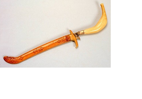

Maybe Erik can post some pics of the scabbard here?
Old 17th June 2010, 09:26 PM   #7
erikscollectables
erikscollectables's Avatar
Join Date: Nov 2008
Posts: 318
Hi Kai/Maurice,
Most Gayo scabbards I know are different from this one and the one I have.
Most often dark wood ipo the typical light wood of Aceh and in cases of an ivory handle also the top of the sheath is often made of ivory (like on some sikin in another region).
Here is a picture of the sheath Kai mentions.
Sheaths are constantly traded and exchanged it seems - this happens now but also happened in the past. So to a certain extend you never know how original a scabbard is to the knife with these
Originally Posted by kai
Nice one, Maurice!

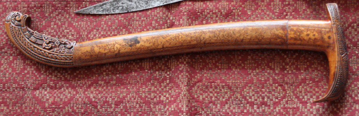

Here 2 pictures of men wearing a rencong.
Nr 1 being mentioned as gayo, nr 2 said to be Atjeh and being carrier different. with the crosspiece sticking upwards.
Nr, 3 is an example in het "wereldmuseum" in Rotterdam.

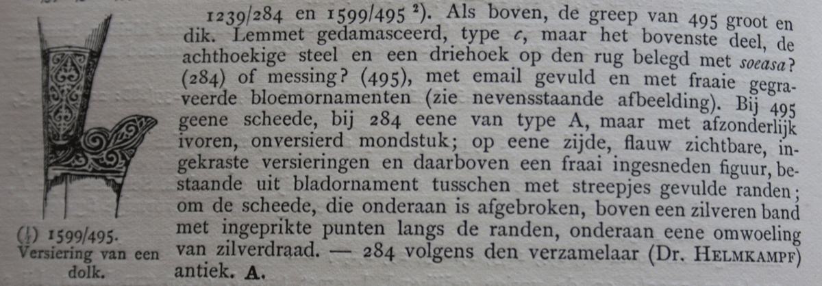

And a description of a very similair one in the Leiden collection catalogue
