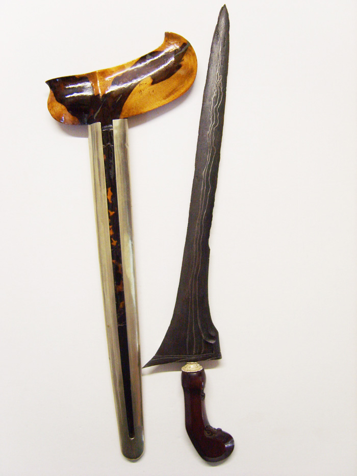

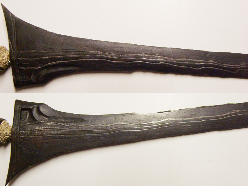

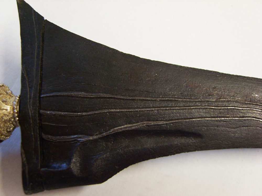

I want to share this keris with you, because not often seen on the forum pamor: Tejo kinurung . ( sheath inlaid with turtle shell )
but 'm still looking for the right dapur.

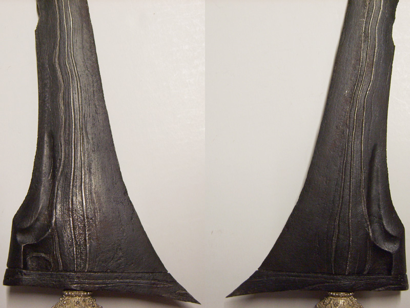

Tikel-Alis is short, deep and with a sharp bend
can anyone define the dapur?
I appreciate any and all comments,

Posts: 7,255
Tilam upih.
This is a dhapur about which there seems to be universal agreement, I have not yet seen any pakem that gives a keris with these features a different name, nor that identifies dhapur tilam upih with different characteristics.

Yes, a very typically tilamupih. And the naming of pamor, it seems more "adeg tiga" (illustration below, from Hadiwidjaja's copy) than "teja kinurung". Three lines, almost paralel in the middle of the blade is called "adeg tiga". But "teja kinurung" is only one line in the middle ("sada sak-ler"), surrounded by "tepen pamor" or line along the both sharp sides of the blade...

I agree with you Pak Ganja.
I'd call it adeg tiga too.
But I try to avoid playing the name game with pamor in particular, because as sure as I say its one thing, somebody else will tell me its something else or that his grandfather used to call it such & such.
You and I both know just how contentious this name business can be, and this Forum is tending more towards a classification resource every day, rather than a discussion group with an interest in some of the deeper aspects of the keris.
In fact, I'd be more than happy if somebody called this pamor "three upright stripes".

A big difference of course is: growing up in a culture where the dagger is a part of cultural heritage, or someone who is interested and becomes a keris-collector on the other side of the world.
And in my opinion the language is the biggest problem, when I look for information, I first look in books written in my own language.
Like my believe that this is pamor Tejo-Kinurung.
I've looked in the book "The kris part 2” of Tammens page:138-139
( I know that these books are not always give the right information)
But this is what Tammens wrote:
Tejo Kinurung: “Three times lightning”
Not a general pamor motif, but certainly quite impressive.
At first glance it resembles a kekumus in a wengkon, but this is not
correct. The empu deliberately placed both outer lines more towards
the middle, so it cannot possibly be classified as wengkon.
So that was my guide to come to the conclusion that it was:
pamor Tejo-Kinurung. And therefore a comment given by someone with a different perspective on things is so appreciated. (not only by me!)
So thank you all for doing this..
and I'm now convinced that it is indeed pamor: Adeg-Tiga

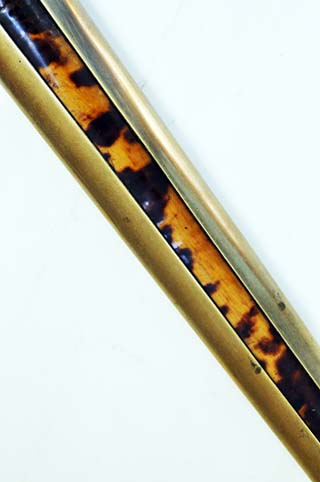

I just want to know what is the thing with turtle shell? Is it a common stuff for decoration, like using whale ivory for a hilt, or are there some other meaning to it?
I don't happen to hear this so often, at least not in my country...

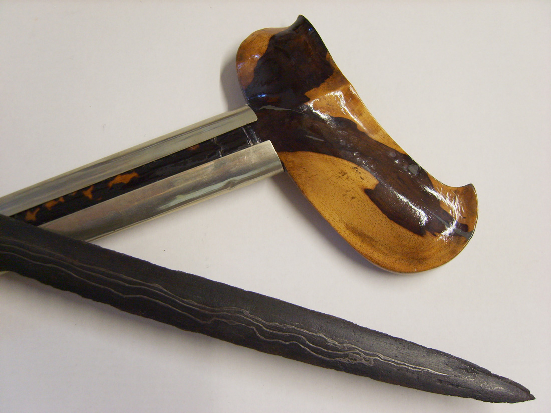

Yes, it was in the past, before javanese people knew plastic thing. I remember, my late grand mother in Kusumayudan (traditional residence -- now a hotel, Prince Kusumayudan or Kusuma Sahid Prince Hotel in Solo) used to wear hair bun or chignon made of real turtle shell. It was used for keris ornaments too, usually for decorating the gap of "blewahan" pendhok. Practical intention, only. No certain spiritual or intangible meaning of it, IMHO...
GANJAWULUNG

Old 4th May 2010, 04:16 AM   #17
Posts: 7,303
Originally Posted by ganjawulung
I agree, it will be too complicated to explain this.
On the contrary, i believe that you and Alan are explaining it quite well.
Old 4th May 2010, 04:23 AM   #18
Posts: 7,303
Yes, as Ganja has mentioned it is a decorative material often used just as it is on your keris. I consider it a higher end material when on sheaths, not to the extent of ivory though, but nice. Just as ivory and horn don't seem to hold any particular spiritual significance in this usage i also don't think turtle shell is anything but decorative.

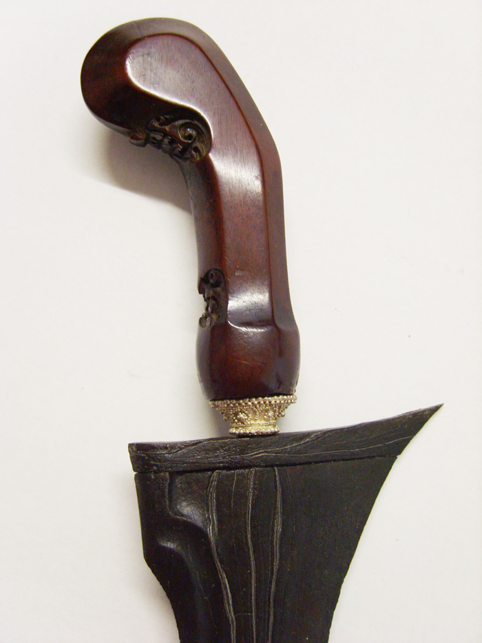

As far as I can find the description of this pamor:
(according to the book: Pamoratlas written by :
Ing. E.A.N v. Veenendaal, private publication in Dutch)
it is also described that in different places different names are used for the pamor Tejo-Kinurung:
South central Java- Adeg-Wenkon
Surakarta - Adeg-Tiga
East Java - Adeg-Telunger (Three upright Lines)
The description of the pamor (according to the book):
Some collectors believe the magic of this pamor lies in the field of leadership authority and prestige,
making it especially suitable for people who work for the State.
And it is good for health and protection of the owner and his family.
I would describe the main differences:
Dhapur Brojol has only a Pejetan and Dhapur Tilam Upih has a Pejetan and
one Tikel Alis and Tilam Sari has a Pejetan one Tikel Alis and on the Greneng
one or two Thingil.
sirek is offline   Reply With Quote

Old 5th May 2010, 02:51 PM   #22
Posts: 7,255
Adeg tiga (adeg telu, tri adeg) and tejo kinurung are all essentially the same pamor, the difference, if there is one at all, between adeg tiga and tejo kinurung is only in the spacing of the lines of pamor, but those lines of pamor are made in the same way with multi folds of pamor set between heavier layers of iron, and turned side on to produce a pamor miring motif with the three lines of pamor at 90 degrees to the core.
However, adeg wengkon is a completely different pamor to these and it is one of the most difficult pamors to make well. Adeg wengkon consists of a layer of (usually) unfolded pamor material laid against the core, and then the iron with one centrally placed strip of pamor miring laid over the core + pamor layer. Repeated both sides of blade. The result is the wengkon as mlumah, and the single adeg as miring.
I cannot emphasise too strongly how difficult it is to produce a good adeg wengkon --- it appears to be simple, but it is very far from that.
In olden times the Susuhunan of Surakarta would usually give a keris with adeg wengkon to newly appointed bupatis. This was symbolic of the bupati's duty of care to the people for whom he was responsible. The wengkon was the protective power of the bupati, the line of adeg was symbolic of his people.

Old 6th May 2010, 10:30 AM   #28
Moshah
Moshah's Avatar
Join Date: Oct 2009
Posts: 171
GANJAWULUNG
Thanks for the explanation.
I ought to suspect it is somewhat serve the same function as ivory on keris, but I compelled to ask because I see turtle shell usage is less often than ivory, in keris busana.
Moshah is offline   Reply With Quote
Old 7th May 2010, 05:37 AM   #29
ganjawulung
ganjawulung's Avatar
Join Date: May 2007
Location: J a k a r t a
Posts: 991
Yes Moshah,
Less usage than ivory. In the old days, in decoration assesories some times we found bracelet, ring and neclace made of turtle shell... Even guitar picker
GANJAWULUNG
