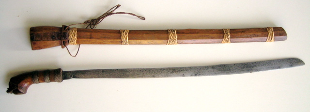

OK,

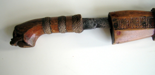

I'd be interested in seeing close-ups of the hilt. The pommel looks very Visayan in flavor...Cebuano in particular .

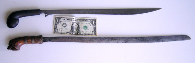

The Moro/Sumatran/Visayan/Peninsular sword has arrived.
Unfortunately it's dark here now but I hope that the enclosed pictures could be of some use.
I am still puzzled on what it could be.
I haven't had time yet to check all references but what's significant is the narrow blade.
For Ian, as well as a comparison, I have put it next to a regular sized Batak Kalasan as well as an US dollar bill.
Considering the size and weight it feels closer to a Kalasan than a Visayan or Moro sword?
Please look at the blade close to the hilt. That part reminds me of a Visayan feature?
I have a very thin Tenegre in my collection but it's still much heavier than this sword.
And the seller described it as a bringback from a "WW2 Pacific Theater Veteran" (=Philippines?).
So is it Visayan (a slim binangon?), a Batak Katungung or something else???

It looks like it s from borneo from the muruts the scabbard looks like it s made
in Sarawak not Sumatra

Actually W also thought the hilt looked Borneo.
But why is it so light and small (compared to f.i. a Pakayun)?

Doesn't look Murut to me, IMO. However, these indigenous people are found in Northern Sarawak and Kalimantan as well.

Hi I can send pics off murut swords with this handle if you want
but if you look in the book off Wilhelm Hein Indonesische Swertgriffe
page 343 you can see it
