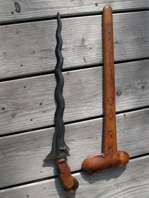

Hello folks,

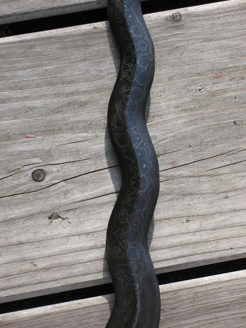

I managed to pick up this Bali keris pure on esthetics and personal taste.
Now I would like to check a few things.
- It looks original stain to me. am I right ?
- there are some markings on the ganja. the seem deliberate to me.
Do they have a meaning or purpose.
- Is there any indication on age ?
Thanks for any input,
Willem

Yes, looks like original Balinese warangan treatment to me, too.

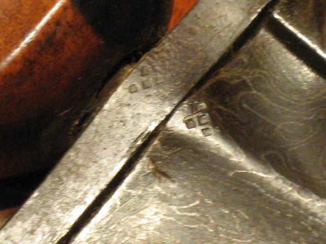

I don't doubt that the blade is antique. The long part of the ganja looks a bit shortened.

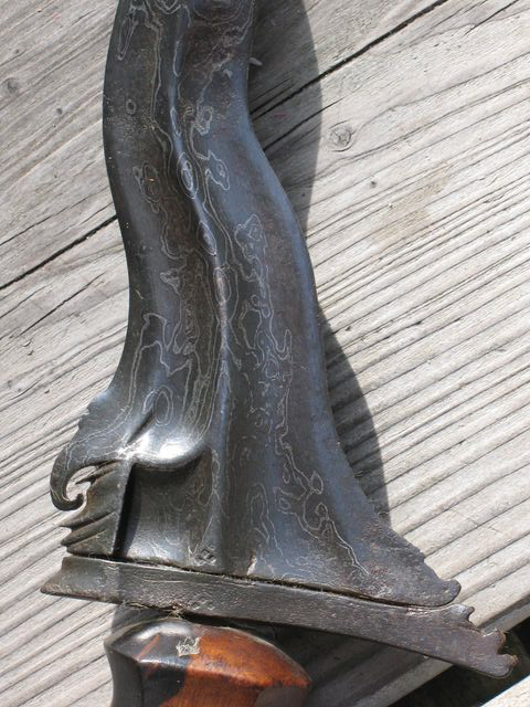

Have you a close-up of those 2 triple marks close to the pesi? Are these also present on the other side of the blade? The marks on top of the ganja are even more weird... Congrats - nice acquisition!

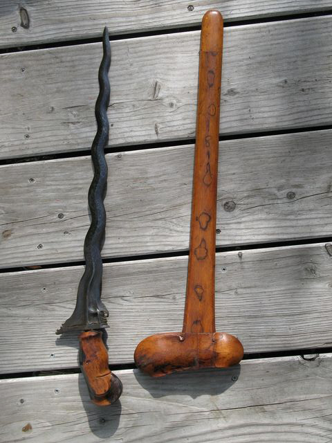

BTW, the tip of the scabbard looks like a later repair to me.

I will try to make some better pictures of the triple markings.
To be honest, I noticed them only on the pictures after I posted them.

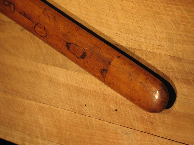

The scabbard tip looks original to me.
The very subtle wood on the front is an inlay, so that is why it ends in a straight line at the bottom.

When was the last time blades were actually made on Bali 1950s-70? blade could be early to mid 20th century. Anyway it's real nice.

I also think this is an old Bali blade, probably 19th century, with an old Bali stain. The tip of the scabbard doesn't look like a repair to me. It is very common for there to be a nice piece of patterned wood inlaid into to front of the stem like this.
I agree that the gonjo looks a bit short, though i cannot tell from the photos if it has been shortened or just made this way. The markings are unusual and very interesting and i would think most definitely intentional. No clue as to way though.

The tip of the scabbard has not been repaired, this style is common.
The gonjo has been damaged and shortened.
The marks in the top of the gonjo may be bekas kinatah --- places where kinatah work was. Cannot say with certainty from a photo, but it looks like it.
That makes sense. What do you think about the 3-diamond pattern on the side of the gonjo and the base of the blade. Also a kinatah anchor?
Old 29th June 2010, 01:51 PM   #9
Posts: 7,255

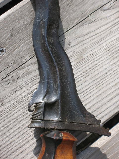

I do not know of a kinatah pattern that would use this.

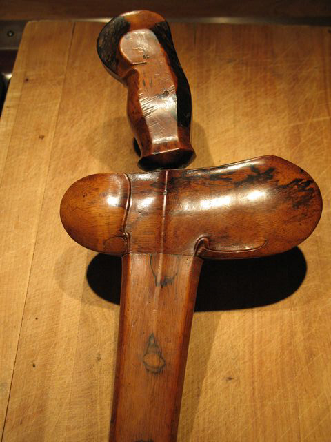

I'd need to look at it under magnification to form a supportable opinion, but my impression is that it is the result of gripping with something like vicegrips to hold the gonjo in correct alignment while fitting a new key --- or maybe just aralditing.

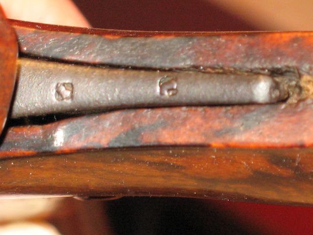

It seems, buntut of gonjo is broken where the third hole was situated (or fourth, if there should be one on sirah cecak side).
Old 30th June 2010, 03:41 PM   #11
asomotif
asomotif's Avatar
Join Date: Nov 2006
Posts: 2,238
Thanks all for your input and info.
Gustav, yes there is a fourth Kinatah (see pic 1)
Allan, why are you so often right ?
Closer inspecition indeed looks like grip marks on the blade (see pic 2)
Willem

I agree: vice marks.
