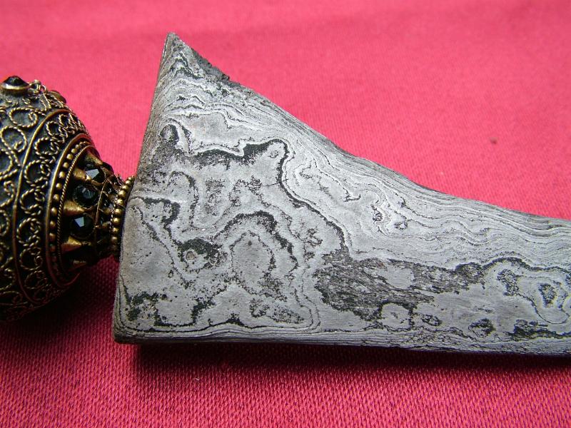

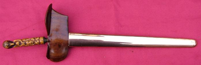

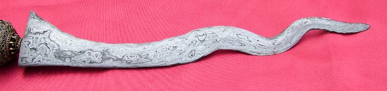

this is the last one that I buy this week the dapur is cengkrong
regards semar

I am sure I am showing my ignorance here but to me this looks like a rehilted tombak. I cannot see evidence of a fuller, gonjo or gonjo iras. One thing that makes me pause is that the pesi is not central which may be a little odd for a tombak.
What makes it a cengkrong Semar?
regards
Drd

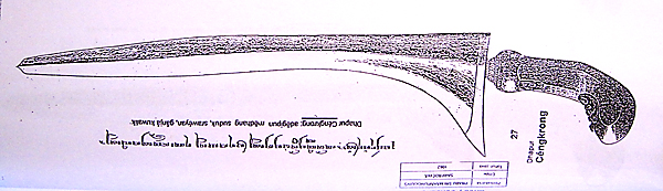

Dhapur Cengkrong.

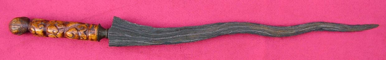

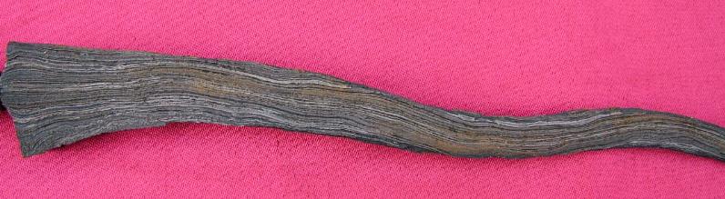

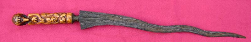

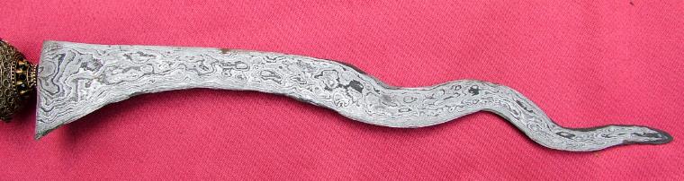

hello mister maisey you know that my engels is not so good bud I think thats a keris and not a tombak you send a picteur of a dapur cengkrong oke look to my other picteur its look not like yours but its also a dapur cengkrong ??????????
regards semar

Het was niet David die je een foto laat zien van een dapur Cengkrong, maar Alan Maisey.
Gentlemen for your information the translation of this dutch text: It wasn't David who showed you the picture of the dapur Cengkrong but Alan Maisey.

Semar,
The first piece which you called Dapur Cengkrong in error, is listed in the Keris Pakem as a Dhapur Cundrik Pandawa (luk 5)
Erik
