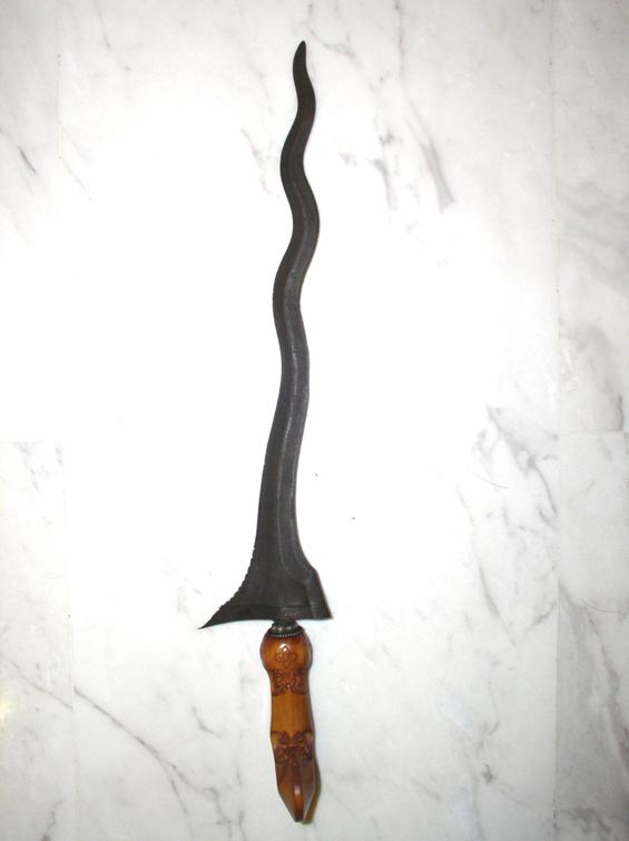

Dear forumnites,
Not sure if I have asked the question in this forum before, but can anyone tell me what dapur is this keris? Thanks.

Default JARAN GUYANG?
Seven luks, with details of gandhik 'lugas' (without sekar kacang), tikel alis, pejetan, sraweyan, ada-ada in the middle of the blade. Then IMHO, it could be a "jaran guyang", but had been modified a little bit. Because a "jaran guyang" should have greneng, but this could have been modified. There is also trace of change on the 'wadidang' side above the 'should be' greneng. It should be no trace of "ron dha nunut"...
The naming of the dhapur itself, literally means "horse" (jaran) "taken a bath" (guyang, this word is used especially for animal, not for human)...
GANJAWULUNG

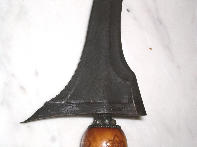

Kai Wee, would it be possible for us to see the top of the gonjo?
The wadidang seems to have a series of notches cut into it. It looks peculiar. Can you see what has happened there?
Is the gandik as steeply angled as it appears to be in the photos?

Yes, steep angle ("mboto rubuh") at the gandhik -- and even steeper and visually a little bit shorter (proportion) than usual javanese gandhik, is questionable. Just for comparison, the illustration of dhapur Jaran Guyang (from Mr Haryono Guritno's Keris Jawa book)....

Pak Ganja, my query was addressed to Kai Wee:- only he can confirm if that gandik is as steeply angled as it appears to be, because only he has access to the physical keris.

Thanks for looking at the keris, Alan and Ganjawulung.
Here're the additional pictures.
The series of notches are indeed peculiar. They are just notches cut into the wadidang. It's a bit difficult to take pictures from this angle, but the wadidang does not have any unusual thickness or anything.
The gandik's angle is indeed as steep as shown in the picture.

Madura?

A gandhik this steeply angled would normally cause us to think Madura, but based upon what I can see in the pics, I'm not prepared to say that it is Madura. Its a peculiar keris in a number of ways, and although my initial impression was that it was not an altered keris, I am now in two minds. It is not a high quality keris, so we cannot really apply strict standards to it:- a lot of quite decent keris were made in areas away from direct center-of-power influence, and by competent people who were not necessarily empus, or even pandai keris. These keris are often a mixture of styles, and this makes a classification difficult, perhaps logically impossible.
I don't think I'm inclined to give a dhapur for this keris.
In fact, it is often better to describe a keris in terms of its ricikan, rather than try to force it into the strict parameters of a dhapur.
