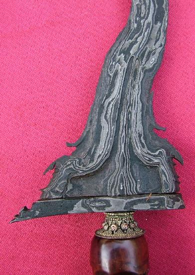

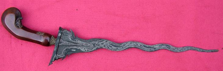

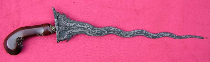

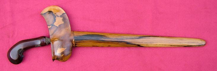

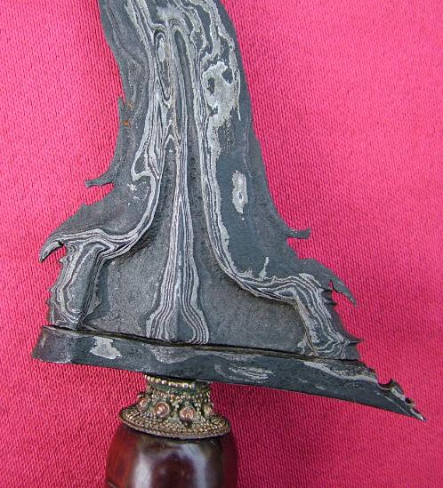

Default keris for sharing and comment
keris from solo
whit karna tinandung
regards semar
semar is offline   Reply With Quote

Default LUK 9 OR 11?
Just my humble opinion, Semar, your keris could be a 11 luks keris of carita keprabon (with sekar kacang, one jenggot and two lambe gajah) but "tinanding" (two sekar kacang), and not 9 luks. You may look at the tip of the blade -- it looks like too long, enough for one more short luk. (Please I apologize, if I'm mistaken...)

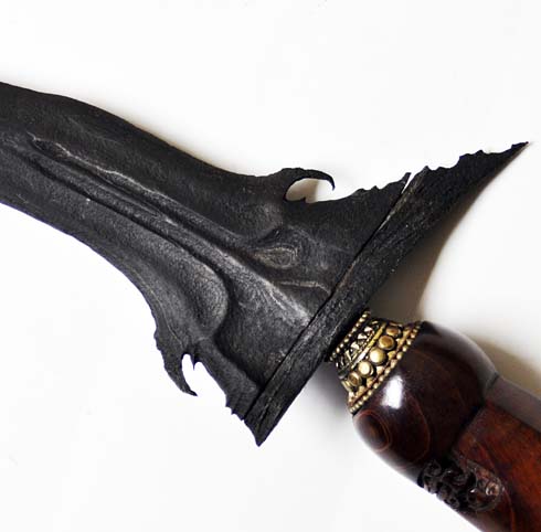

You may compare with my 11 luks (picture below) with two sekar kacangs too..

This is an interesting post Pak Ganja.
Tell me, what do you understand from the name "karno tinandhing" ?
Karno is "ear", but what about tinandhing?
I don't understand the word, I have just asked four native speakers of Javanese, one from Solo, three from East Jawa, and none of them can give any sense to the word.
I've even had a look at several dictionaries. I cannot find it at all.
We 've got "nandhing", which I think is probably low dialect for "compare" but "ti" is not a regularised prefix, and "compare" doesn't make sense --- I think.
So tell me, what do you think "karno tinandhing" means?
Looking at this keris of Semar's, there are a couple of things that strike my eye:- the distance from final luk to point, the apparent nature of the pamor, the odd little projections above the kembang kacangs, the method of workmanship.
Then there is the mendak and the wrongko.
Where do you think this keris might be from?

It has just struck me that we're actually looking at Kawi here.
Is "tinandhing" "ti - nan - dhing" :- "to work extremely hard until finished " ?
If so, and we add "ear", what is the sense of this?
Then consider the tuah.
