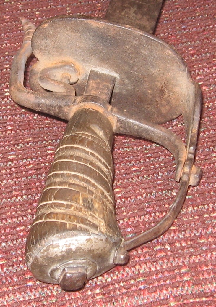

Default Spanish colonial, Malay pirate or...
I know I've seen this hilt style before, but can't quite pin-point it. The flat disc guard looks Span colonial, as do the bolts/screws through the hilt. The odd quillon reminds me of Singhalese kastanes as does the odd twisty metalwork. The blade is plain, tip rounded and unmarked, typical trade blade.

Old 8th February 2010, 11:52 PM   #3
Posts: 10,862
Well you've done it again Mark!!! You find the most intriguing stuff, and especially interesting items that seem to ever expand the envelope of things Spanish Colonial.
It would be good to see this overall, but the hilt detail is excellent.
At the outset, it does indeed seem Spanish colonial, with elements that allude to 18th century smallswords. The fixtures do seem Spanish, and most fascinating of all is the quillon terminal.....it appears remarkably like the rattles from the well known occupant of Mexican deserts..the rattlesnake!
All the best,

Hello Jim! Good to hear from you. Sorry about the minimum pictures, but that was all I had immediate access to. Yes, that quillon does indeed look like a rattlesnake's tail! I hadn't thought of that! Do you think the grip on this one is probably horn? I don't have this item in hand, but am considering a purchase-
Old 9th February 2010, 01:42 AM   #5
Posts: 10,862
Hi Mark,
I am really not good at assessing material, especially by photos, and of course it could be horn, though wood seems more likely. The spiral like coil around the grip seems like it narrows at the bottom like a snakes tail. The bite of the snake seems like a theme on some of the Mexican knives and edged weapons of 19th century.....as always trying to recall where I saw it.
Sure would like to see the blade.....really interesting piece. During the early 19th century, there was a great deal of imitation of European regalia and court type swords etc. Many of these unusual items were composite of military style and courtswords with multibar guards with crossguards under dishguards, and others. This seems an interpretation of a shellguard with the pas d ane space between it and the regular guard assembly.
All the best,

Rather looks like the offspring of a smallsword and a hirschfänger.

Yes, you are right. I was also thinking hanger/cutlass type. The blade on it is plain, curved and measures 24" or so.

Posts: 10,862
Hi Kisak,
Excellent assessment!!! With the presumed Spanish colonial character of this sword at this point, that is a perfect analogy, as the frontier espada anchas were essentially utilitarian much as the hirshfangers were intended. These frontier hangers actually are believed to have developed from European hunting hangers of the 17th century.
With the use of the hirschfangers or 'hunting swords' becoming more stylish and used as 'riding swords' in thier use, of course by the gentry and nobility, they became closely associated in some styling with courtly smallswords.....and this might well be perceived as a frontier 'hirschfanger' or hunting hanger of early Mexico.... or at least pending further identification.
All the best,
I also thought Naval Cutlass. Would like to see more pictures.

Gene, I like the way you think-
I will try to get the seller to send me another pic of the sword (no, not an eBay auction for a change!). Anyway, the guard made me feel that this piece would be more early 19th vs later Mexican piece. I know that the cup-hilts lasted as late as the first quarter of the 19th and this one seems to have honest age to it. I'd like to think that this sword might by some stretch of the imagination have seen sea service, but the southwest elements are unmistakable. Then again, the seller is reporting the grip as horn and does resemble it's Euro hanger counterparts, so still too hard to say. Thanks for the feedback so far, everyone...

Note the "rattlesnake" quillon on this Spanish sword, Lot 173 on pg 76-77

Hi Eley,
Depends on what you mean by a cup-hilt. The real cuphilts saw the peak of their popularity in the 1650s, and kept on being used and made until the very early 18th C (~1710).
The smallsword began its ascendancy in the 1680s, and in fact some arrived to America in the 1670-80s. By 1710 they were already in ascendancy over the cuphilt.
Some cuphilts survived in the dry american south-west longer and were used until much later, but their use was vestigial, as the colonists would use anything they could get their hands on.
If you are including the bivalve-guards or clamshells, such as the spanish M1728 and the later M1788 and M1796-1800 as cuphilts, then indeed they saw use until the very early Napoleonic Wars, mainly in cavalry units. In fact, their hexagonal or "a tres mesas" blades kept being reused until even after the American Civil War.
OTOH, the spanish bivalve M1728, the boat-sail M1788 (a la vela) and the M1796-1800 dragoneras were not realy cup-hilts.

Hello Manolo and thanks for replying.
Yes, I remember this discussion about cup-hilts and it was my mistake to use that term. What I meant was, to my knowledge, even the clamshell and bi-valve guards seemed to have disappeared by mid-19th c. The later espadas seemed to resemble more of the so-called D-guard style with plain wood grips or the more fanciful pieces with quillons of serpent heads, horse heads carved from horn. Gone were the disc-like guards and even those with the separate bars bolted to the hilt had disappeared. The later espadas were headed for their transition into the modern machete. Thus, I used the wrong term (cup-hilt instead of clamshell), but meant the earlier form from the period of 1700 thru first quarter of the 19th.

Jim, being that the espada from the catalog with the rattle quillon is Sonoran, do you believe (just your opinion) that the cuphilt that started this thread is also of that area, or perhaps the snake analogy might have been used elsewhere? I'm not trying to pin you down, I promise. I know these pieces can be quite elusive (case in point, the Brazilian cutlass- ). In any case, I wax and wane as to whether i should add this interesting piece to my collection. Under the consideration that it might in some capacity might have seen sea service, as would be the case if it were Cuban, Brazilian, Mexican coastal, West Indies, etc, I would be more interested. Much like hangers and smallswords that are theoretical items that may have had naval use, such an attribution would make this sword more endearing to me.
Can you tell I am fishing for what I want to hear , but seriously, if it is strictly from the SouthWest, I'll have to debate some more...

Hi Mark,
Clearly the 'Sonoran' attribution is broadly placed, and is strictly my own opinion based on the years I have viewed many espada anchas. As with most ethnographic items, it is hard to place regional affinities, but for me, the rattlesnake metaphor comes most likely from the Mexican Republic period just after the 1821 independance from Spain. The standard form hilt and heavy forged blade resembles those of the period from most of the border areas and perhaps even as far as west Texas, of course exceeding my Sonoran suggestion.
As you know, there is no strict delineation on what swords may have gone to sea....though I think zweihanders and claymores were likely exempt !
This remains to me a very intriguing frontier Mexican sword probably with some very interesting possibilities, but I honestly doubt it saw the 'Main'.

I sort of guessed that myself, Jim, after the Sonoran aspects of the piece started to become obvious. I know that some of the later cup-hilts (Sorry, Manolo ) did serve the Spanish Main, so it was worth a thought. Likewise, the reason I swerve away from Mexican-period pieces vs Span colonial is that they fall after 1830 at the end of the "Fighting Sail" period. I still might acquire it, but I'll have to think about it. If I pass on the deal, if anyone else is interested, I'll give them the info. A very interesting piece, none-the-less.
