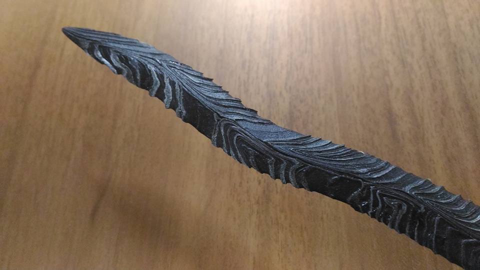

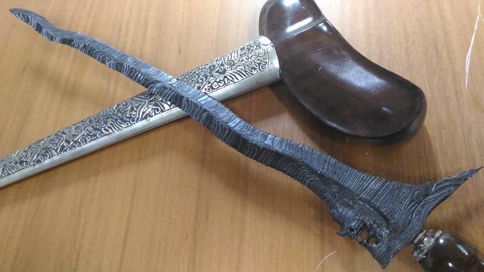

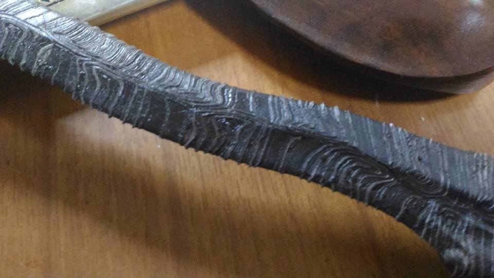

well, long time not showing up here, as somehow I forgot the password !!
cheering up today, is one of my collection, a naga keris with pamor miring
somehow, it's getting rarer and rarer to see, perhaps because this type of pamor is harder to make ? or simply no longer economical to make one ?
when it arrived it was covered with rust and some kind of sticky goo, which is very hard to remove, and it reeked with sandalwood aroma
tell me what you guys think ...
Donny

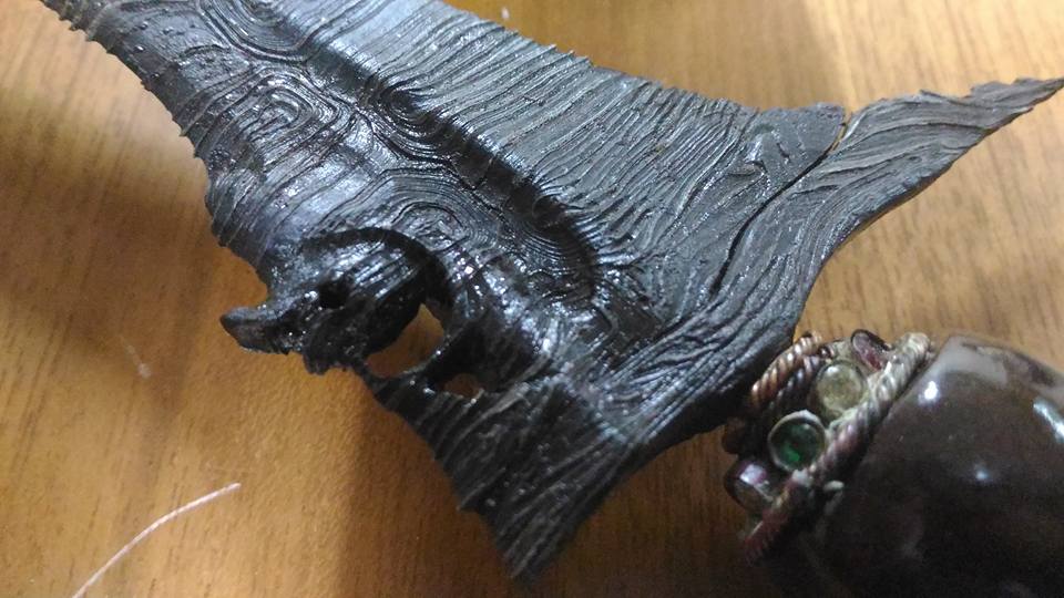

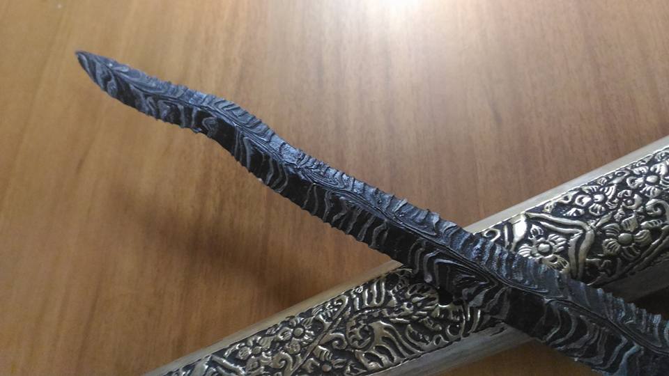

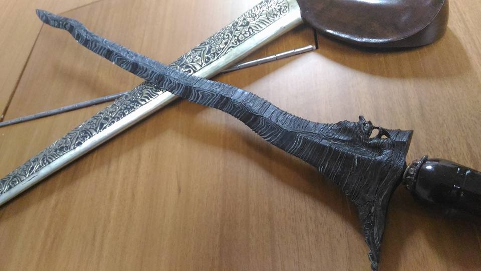

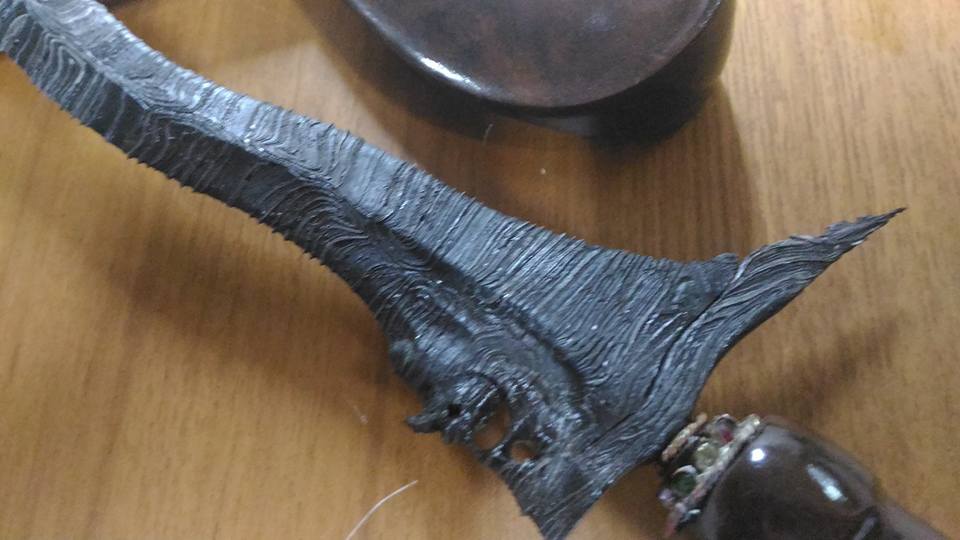

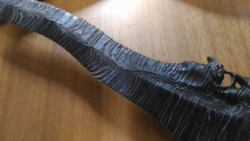

more pics

Hello Satsujinken,
Although you found this blade in rusty condition, it looks recent to me and quite similar to the ones which you showed us earlier. The pamor pattern may be Eri Wader or Unthuk Banyu, and the blade shape lacks elegance as the luks are uneven.

Originally Posted by Jean
Hello Satsujinken,
Sorry I forgot to sign my name
What do you mean by the luks are uneven ?
This sort of dhapur is rather unique, panji kuda and the luks are made that way
Donny

Although I am just a novice in the field, and although it is quite dificult to judge by the photos, I believe this is a very recent Kris.
PS: Very recent meaning made probably this year.
hahahahaha ... good eye !!
and may you elaborate why you think so ?

Hello Donny,
This daphur with luks at the base and tip only, and straight in the middle section of the blade may be unique, but it still looks odd in my eyes....
The high relief "pamor" or whatever it is called is the result of very modern processing... I believe.
Also about everything else looks very similar to the very recent Kerises I saw this year in Indonesia. And some of them were obviously artificially aged.
For example the metal sheath cover looks like being made of pressed & aged aluminium foil attempting to look like silver.
mariusgmioc is offline

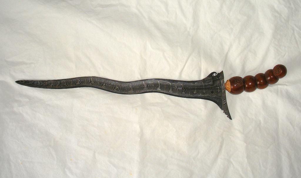

I'm wondering if OP's keris has a core, or if it's just pamor material?

Marius, the pendok is the real deal, not some sort of machine produced garbage. No idea how old it is, if its mamas (unlikely) its pre-WWII, if its brass with poor quality plate its pretty recent, but it was made by hand and in the same way that this type of pendok has been made for a very long time. It might also be white brass. But its real, and really pretty fair quality.
Same goes for the wrongko.
Mendak? ugh!
Blade? nice quality current production, probably no core, but then the very few old ones of these I've handled didn't have a core either.
Some pamor motifs cannot be produced with a core, like buntel mayat for instance --- well, that's an untrue statement, they can be produced with a core, but I've never seen one with a core, and I very much doubt that they ever were made with a core.
All in all, not a bad keris --- except for that disaster of a mendak --- but its not old. It is artistically not a bad effort.
Oh yeah, the dhapur is legitimate. Absolutely.
If one's taste is orientated to antiques it is obviously unacceptable.
If one's taste is orientated towards keris, and all that this implies, it is very acceptable.
Then of course we have the question of value difference between a current era production and an old example of something well made and rare:- this difference can be heart stopping.

I agree with Alan on this one regarding the dhapur. I have seen similar "uneven" luk dhapurs and in fact have an example (albeit a contemporary version) of such luk spacing in my own collection.
While i appreciate the effort artistically to some extent i am not particularly fond of the apparent lack of a core. While, as Alan points out, some blades such as buntel mayat tend to be coreless, this does not seem to be one where i would expect or desire a lack of a core.
But yes, this is most certainly modern production. Nothing wrong with that, but it is what it is.
