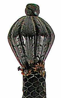

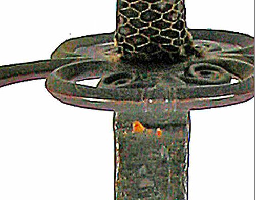

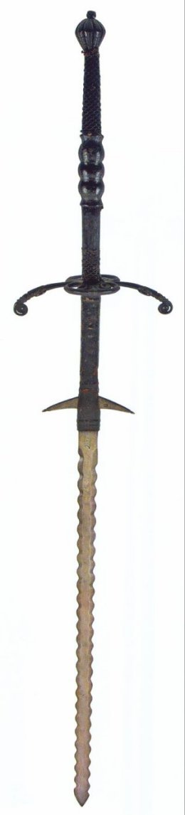

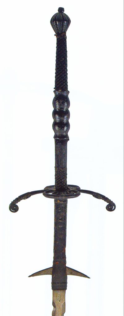

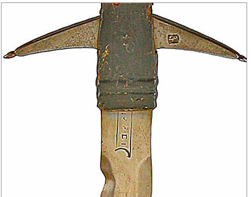

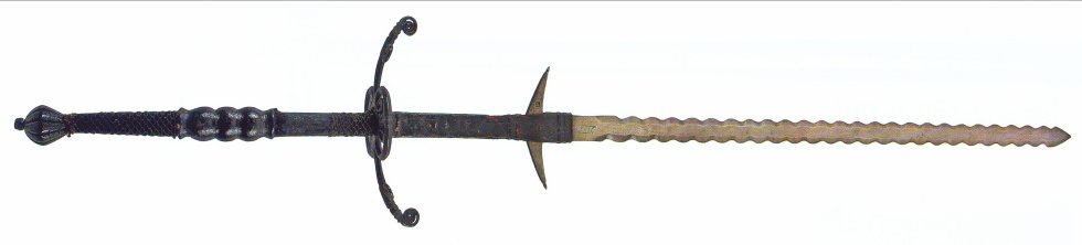

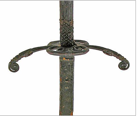

Default A Fine Saxon Two Hand Processional Flamberg Sword, ca. 1590

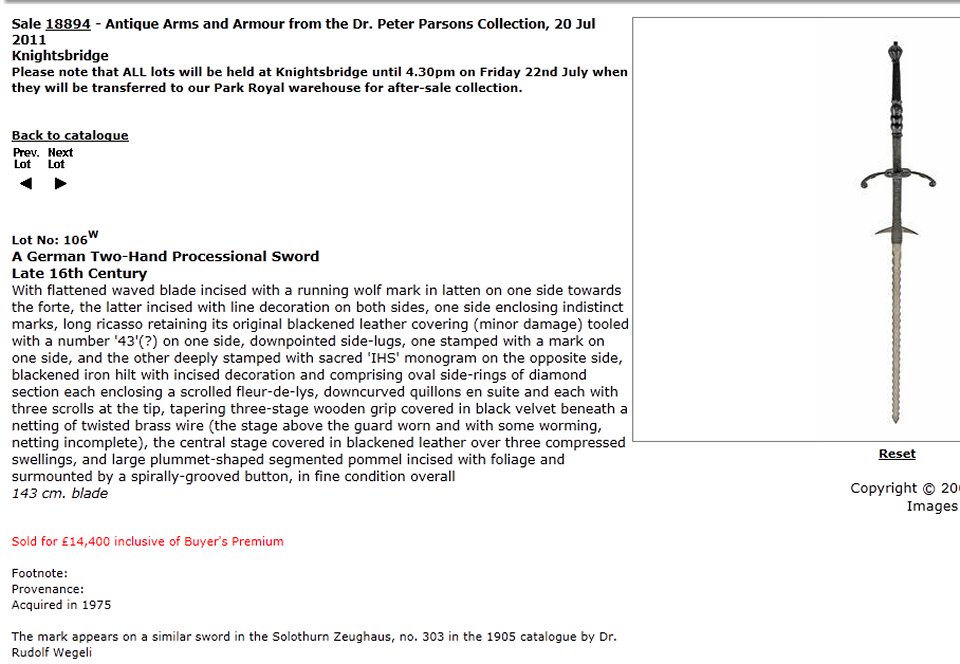

Sold Bonhams, London, July 20, 2011.
Identical swords are preserved in the Dresden Rüstkammer (amory).
The historic German term Flamberg derives from the waved blade which reminds of a flickering flame.

These huge and extremely formidable looking swords have always intrigued me, especially as to why they had the undulating blades, and if they were ever really used in combat. Most references I have seen make note of the misnomer 'flamberge' which seems to apply to the name of the sword of one of Charlemagnes paladins in those romantic epics of chivalry Renaud de Montauban.
Victorian interpretations often added the allusion of the Biblical accounts of the flaming sword guarding paradise, and these may be associated with descriptions of the Tylers sword in Freemasonry. It is often argued that the correct term is 'flammard' or 'flambard', but it seems the terms are so close that the variation is not particularly relevant, and the commonly held term emplaced by earlier writers and collectors is sufficient.
Some references note that these swords with 'flamboyant edge' were used only for state ceremonies, used by Dukes of Burgundy and in England until the time of William III (1689-1702). Other accounts claim that these were used early on by landsknechts and most often by most skilled swordsmen, doppelsoldner's, within the pike squares to guard important figures.

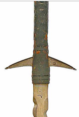

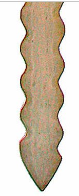

I am unclear on the parrying hooks (flukes) seen on these huge swords, and whether the undulating edges of the blade were really effective at cutting if these were indeed used in combat. It would seem incredibly difficult to manuever a weapon of this heft in parrying, and would like to hear more on the actual use of these huge swords.

In fact the practical use of these swords has puzzled many weapon-experts.
Sometimes they are referred to as "processional swords", being carried as symbol of authority, but also an employment in warfare, as lance and halberd-breaker, is supposed.
In old etchings (I remember one, probably made by Durer) two landscknechts are represented carrying such swords on their shoulders.

The heavy 15th and early 16th c. Landsknecht two hand swords were of different form and used by the Doppelsöldner to brandish with great force in order to destroy the opponents' long pikes. They usually had straight blades.
By the late 16th century, they had all had become mere bearing or processional swords and changed their form.

Thank you Michael and Gio, nicely explained. It seems that most of the references I found pertaining to the wavy edges do not consider any notable advantage to the presumed increased cutting surface of this feature. It is noted that the forging and maintainance of these blades would be more involved, thus it does seem a feature 'for effect' in dramatic presence rather than use. It is interesting that artistic license seems to place these wavy blade types with Landsknechts in many instances. It is also interesting that the vestigial parrying hooks remain present on these non combative bearing swords.
The use of the heavy two handers in combat as noted to destroy long pikes seems understandably effective but I am unsure how the equally large claymores in Scotland were used in thier type of warfare.
All the best,
Hi Jim,
You are absolutely right, of course: the wavy blades characteristically correspond to the early Renaissance artistic taste, and it is interesting indeed that they should mostly occur on late Renaissance types. The parrying hooks on those late big swords seem nothing more but a stylistic reminiscence of their practical use half a century before.

Wonderful post Michael, thank you!!! I really look forward to more on these.
All the best,
Done, Jim,
And an early type of the 1540s, too!

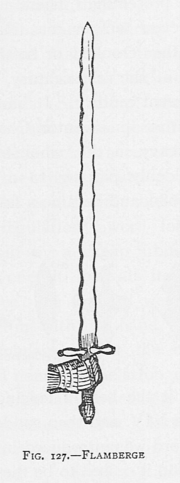

I couldnt resist an illustration of a MacDougall clansman with one nearly as big as him. Aye, hoist a Drambuie!!!
All the best,
