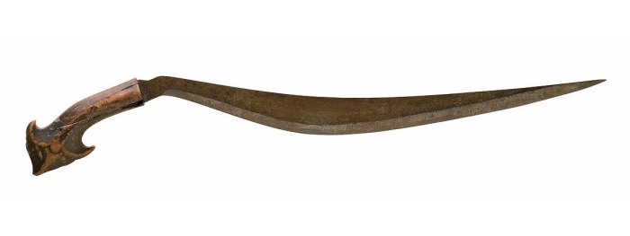

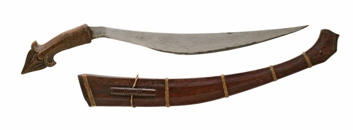

If the bevel is on the right side (e.g., talibong without scabbard below), it's for a right-handed person. Thus the talibong with the scabbard (bevel is on the left) is for the southpaw

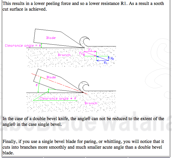

Of course we all want to forget those physics equation
But for those interested on that aspect, earlier a friend referred me to this site. The illustration there explains the principle:
Old 22nd January 2010, 12:48 AM   #6

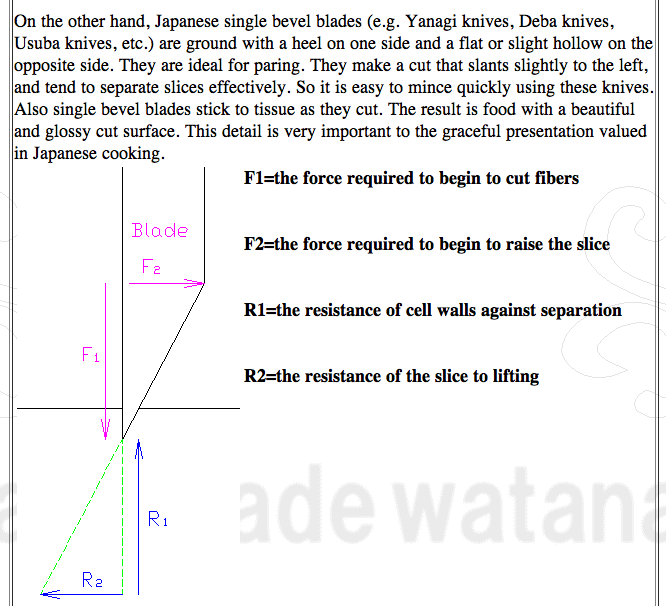

part 2 of 3:

3rd of 3 parts ... and i'm out of here!

Actually your's Bill is the only Lefty one shown .
The lower one in post 4 is a right-handed example .
The bevel is gentle and convex and starts at the spine unlike most ground bevels .
The photo fools the eye .

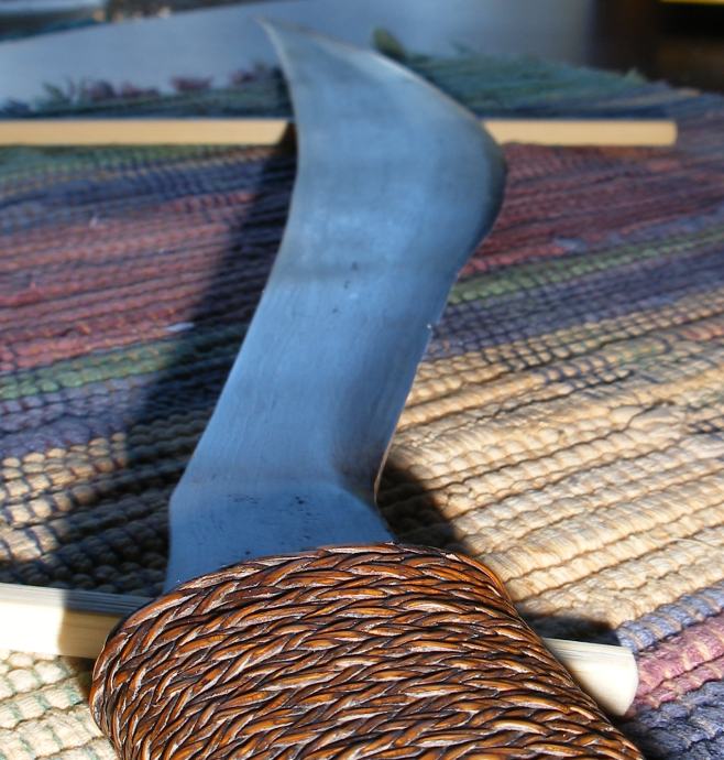

Thanks Rick for pointing that out

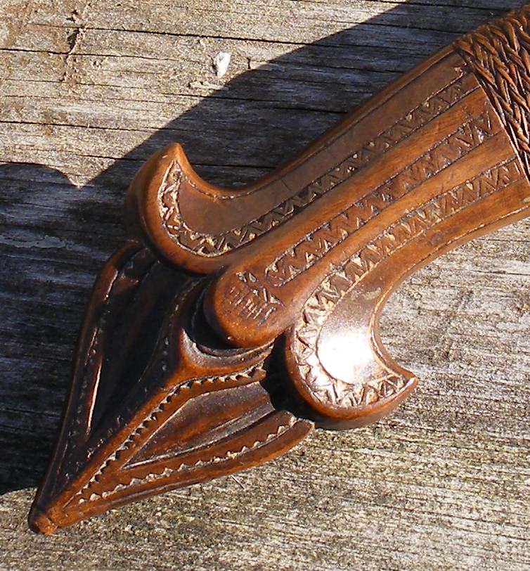

Can you please show us a pic of that talibong from another angle that shows that gentle convex bevel? Additionally and if it's not too much to ask, can you pls. show us also a close up of the pommel? Thanks in advance!

Your wish is my command .
Even in -0c temps .
Brrrrr .

Nice pics, and many thanks indeed, sir!
Technically speaking thus, would that mean then that that talibong has a combination of flat grind and convex grind, and it's not a chisel grind after all, as explained here? In any case, it looks like for some the convex grind is a cut above the rest.

Hi Miguel,
Maybe chisel grind is not quite the word we're looking for here .
The other (left) side of the blade is absolutely flat .
The bevel on this blade looks to be forged in rather than ground ; would you agree ?

Yes indeed, chisel grind is not quite the word. Thanks again ... and I owe you a hot drink

So what do we call this edge then ?

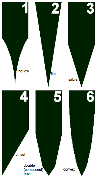

While some might differ, I know with the laraw (Taiwanese aboriginal headhunting/survival knife of the Atayal group) I have handled, their single-bevel blades are kind of like what migueldiaz is saying...
Here's a diagram I made. The flat side is angled to make the edge centered instead of to the side so to speak. Where-as others are to the side and others have a double bevel.

How about convex bevel ?
