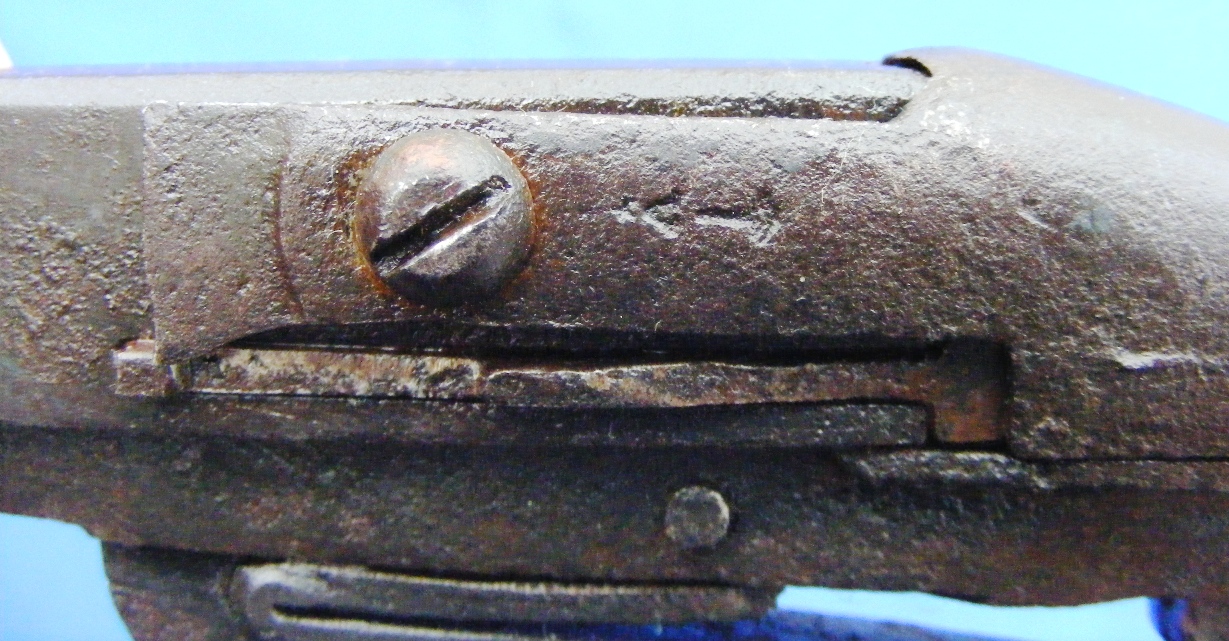

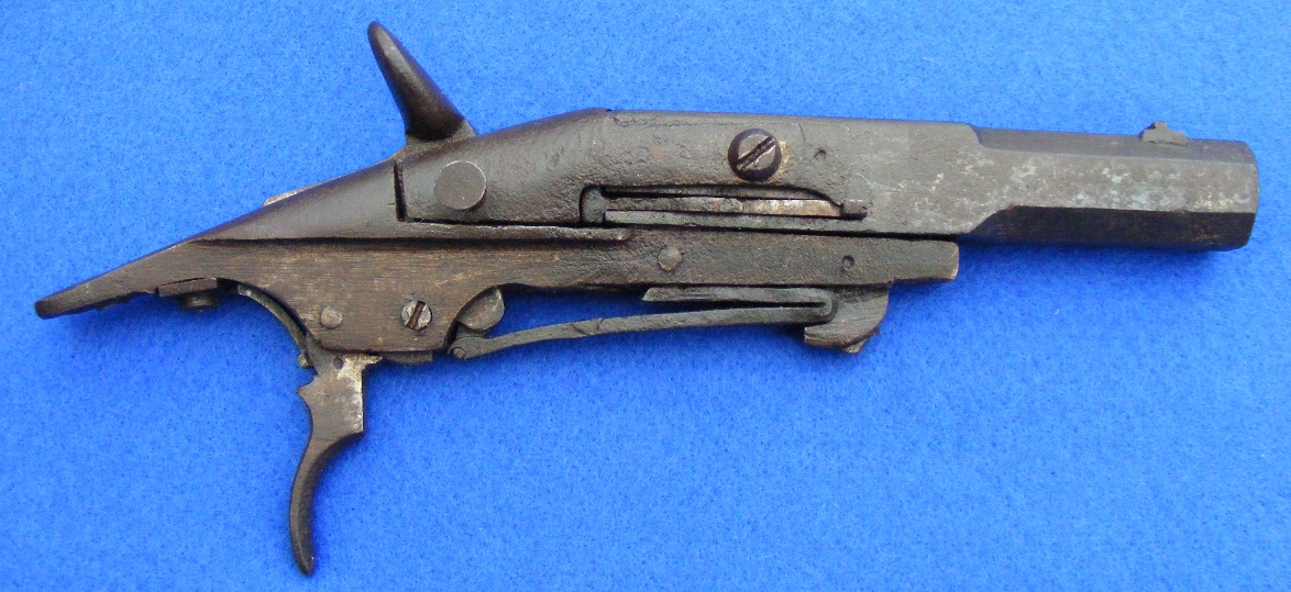

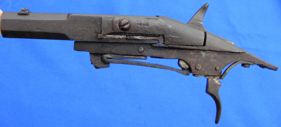

I received this pistol part with a few other bits and pieces that I bought at an auction in the U.K.. Would anyone have an idea what the pistol is please?
There are a couple of markings which appear to be an arrow over a letter 'V' over a star. The barrel is octagonal with a bore of 8mm.
Thanks.

Old 21st January 2010, 05:16 PM   #7
Ian Knight
Ian Knight's Avatar
Join Date: Dec 2009
Location: East Sussex, England.
Posts: 103
Thanks guys. I think you are correct Dmitry. The barrel appears to have been cut down to turn a rifle into a pistol. The sight does have a 'V' cut in it.
I have taken it apart but I will have to wait until daylight to take a decent photo. The hammer strikes against a pin which passes through a hole in the the breech. The breech can be swiveled up to load by means of a little handle on the right side of the breech. The hammer has got two cocked positions.
Ian Knight is offline   Reply With Quote
