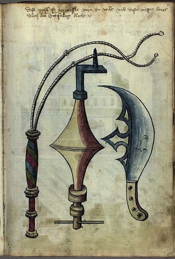

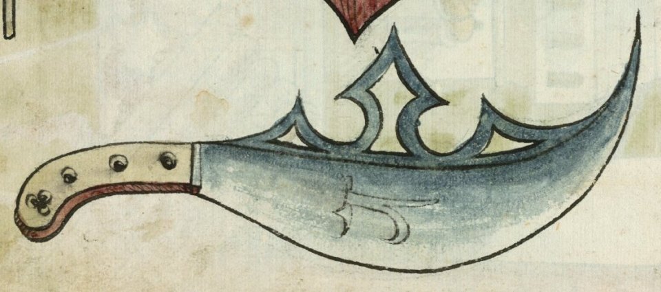

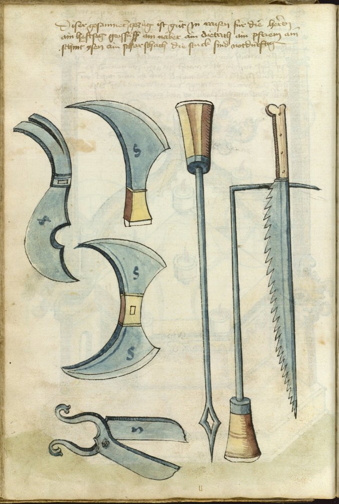

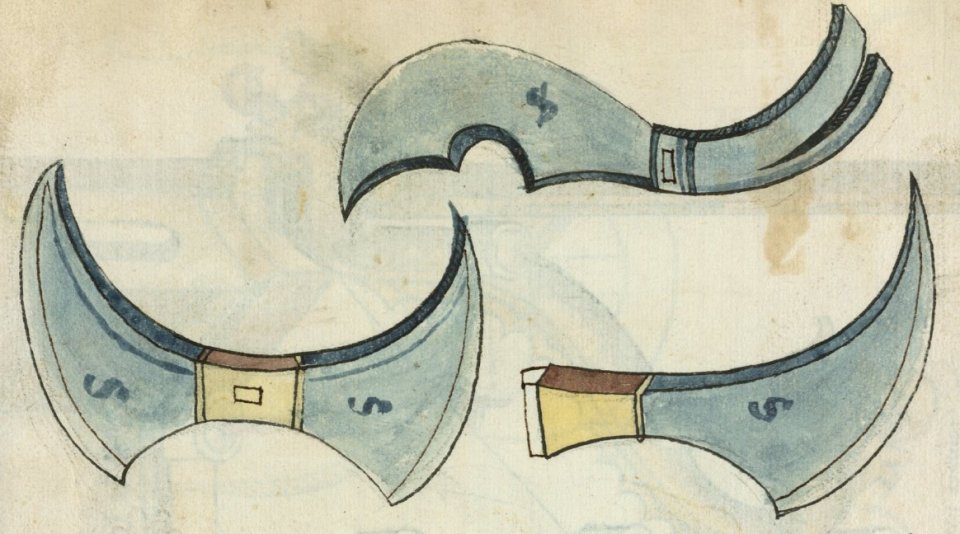

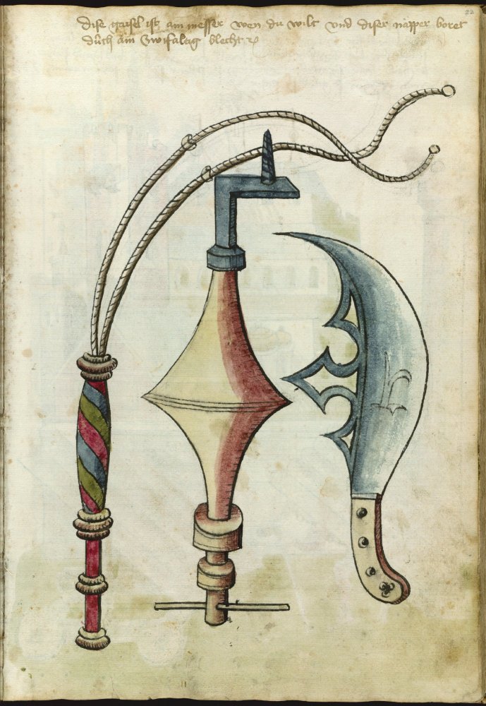

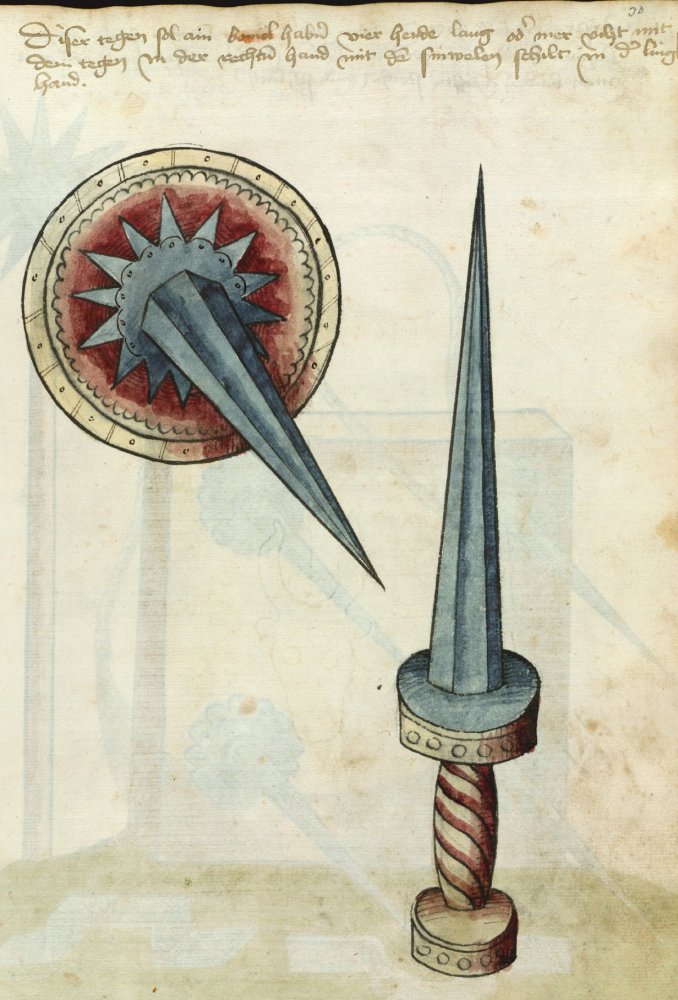

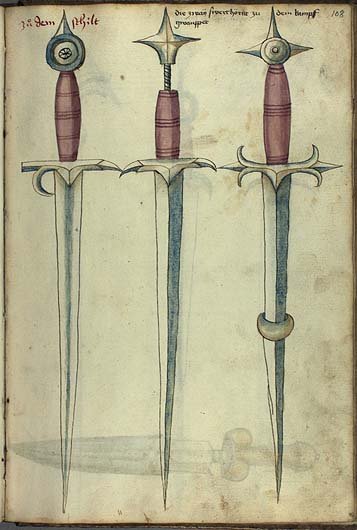

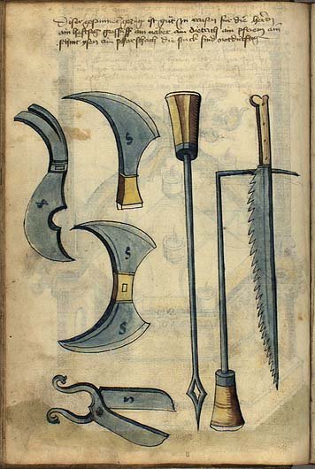

Hi there,
I finally found other samples of such dagger knives, i.e. one-edged daggers, in Thalhoffer's Fencing Books of 1459, together with various more curious daggers and devices you would not have believed they had existed.
Please note the 'bladesmith marks'.
This also backs up what I said about Bosch and his predilection of depicting oldfashioned pieces of accouterment that were still in use with the rural population decades after their make.
I realize this is not a proof of their actual existence, just one more evidence of their being characteristic of the Gothic style.
Enjoy, and best,

Good Morning Michael & a Very Happy New Year!
Wonderful reference, and I thank you for posting it. The deeply curved belly of the 3rd example in the 1st panel (counting left-to-right, top-to-bottom) does indeed resemble our "mystery dagger" in blade profile.
Considering the fanciful appearance of the cut out work along the blade spine in this illustrated example, I can't help but think that if it existed, then Bosch's dagger likely existed as well (especially in light of the other reasons discussed in the thread). Given the details which seem to indicate he painted the same dagger in two of his works, I have to wonder if he had some personal connection to this particular dagger...
Do you by chance have larger scanned copies / images of these pages available? If so, I can PM you my email address, as I would like to have them on hand for reference. I find the turned wooden grips to be interesting, as well as the exposed tang on a couple examples (that appear to be twisted?).

http://www.kb.dk/da/nb/materialer/ha...ott-2_290.html
OK, for all those who do not indulge in a long search, here are the relevant scans in optimum postable size.
