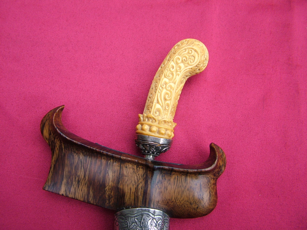

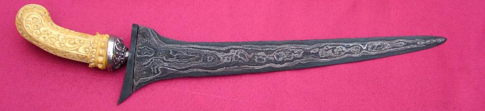

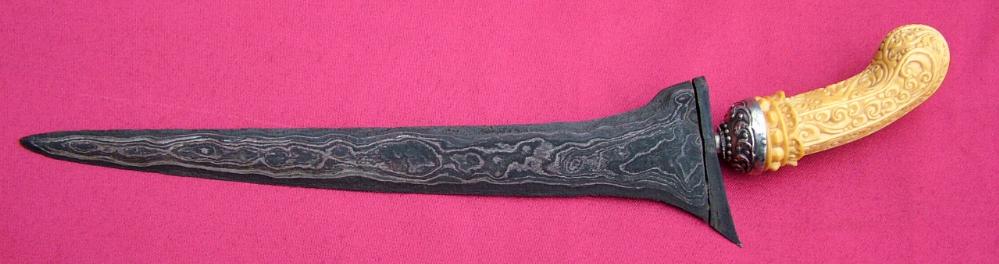

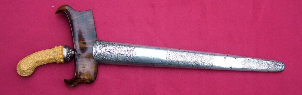

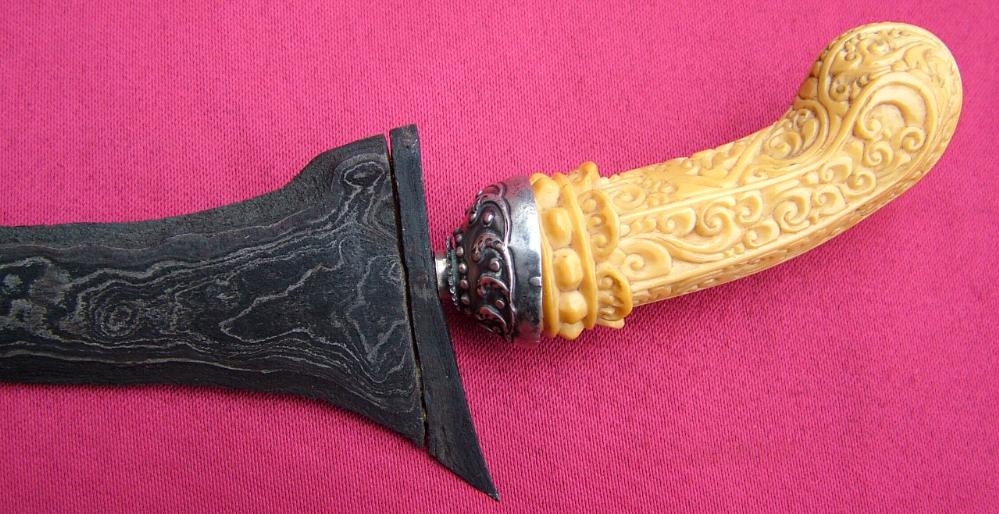

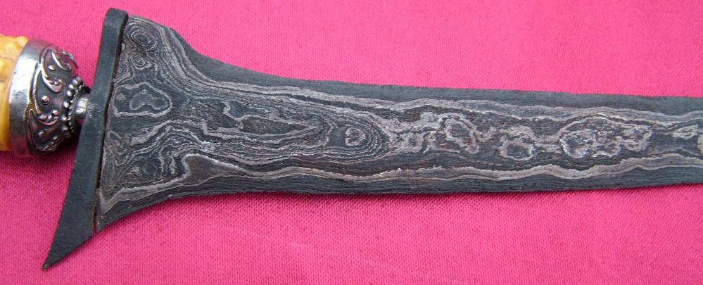

I have receive this keris today the picteurs are for sharing comment is welkom
regards semar |

I've always wondered what a Borneo keris would look like. It's hard to imagine that this is what it looks like. Anyway, it is a young keris, and they can turn up in many unusual forms.
We have seen some Bornean sundang in Museums, but normal sized keris? Maybe more Bugis style than anything? ![]() |
#4 |
Posts: 7,218
It looks like a mish-mash of styles thrown together. The hilt looks like new ivory, not particularly well carved and then colored to look old. Perhaps an old Javanese pendok thrown onto newly carved sheath. The blade is a bugis style. I too am having difficulty accepting this as a style of keris that is indigenous to Borneo.
#5 |
Location: Singapore
Posts: 1,180
How about Non-Bugis trying to make Bugis-style blades?

oke thank you but ho can show a fuwe borneo keris for compering
regards semar |
#8 |
Posts: 7,218
Semar, just about all the keris that i see from Kalimantan these days are new keris made mostly for the tourist market. The true antiques that i see from this area are mostly sundangs, not regular sized Indo-style keris. I see quite alot of new panjang style keris described as having Kalimantan origin. I have also seen the crudely painted sheaths with teeth ornaments described as originating in Borneo. These usually have fairly junky trade blades from Java or elsewhere. Frankly i doubt that any of these other than the actual antique sundang from the area have any true ethnographic bearing or application. I have never, for example, seen any old photographs showing someone in Borneo wearing one of these painted teeth decorated sheaths as a part of any traditional dress. I have seen no evidence that there was any particular traditional manufacture of keris from this area other than the sundang. If the standard Indonesian styles of keris were indeed used in this area traditionally i have a feeling that the origins of those keris most probably are from other areas of Indonesia. I don't think that we will find a traditional style that originates in Borneo.

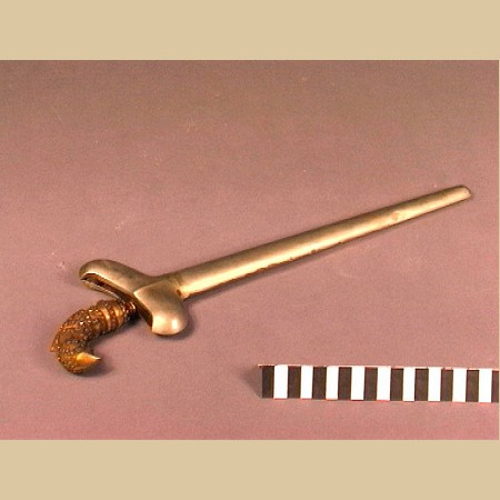

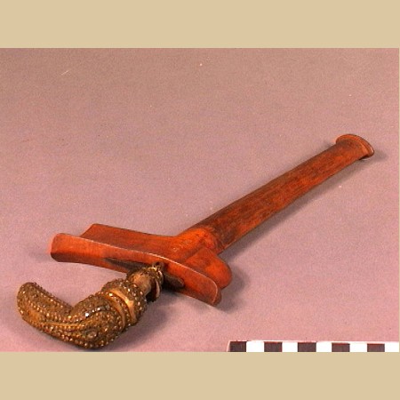

In the north-east part of Borneo you mostly see the moro styled krisses. This because the moro's also settled at the coast there. But the natives there who had these, got it by trade or buy (or from victim? ![]() In the south, in the Banjarmasin area, the types crossed you find on attached 2 photo's from the Leiden Museum (but here a lot of trade was going on). All other kinds of kerisses found on Borneo (old ones) are imported by traders and travellers. You find Javanese, Buginese, Sumatran and other types in museum databases depicted as Borneo kerisses. But they are no typical Borneo kerisses, because the nativs of Borneo traditional never had kerisses. Old kerisses could be acquired in Borneo, but that is all! They were once long ago imported! Rg, Maurice |
