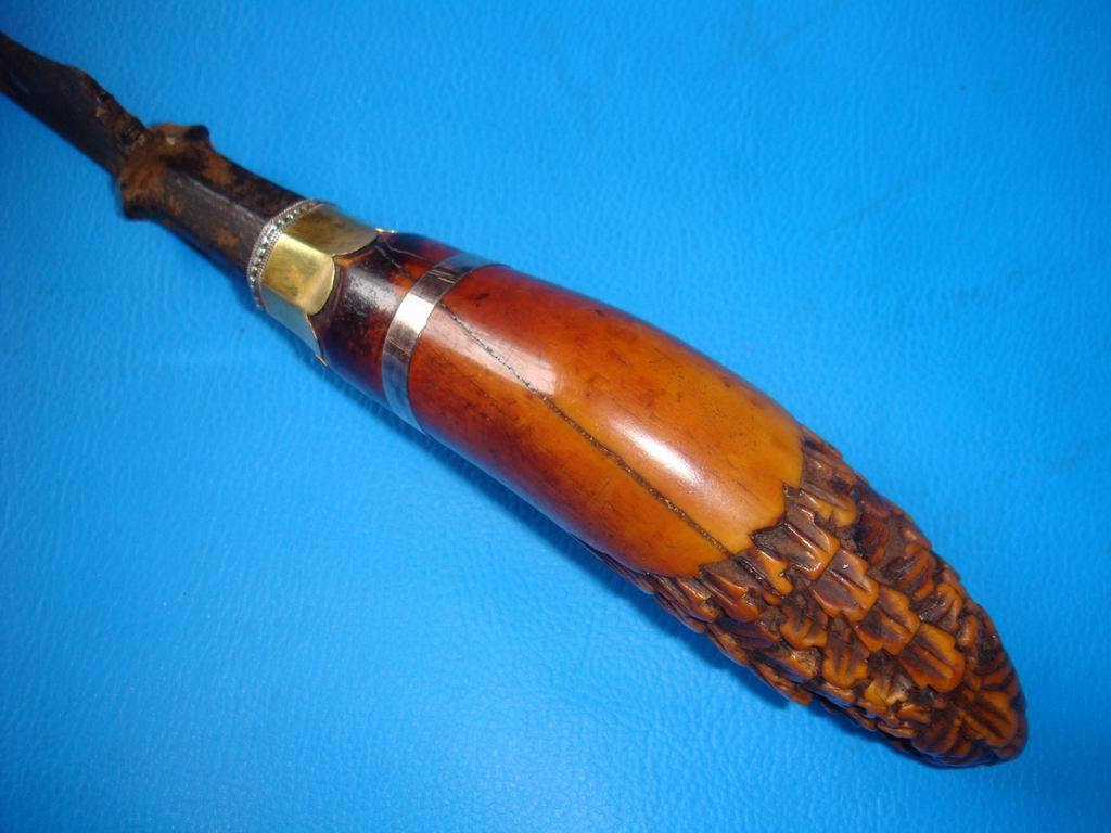

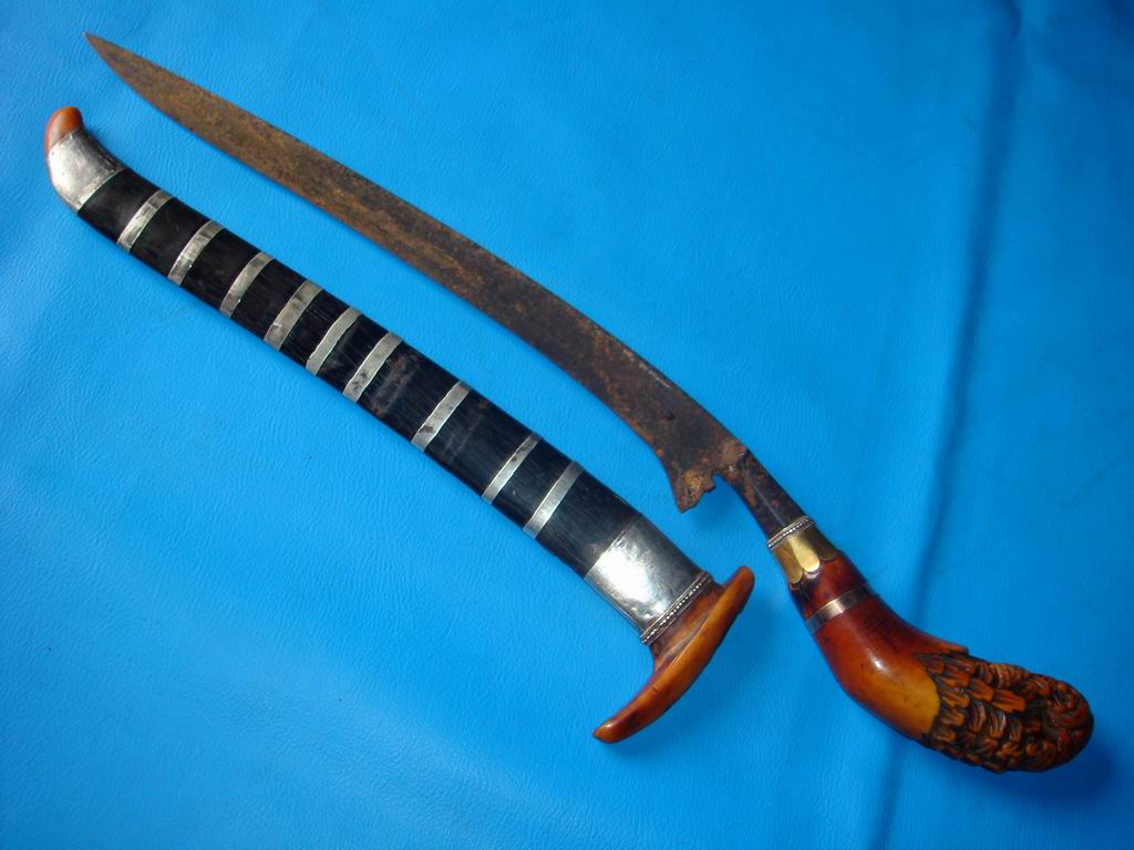

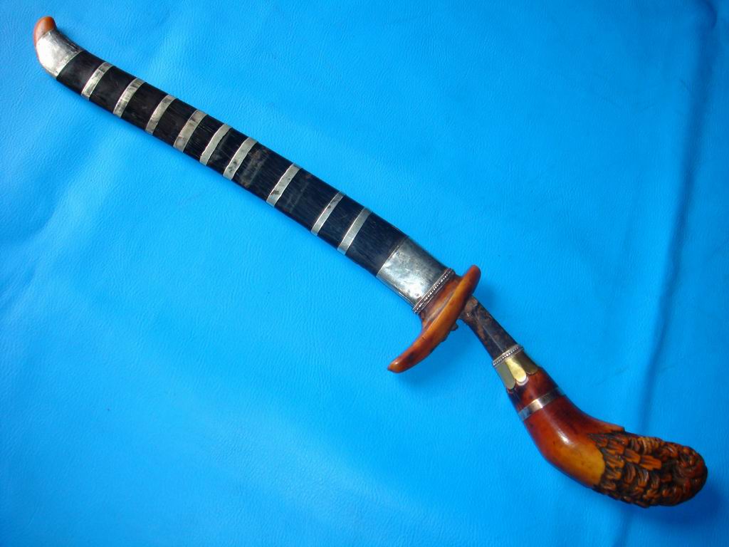

Actually , were there any differencies ?
Last week on Meulaboh, Aceh, I found an interesting rencong , they said that`s Gayo Rencong and called it "Rencong Pisang" ( pisang , literally translate to = banana ? ), the shape remind me on Michael posting.

I found out later that the one Erik asked about was Gayo.
Otherwise I still haven't found any 100% sure way to separate them.
Yours is a bit difficult too as it doesn't look as old as the ones in the reference works.
But the sheath might be Gayo? The ivory hilt however looks more like a "modern"
interpretation to me, but I might be wrong?

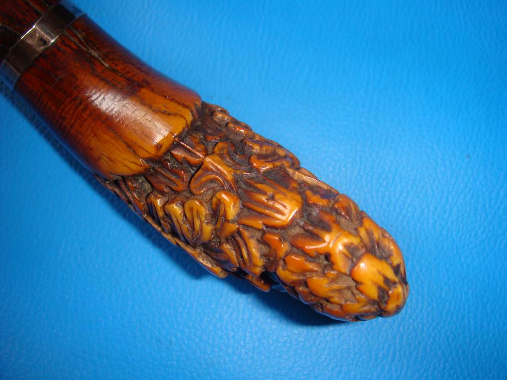

May i know, what make you think this is a "modern" interpretation ?
Here the close up of the hilt, the fitting seems restored , supposed to prevent further crack on the hilt ?

There seems to be subtle differences between Gayo and Aceh pieces.
Most examples of a hulu dandan like the piece of Michael seem to be gayo.
Also the goldwork near the base on his piece seems to be typical of Gayo pieces.
There is little real literature I know of that sheds light on this question though...
Your sheath seems very Gayo to me.
Also the copper crown is what I think to be gayo (but based on very little knowledge!)
The handle looks very much like the sheath decoration on some sumatran sewars.
I have a similair question about the difference between Batak and Gayo lopah's. I will make a post about those.
Regards, Erik

As Erik also indicated this floral design style reminds of other weapons than rencong and other regions than Aceh.
I also think the ivory looks unnaturally aged.
But maybe I am wrong as it's only based on your pictures?

Dear Jhony,
I have similar feelings as Michael regarding this rencong.
The ivory handle and scabbard have a strange color.
The carving of the handle is very unusual.
That, together with the very rusty blade and the fact that it has been recenlty acquired in Aceh makes me suspicious.
As for the gayo aspect.
I am much less of a reader than Michael and Erik.
So my knowledge is limited and only based on specimins I have seen in collections and books.
But I agree, the scabbard makes one think of gayo, but the blade and handle not.
Old 25th November 2009, 09:24 PM   #7
I'd also guess that the blade originates from Aceh. It may be old but I'd guess that the base has been reworked by someone of lesser skill and/or knowledge.
It would certainly be interesting to have the age and source of the ivory checked in a specialized research lab. IMHO, the metal decoration at the base of the hilt also doesn't show traditional craftmanship and may be a rather late restoration attempt. I also have my doubts regarding the scabbard, sorry.

My novice eyes cann't spot the artificial aged on handle
Yeah, the handle carving seems very similar with what usually found on sewah or tumbuk lada.
Well, what a price for learning.
And i note another thread about the ethical "rule" on this community , you all have my assured this "modern" interprated goods will not showing up for sale.
I knowing well the previous owner, might could be returned ....
Rgds
Jhony
