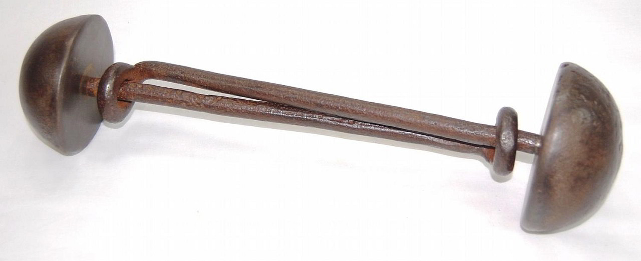

This bar-shot just sold on eBay for over $500.
http://www.ebay.com/itm/rare-18th-ce...vip=true&rt=nc
How do we know that it is genuine age of sail implement and not newly-made?

i like the bit where the connecting rod is welded to the half shot. being flat on one end for display surely also adds value.
Yes, it definitely adds to the WAF - 'wife acceptance factor'.
I also wonder about the rods being round. The vast majority of the ones I've seen have rectangular rods.

yup, hadn't exactly noted that, the slightly flattened end twists threw me off.
they must have had a very good blacksmith, dedicated and willing to spend all that extra time forging it so nicely round. i'm sure the performance difference was worth the effort and reduction in productivity.
shame he spent so little effort on engraving naval scenes on it tho. that would make all the difference.
the one in this photo is not quite so beautifully finished.
note the lack of a weld fillet on the join to the shot halves, and the bars, while round, do show hammer marks from forging.
just for interest, the bar on the attached one appears to have been shrunk fit into the shot (heat the shot, hammer the cold rod into the expanded hole). there is an area around the join on the flat of the shot that looks discoloured, possibly by this type of operation. or were they cast along with the shot? seeing the face opposite the flats might be informative. could they have been threaded and screwed together hot to join them? should we set up a barshot factory? i'm sure mythbusters would test for us.

This reminds me of that thread I started awhile back concerning these rare items. Another red flag for these expanding bar shot are the sheer number of them that seem to pop up. Because they were a relatively primitive item, it doesn't take much to make a really good fake. I've always wanted a bar or chain shot for my collection, but with so many fakes, I've stayed clear for now. Dmitri, you are spot on with your observation about the vast majority of the bars being square and not round. I see many dumbbells being sold as shot also.
I think you're absolutely right re:the joining of the 'bun' to the rod by hammering it in while hot.
