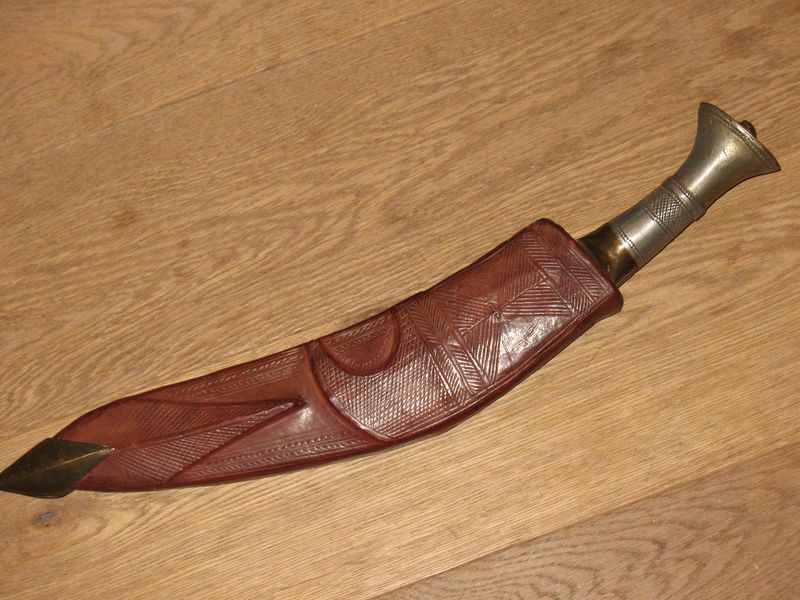

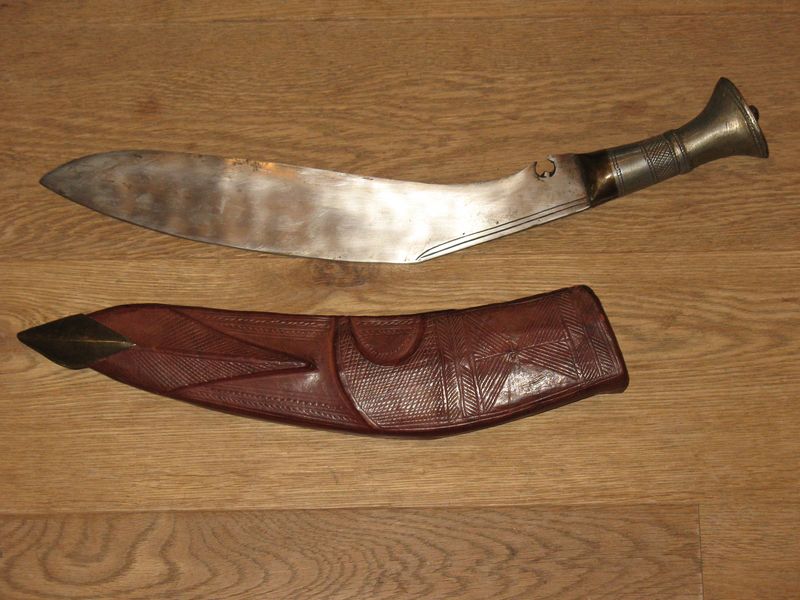

I bought this Kukri.
Based on the blade quality I would not give it much age.
But I am a complete dummy on Kukri's.
Checked some threads on the forum and based on them I would say mid 20th century / Nepal.
Am I close ? please correct me when wrong.

Your very close I think Asomotif!
Ive seen many of these & had a few.The handle, flat blade spine & sculpted scabbard are all highly recognisable & those that were provenaced {about 3 I can recall.} were generaly late WW2 era pieces bought or traded around the Assam & particularily Darjeeling areas by British & American service personel.
Darjeeling is in India but has a massive Nepali population & indeed today it own seperatist movement.
Yours looks in very good condition. There seem to be generaly reliably made but have no finnesse.

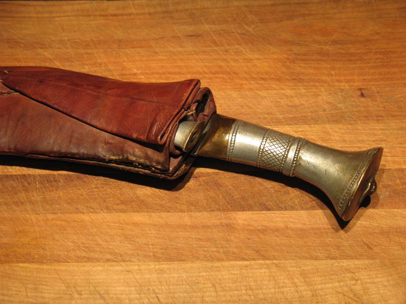

A nice kukri, that style has been around before WWII, RFM Lalbahadur Gurung (Mounted runner for Villiers Stuart 1920-1924) presented to his Officer Villiers Stuart (5th GR) a very similar kukri and scabbard.

To my eye many many differences from the typicaly Darjeeling/Assam WW2 era piece presented by Asomotif & Lalbahadur Gurungs kukri with inscribed blade from the Gurkha museam Winchester. [shared for educational purposes only.}
For example Lalbahadur Gurungs kukri has forged fullers not cut, a rounded or "peaked" spine not flat, A curved handle not straight, A Steel bolster not brass, un dot punched or decorated handle, totaly different scabbard pattern, traditional buttons & loops to scabbard, covered rear pocket to scabbard,overall quality etc.etc.
But yes put simply it is a metal handle & a decorative scabbard.
Spiral
In the close up picture I have of the decoration grooves, they do not look forged, more like ground and scraped, or some similar method, but not forged.
In the two photo's I have of the spine, it looks strangley flat.
True, well spotted.

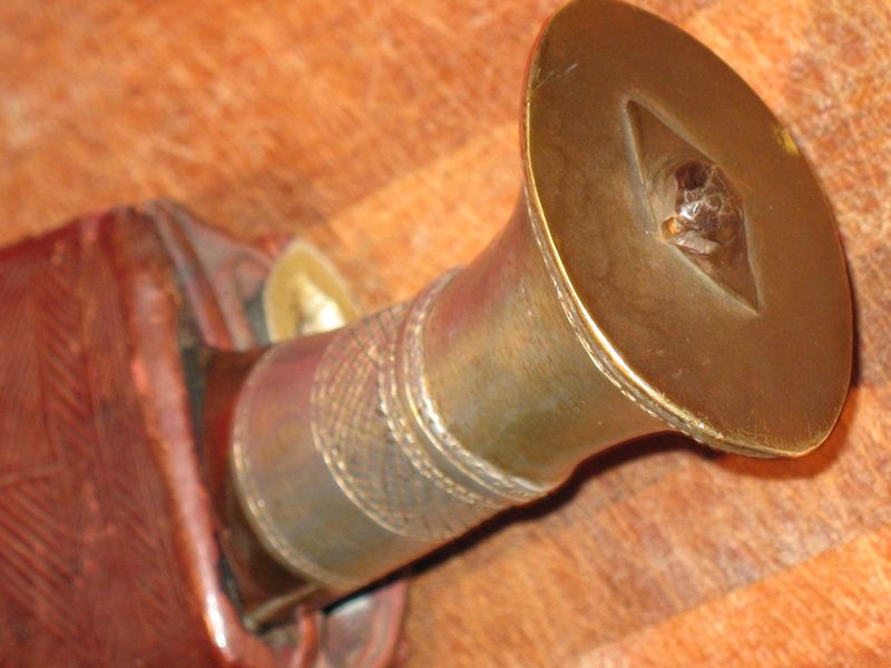

Me thinks you have probably not handled this kukri, it is not a steel bolster, and both have brass butt plates with diamond keepers
Not sure what you mean here? but both handles are decorated, albeit with different decorations
Certainley a different scabbard pattern, and better finished, but very much in the same vain.
It is strange how in your picture the scabbard looks black, or was the picture taken by John Powell and given to you?
And as I said originally
So not exactley the same

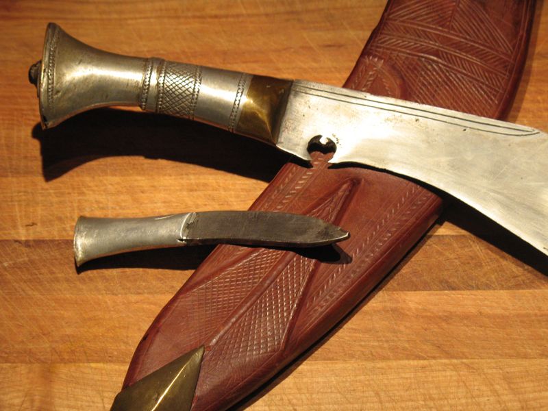

Sorry for that on your thread Asomotif , But perhaps you would like to see a large but very similar example of your kukri & scabbard type from Lionsgate arms & armour. {more decrative scracthed or chiseled blade markings though.]

Willem,heres another very similar kukri & scabbard from Michael long..
As you can see they do turn up. {at many varied prices of course.}
