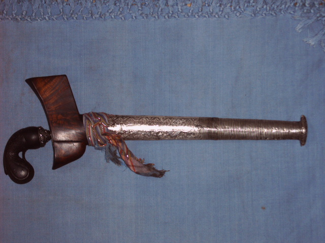

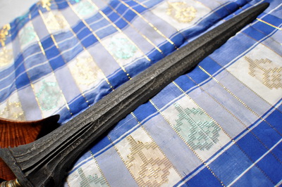

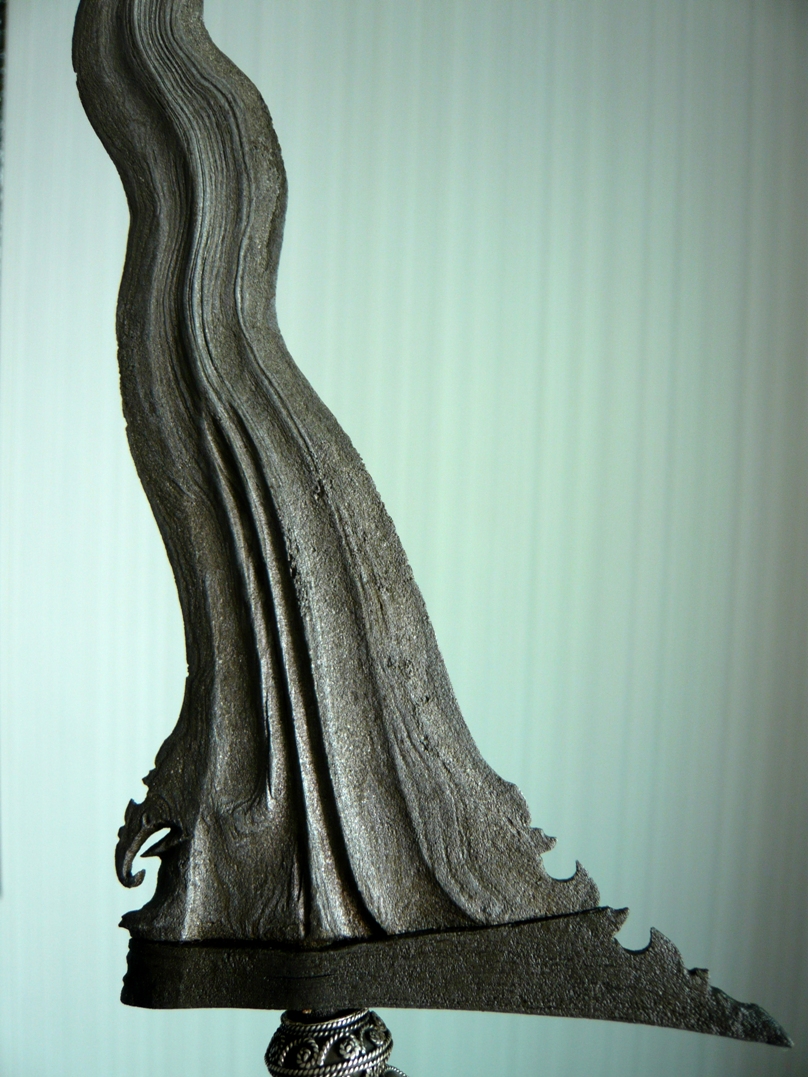

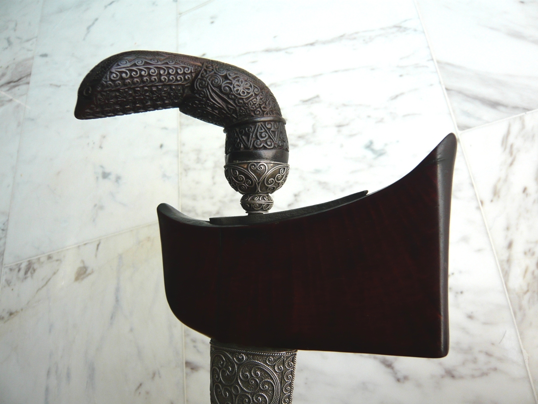

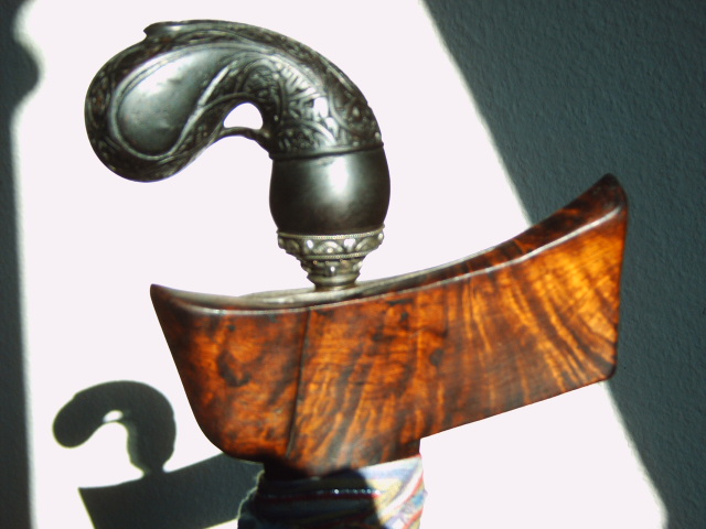

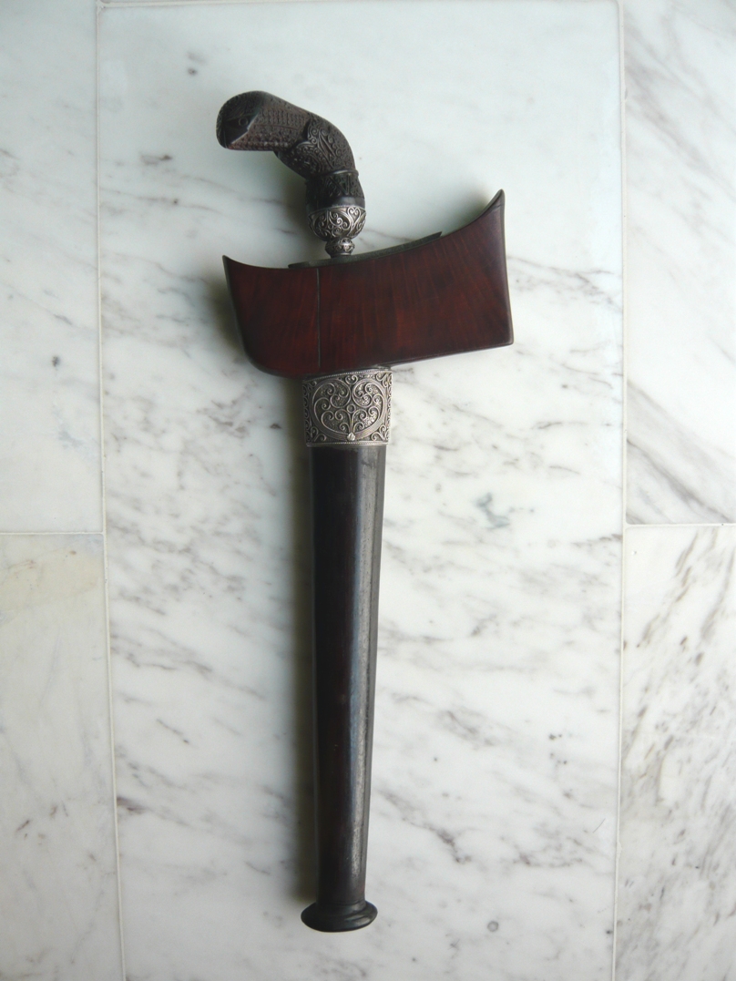

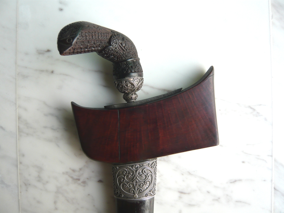

A keris from Sumbawa. The silver fittings with the twisted wire works are typical of the region, but not too gaudy. The hilt too, has motifs quite distinct from the Riau or Sulawesi Bugis. 15-waved blade, which seemed quite common in Sumbawa. Tough blade, with pretty tight adeg like forging lines.
Nice
sipakatuo is offline   Reply With Quote
Old 7th June 2009, 08:14 PM   #3
Posts: 7,303
Thanks Kai Wee. A beautiful and elegant keris.
Old 8th June 2009, 01:41 AM   #4
A very nice blade in a good sarung.

Very sophisticated indeed Kai Wee, thanks for showing this one. Does anyone else have examples from this island to show?

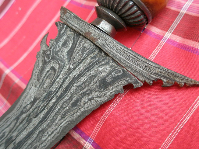

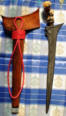

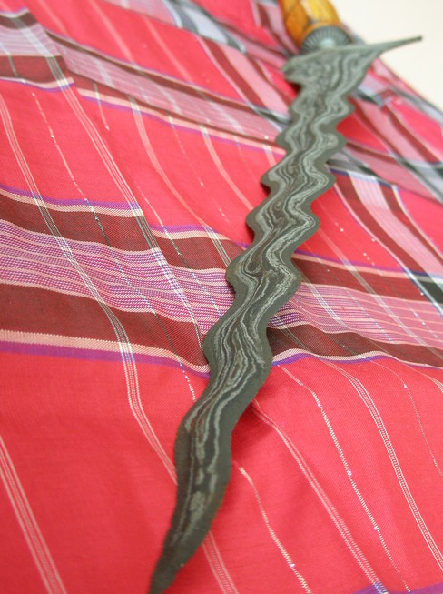

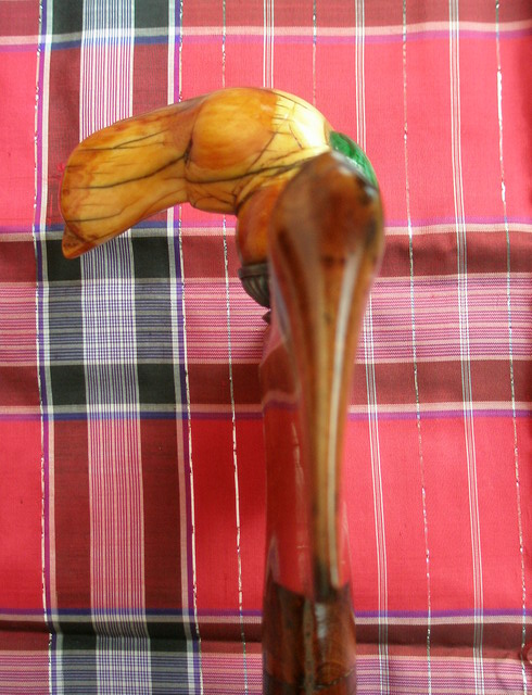

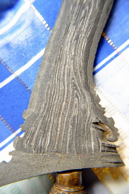

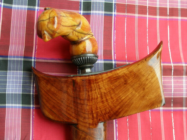

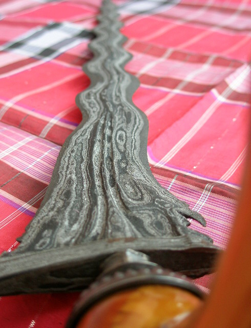

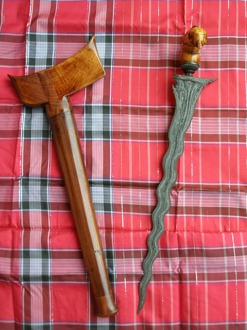

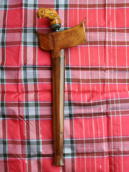

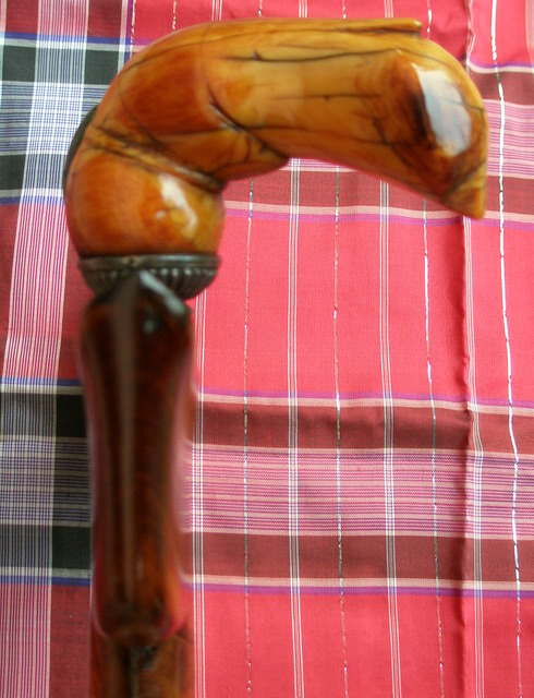

Another Lamba 15 from Sumbawa
Pangulu : Duyung / Sea Ivory
Kili-kili : Silver
Wanua : Kemuning
Pamorro : Ure Tuo

another beautifull keris.
What kind of material on the hit's back?
Old 8th June 2009, 12:32 PM   #8
sipakatuo
sipakatuo's Avatar
Join Date: Nov 2007
Posts: 59
Kamachite stone. Thanks Marco.

The embedded stone looks like Malachite to me.. Kamacite is a mineral, an alloy of iron and nickel, of meteoric origin..

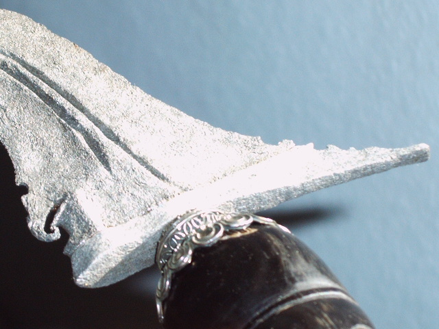

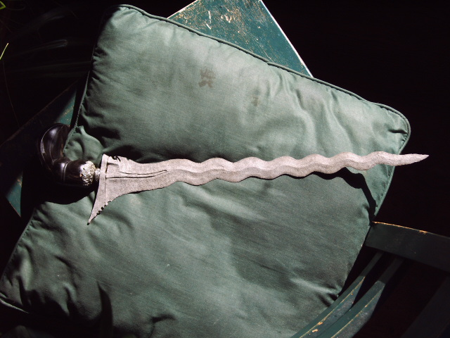

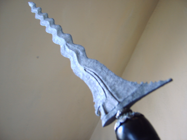

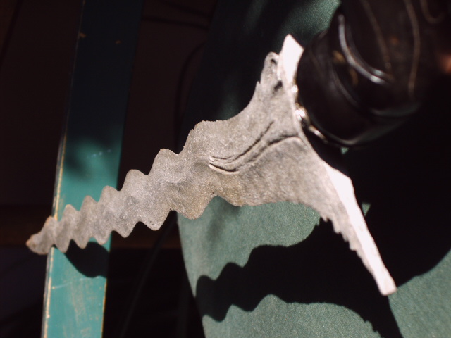

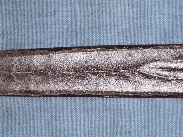

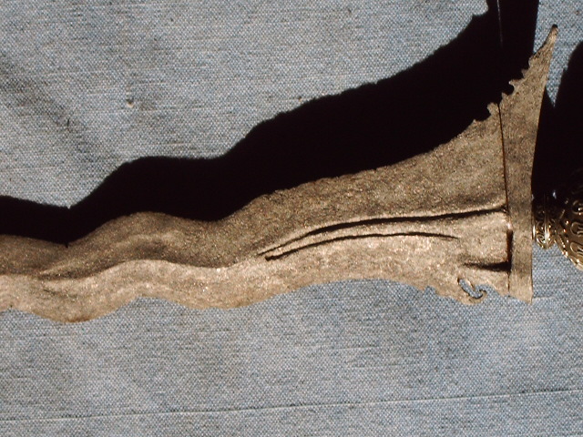

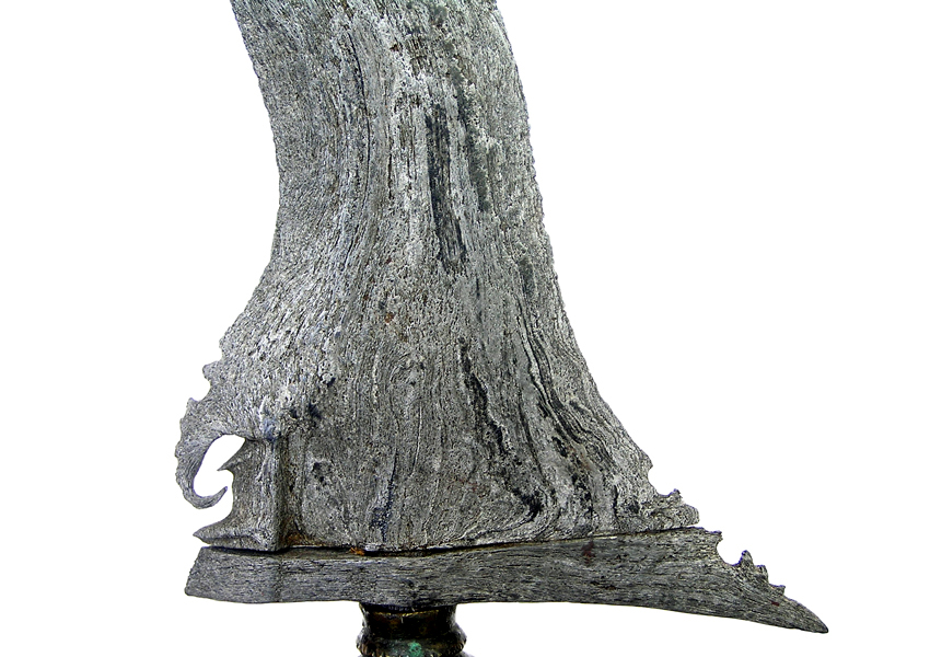

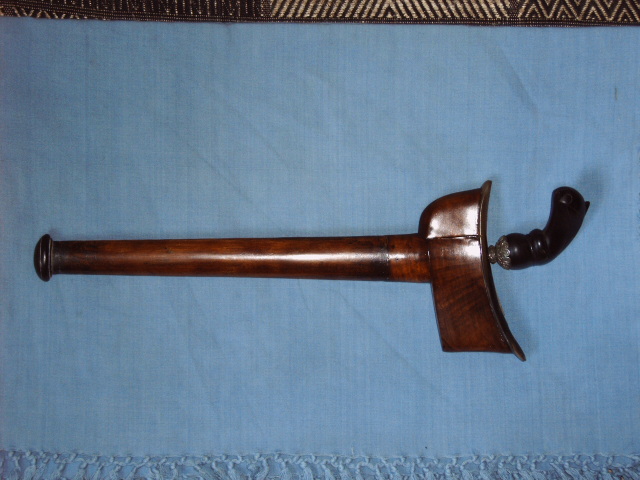

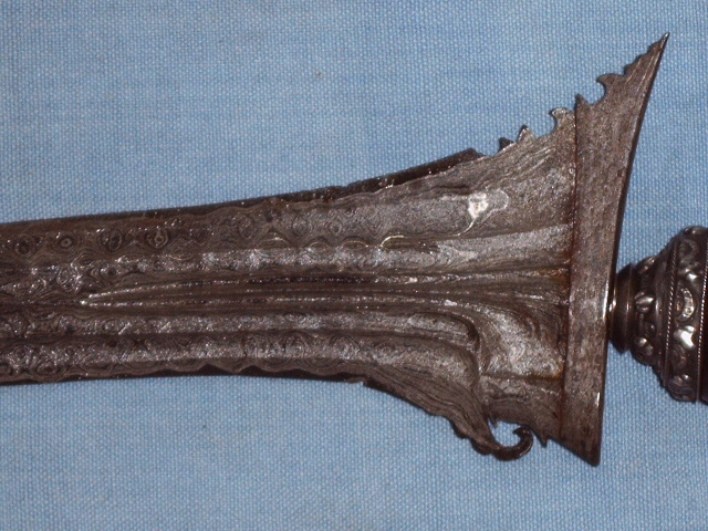

Another keris Sumbawa luk 15. A very simple blade with rudimental double sogokan, but the shape of luk still nice. The blade must have some age.
New hilt (made from horn) and pendokok, used sarung, hornen buntut.
Old 28th September 2009, 03:16 AM   #13

Nice keris Gustav.
sajen

It is of much less quality then the beautiful keris of Blu Erf and Sipakatuo, but this porous iron is typical for "lower end" Sumbawa keris,
thats why I posted it.

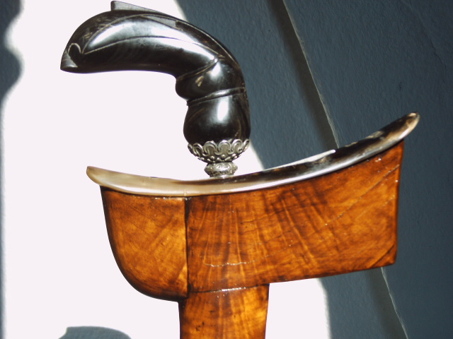

I also apologise for the very poor quality of pictures. The keris is also not stained, so even the low contrast pamor of this blade isn't visible in the pictures.

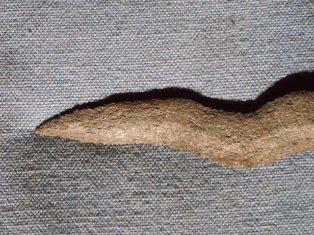

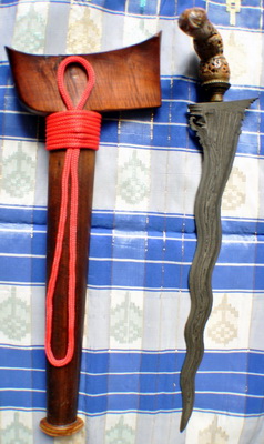

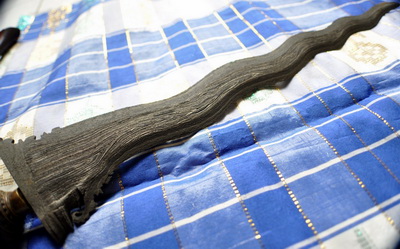

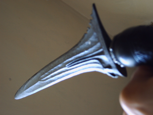

Some pictures of similar Sumbawa blades. These keris are not mine, so only detail pictures.

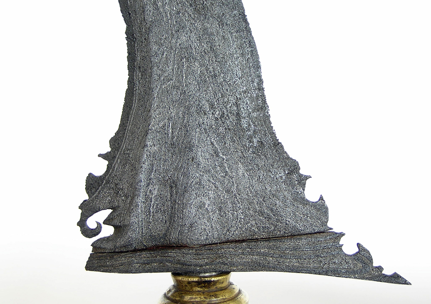

To begin I will say this:-
I have never been to Sumbawa.
I have not investigated Sumbawa keris in any depth.
My only knowledge of the type of keris used and worn in Sumbawa comes from old photos in general travel books, and keris that I have handled that were supposedly collected from Sumbawa. I say supposedly because the people who owned these keris were not close friends and I had no way of knowing if I was being lied to or if I was being told the truth. My feeling at the time was that in all cases I was being told the truth.
The type of keris that I understand to be a Sumbawa keris is one with a blade of no remarkable quality, rather inferior material with a sand-like texture, no distinct ada-ada, lacking the flat blade faces of a Bugis keris, but of a generally Bugis type appearance. Blade section is like rotan, the gandik somewhat indented to accomodate the kembang kacang.
There is a tangguh that is known as "Kupang". This does not mean that the blades come from Kupang, but only that they come from far to the east of Bali. The people who searched for antiques and etc to sell to dealers in Bali used to call these keris "Kupang" in the pre-1960 period, and that is where the people in Solo picked up the terminology from, when they would visit Bali they learnt from keris people there that this type of keris was "tangguh Kupang".
The characteristics of tangguh Kupang are:-
heavy, sand-like texture, usually no pamor, when it occurs it is only found in large keris, the steel is thick and well heat treated, the pawakan is large and approaches that of a Bali keris, the gonjo is wide & large & ugly, if there is greneng it is crudely executed, the gandik tends to be high, there is often a janggut, the kembang kacang is small & the lambe gajah is set deeply into the gandik, the blumbangan is very shallow, sometimes it does not exist at all, a sogokan is extremely rare when it does exist it is shallow, pointed and thorn-like, an ada-ada is extremely rare, the cross section is like rotan, there is no kruwingan, the waves when they exist are unharmonious and ugly, the wadidang is almost straight.
Remembering the keris I have seen that were reputed to come from Sumbawa, these indicators would in general fit.
The dress that these keris wore was of a general Bugis style.
I consider a keris to be a Sumbawa keris if the blade was actually made in Sumbawa and the dress is of the type usually worn in Sumbawa.
A number of keris have been shown in this thread and identified as being from Sumbawa.
Can anybody who has already shown these keris with a Sumbawa attribution substantiate that origin of Sumbawa?

Alan, thank you very much for the interesting post.
My blade and the two examples comes from dealers in Lombok. The two examples probably would fit in your description of Tangguh Kupang. Mine has a similar (sand like) iron quality, and is well heat treated. The measurements are:
The length of the blade: 36,8 cm (14,5 inches)
The width of the gonjo: 8,2 cm (3,23 inches)
I supposed, the little bit elaborated ricikan details of keris of mine and the striking ricikan details of the keris of Blu Erf and Sipakatuo would be a Lombok influence. But in the book of Lalu Djelenga I found a picture of two similar keris, on page 203 with a note "Banyak keluar dari wilayah Bayan". I suppose it means, the blades are coming from Bayan willage in Lombok.
I would like to know, is there a Lombok influence in Sumbawa?

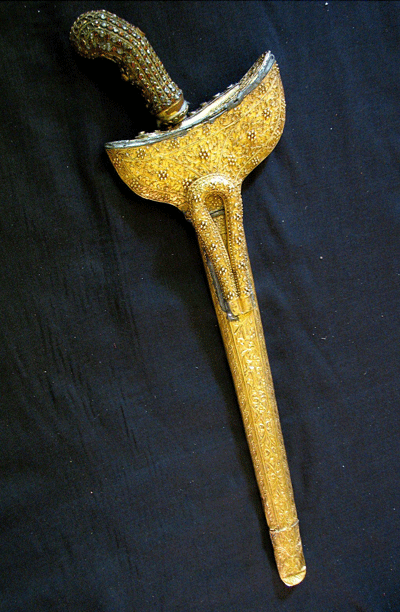

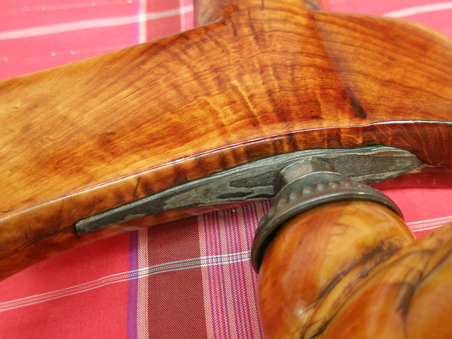

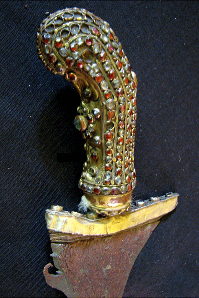

Some other pictures of my Keris Luk 15, and of a royal Keris from Sumbawa. It seems, Sumbawa has influences from everywhere. I will post also some pictures of a pedang from Sumbawa, shaped like a katana.

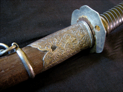

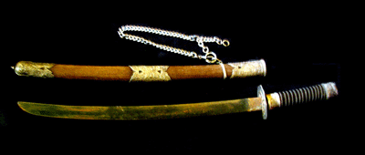

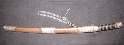

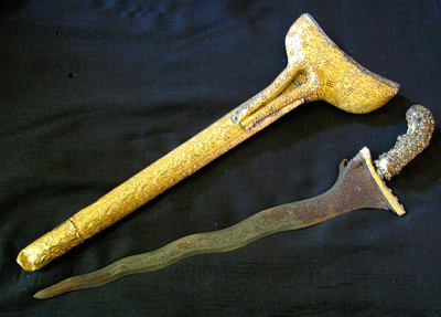

A pedang from Sumbawa.

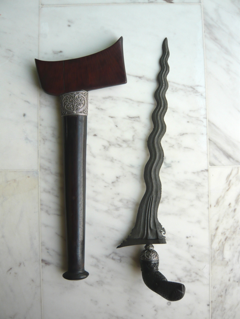

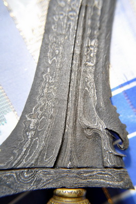

And a Keris of mine, attributed to Sumbawa, with triple sogokan. A similar Keris, sold in the Malay Art Gallery: http://www.geocities.com/keris4u/ker...kal_3sogok.htm
But I also think, the pamor of my Keris, a kind of wos wutah, is typical for Lombok.

Old 29th September 2009, 08:02 PM   #21
Is this royal keris yours? It remembers me to a Banjarmasin keris.
Old 29th September 2009, 08:43 PM   #22
Gustav
Join Date: Jun 2009
Posts: 1,346
No, no!!!
I am not a bank director!
Both, the keris and pedang, are from a museum in Sumbawa.
(I thought, it is clear becouse of completely other picture quality )
Interesting thing with the hilt is, it seems to be a Tunggak Semi, and the warangka looks almost Sumatranese.

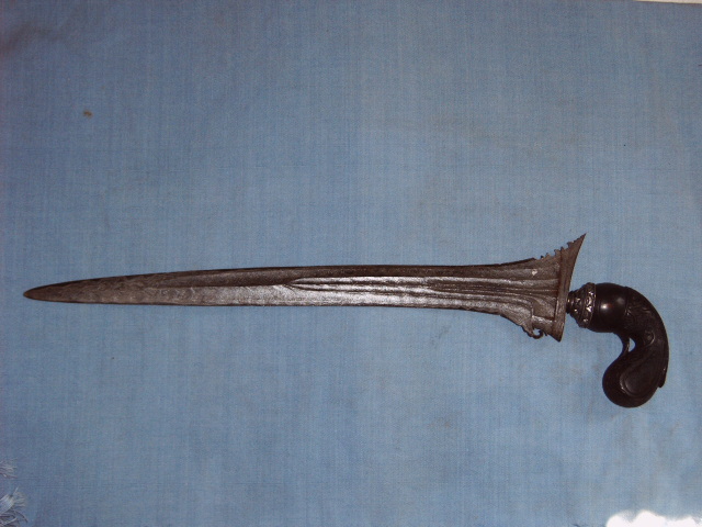

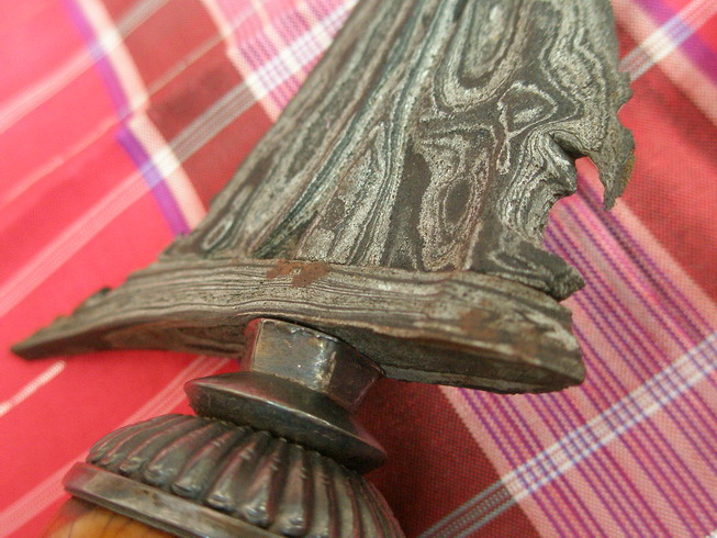

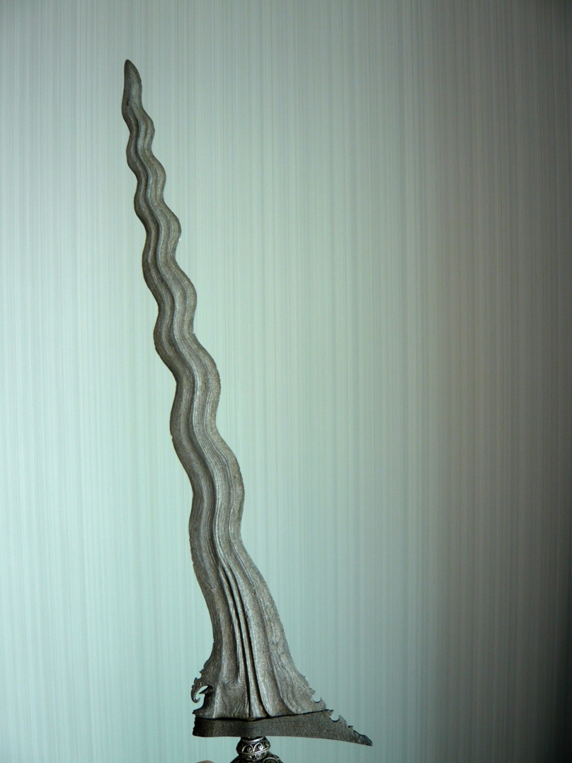

Another Bugis Sumbawa Kerisses for viewing..
Beautiful pieces with attractive pamor works.. thanks matteru..

Very nice keris Sipakatuo like your first one you posted also, but why is this a Sumbawa keris and not a Bugis keris? Or better from where you know that this keris are from Sumbawa?

I think that this is the question at hand Sajen and what Alan was saying in his earlier post. Are these keris really from Sumbawa or are we just repeating unsubstantiated information supplied by the sellers of these keris? Do any of these examples have any strong provenance that these blades were forged in Sumbawa?
