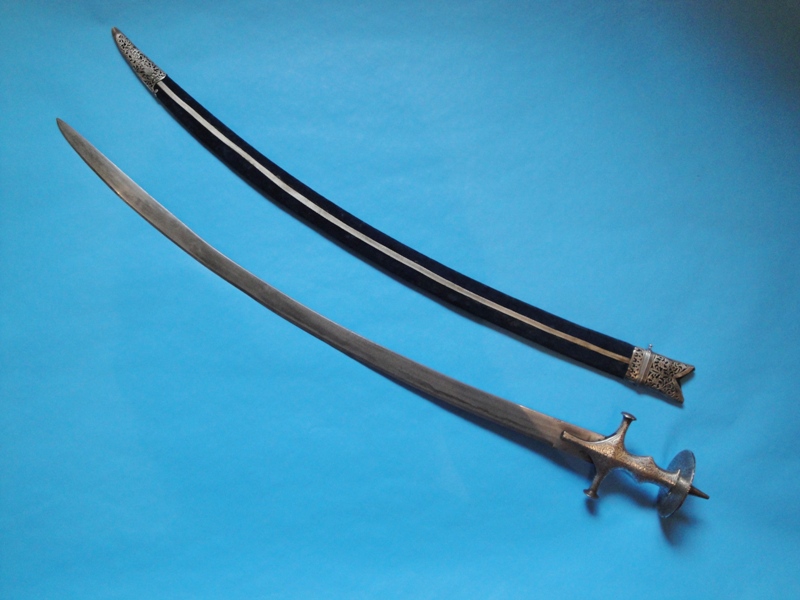

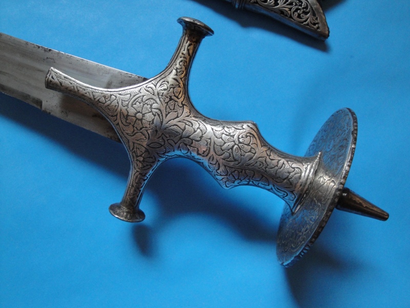

Picked this up from Artzi the other day. The blade is of very fine quality and the hilt has a very nice design motif. My question is what is the significance of the bumps on either side of the hilt?

Yes, I believe I very recently saw this one and I must admit that I found it most tempting and attractive. Sorry that I missed seeing you; I made a fast one day trip with a friend.
I would speculate that the swelling in the grip is intended to improve the grasp of the handle and perhaps limit turning of the blade in the hand.

Nice tulwar Louie, I am sure Lees reasoning is totaly correct.
To me its grip shape also suggets a Sikh or origin most likley?
But others much more expierenced than myself with tulwar will/would know much more.

Hi Lou,
Really nice looking Tulwar. The hilt design does look quite awkward to hold but I have one similar, in shape not quality, and I was pleasantly surprised at how comfortable it is in hand. As Lee suggested it does afford a good grip and I can feel how the shape would help in countering the tendency of the sword to twist and turn. The British 1788 Pattern Heavy Cavalry sword has a round grip and was criticized at the time for this tendency to twist resulting in a slap rather than a cut, this shape of grip would certainly help in negating that problem.

Nice sword Louie.
Always liked the slim blades without too pronounced a curve. How's the feel and balance?

Originally Posted by Atlantia
Nice sword Louie.
Very solid and nicely balanced hilt is small for my hand but I can still wield it with not too much trouble.
