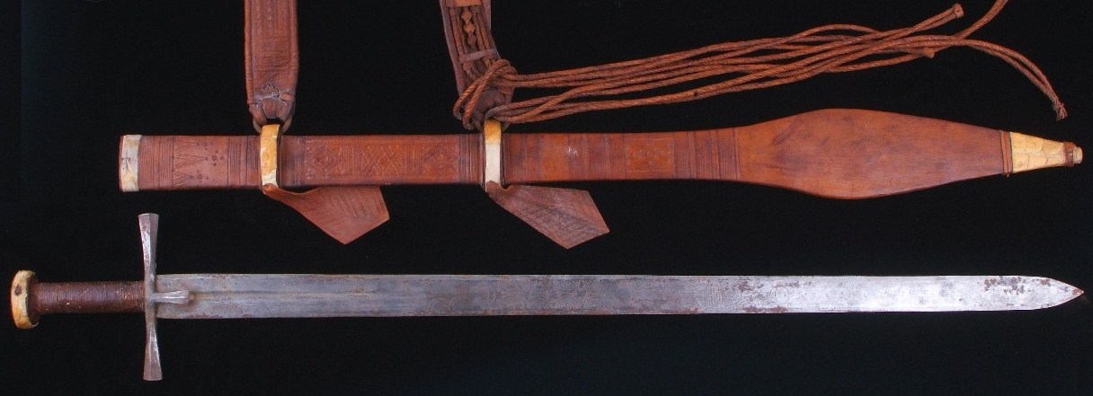

An interesting example - engraving to both sides of the blade, a nice scabbard with a double strap, good condition overall....
Quite similar to this one and this one.
The silver-hilted one in Christopher Spring "African Arms and Armour" appears quite similar too.

Looks a fine sword, Stephen. Presumably it has received a new scabbard and leather hilt fairly recently.
Would be interesting to have a translation of the Arabic script.

Yes, all the leatherwork is relatively new and supple. The joins on the scabbard are glued - older scabbards tend to be stitched. I wonder about the significance of the "leaves" and the long cords on the strap. Similar, longer attachments are found on Manding scabbards I think...The inscriptions is said to be a well-known Koranic verse which translated approximately says "...if God is on our side nothing can harm us".

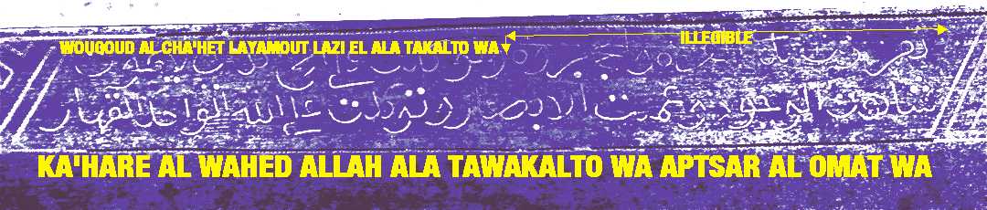

Hi Stephen
a little more precisly
the 1st lign is part (first sentence) of the verse 58 surate "Al Furqan"
" .... WA TAKALTO ALA EL LAZI LAYAMOUT CHA'HET AL WOUGOUD" either in English; "AND TRUST THOU IN THE LIVEING ONE WHO DIETH NO".
the 2nd sentence; certainly extracted from the Holy quran, but I didn't find exactly the surate
" WA OMAT AL APTSAR WA TAWAKALTO ALA ALLAH EL WAHED QL KA'HARE" either in English; "WITNESS FOR OUR TIME BEING, THEIR VIEW IS BLIND, GOD IS UNIQUE AND ALWAYS VICTORIOUS".

Old 9th October 2009, 02:57 AM   #12
Dom
Dom's Avatar
Join Date: Oct 2005
Posts: 1,142
Originally Posted by Dom
wrong message,
mix photos, and then pic and translation are not for the "kaskara", sorry Stephen
Hi Stephen

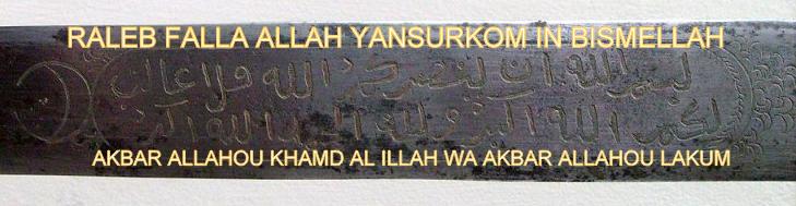

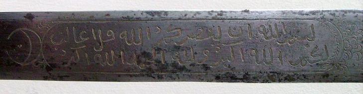

Old 9th October 2009, 03:15 AM   #13
Dom
Dom's Avatar
Join Date: Oct 2005
Posts: 1,142
Hi Stephen ... now your right translation
I'm realy confuse, and deeply sorry for that mess
- BISMILLAH IN YANSURKOM ALLAH FALLA RALEB (lakum) either in English IN THE NAME OF GOD WHO IS GIVING THE VICTORY WHO IS (INVINCIBLE)
- LAKUM ALLAHOU AKBAR WA ILLAH AL KHAMD ALLAHOU AKBAR either in English (invincible) GOD IS THE MOST GREAT WHO IS UNIQUE ALL THANKS FOR HIM GOD IS THE MOST GREAT
à +
Dom

...actually, I thinks it's one of the nicest I've handled - it has pretty much everything you would want to see on a kaskara. The leatherwork is particularly well done and it does have the mysterious second strap...
