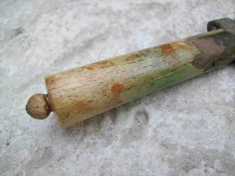

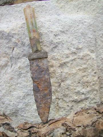

Gentlemen,
The knife from the attached pictures has been found in North-Western Bulgaria. To me, it looks like a short seax, but I may be wrong and I would be very interested in your opnion on its appropriate identification.
The hilt looks like ivory. Does anyone know if it is normal for ivory to get this greenish hue after being in the ground for a while?
Finally, my friend who owns it wonders what is the best way to preserve a blade in such a condition? Should he try to conserve with phosphorus or would some kind of lacquer be more appropriate?
Thank you in advance for your answers,
Teodor

looks very seaxy to me! the ivory could have picked up some copper salts from any brass or bronze (the bolster/guard possibly?) in the area, looks like the green starts at the guard and works it's way up the grip....
maybe looked somewhat like this when it was a bit newer:

Hi Teodor,
As to conservation, there is only one truly professional way to save the piece once and for all.
Put the item just the way it is right away in a water proof box and cover it with distilled water. The water should be renewed daily until no more bubbles can be noticed arising. By then, all the obnoxious yellowish salt particles should have been washed out.
Next, thoroughly dry the piece in an oven at ca. 150° Celsius for about two hours and let it cool down.
Then make a watered solution of tannin, a yellowish powder available at drugstores, and let the item rest in that solution, completely covered, for about 24 hours; turn it around one or two times. Take it out and rub it dry and there will no more problems arise whatsoever.
The method you suggested is purely chaotic and bound to destroy the item in the long run as the salt particles will unharmed remain in the metal and continue their destructive work beneath the lacquer or wax layer. Any acid cleaning will lead to heavy substantial losses and ruin the surface irrevocably.

I do not think the grip is actually of ivory, it is most probably staghorn or bone instead.
I have often seen excavated bone grips turned green, mostly from copper oxidation (verdigris); maybe the iron sleeve at the base of the grip is copper or brass brazed.

Let the bone covered hilt stick out of the tannin solution, otherwise it will get blackened.
