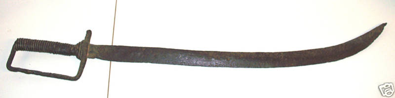

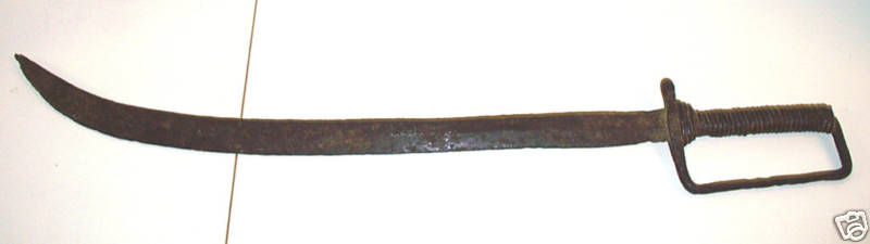

On my meager budget, decided to bid on this old piece. What attracted me to it was its primitive construction and iron-ribbed grip on the hilt. IMHO, I suspect that its Spanish colonial, blacksmith-made. The bent iron stirrup bar hilt places it late 18th/early 19th. Ribbed iron grips like this also appeared in this time frame and were associated with boarding cutlasses and such (the M1803 started this patterning and numerous "private purchase" sea service swords copied the ribbed iron grip pattern in numerous ways). As far as I'm aware, no swords prior to the late 1790's had swords with ribbed iron, but that is why I'm posting this- to see if anyone knows of any examples I am unaware of?
Likewise, I know there's not a ton of proof that this is a naval piece (primitive iron, ribbed grip, darkened patina from salt corrosion, perhaps? ), but I think it's a strong possibility. Opinions?

Nice acquisition!!! and extremely interesting. I think most of your observations are pretty well placed, and would agree with the period end of 18th c. to opening of 19th. This gives every impression of a private purchase hanger that reflects the construction style and features of the early British cutlasses and customs and other type service departments, from what I recall.
It does seem to be simply fashioned in almost 'blacksmith' grade, and the elements of the hilt are much lighter and less defined than the usual products. What strikes me as Spanish colonial is the blade, which has the characteristic uptick of the blade point as often seen on espada anchas of the end of the 18th century and into the 19th , this one more dramatic. The hilt however does not correspond to the usual guards on these, but leans more toward the British style. It is always tempting to consider another entry among the widening array of anomalies that seem to be associated with the "Spanish Main' of the Caribbean and Americas of this period.

Just future proofing this post with some images of the sword
Gav

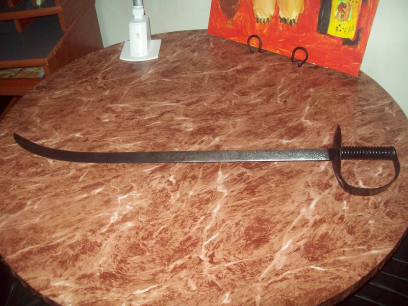

Pics of iron hilts...

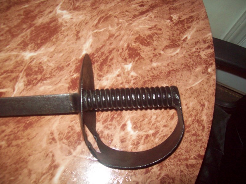

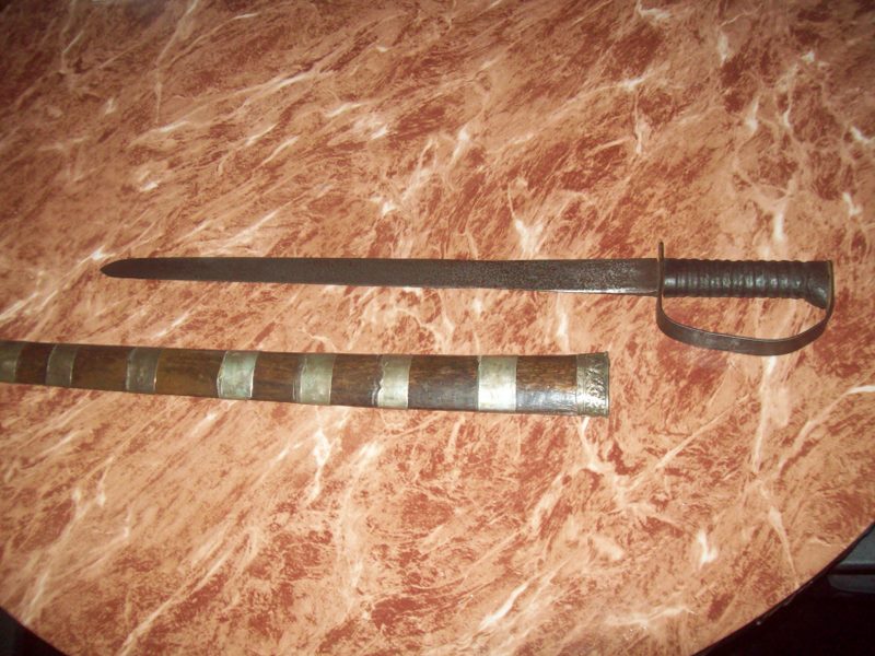

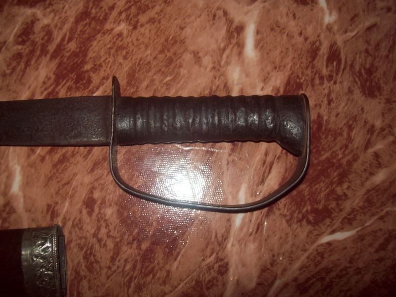

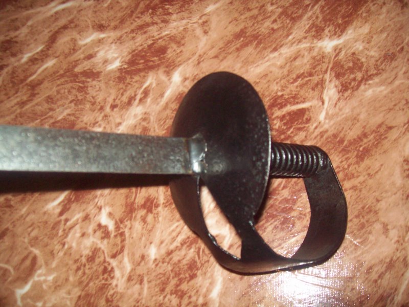

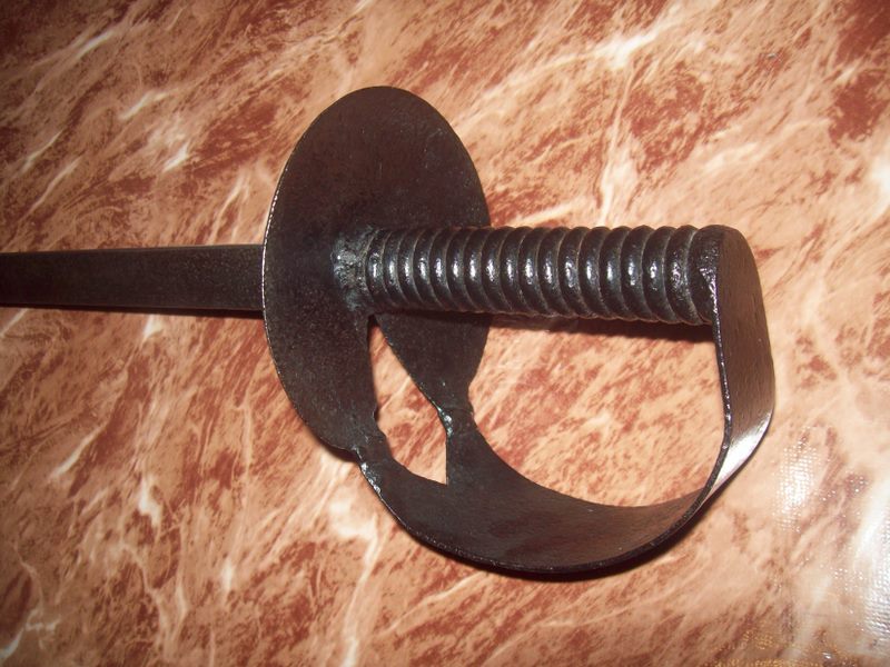

Finally got the pics to load. The top piece is a mystery to me. It generally resembles a m1845 British boarding cutlass that has been realtered or it is another one-off copy for private purchase use. Note the corrigated iron grip and odd construction of sword. The blade on this one is straight for almost int's entire length until the end, when it makes an abrupt curve (saw a few blades like it in Neumann. Rev War era??) This earlier blade was set into the fully constructed hilt and brass was poured into the empty space to set the blade. Opinions on this over the years have been varied; earlier period 1810s sword, m1845 knockoff, parts sword, etc. Opinions here?
Second piece is definitely a m1845 naval cutlass cut down and refitted in a Malay scabbard...can you say "pirate" Pictured here for comparison of iron ribbed hilt of later mid 19th century construction...

Gasp!!!! Wow!!! Mark............shiver me timbers, ya done did it!!
And these are fantastic, it sure looks to me like you've got 'privateers' cornered....and the upward curved blade in the British one. The new one has just gotta be Caribbean.
This grouping is outstanding

I think you are right that the new one is Caribbean. Very glad to add it to the collection. I know you are busy on the raod, but I was wondering what you thought of the top one? As I said, it resembles the m1845, but in other ways, it looks like some of the earlier ones in Gilkerson. Hard to tell with it's unusual pattern. Anyway, glad to have a handle on the original piece discussed. I mostly posted these to bring home the point of the iron grips, which until someone else disputes it, seems to have originated with the Brit patterns around 1790s.
