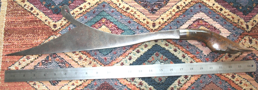

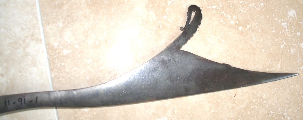

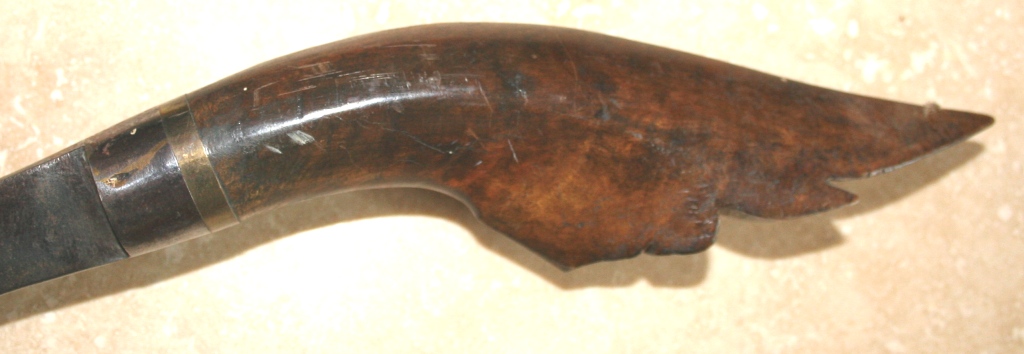

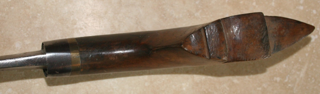

G.C. Stone refers to a weapon called a Parang Jengok, unfortunately with out a picture in his epic tome.
The description of it's use sounds a bit dubious but I suppose anything is possible
I am probably way off the track here, but is it possible that this is one ? I have never seen one, has anyone else ?
I realise that it would require the "hook" to be straightened out and that Stone says the projection comes from the end rather than down the back, but if it isn't one, then perhaps someone can tell me what it is.
As usual all comments will be greatfully received.
Thanks
Roy

Hi Roy,
it's a very nice Kelewang from Kelentan, Malaysia. Look inside "Spirit of Wood" on page 104-105.

Nice piece Roy, really interesting blade style.

That's a kelewang as Sajen mentioned.

Sorry,
I know nearly nothing about this parang, I only remember direct that I have seen this parang inside the book I write before. But I think that Alam clarify this already. But I can try to take a photo from the book later.
