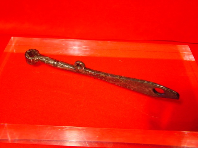

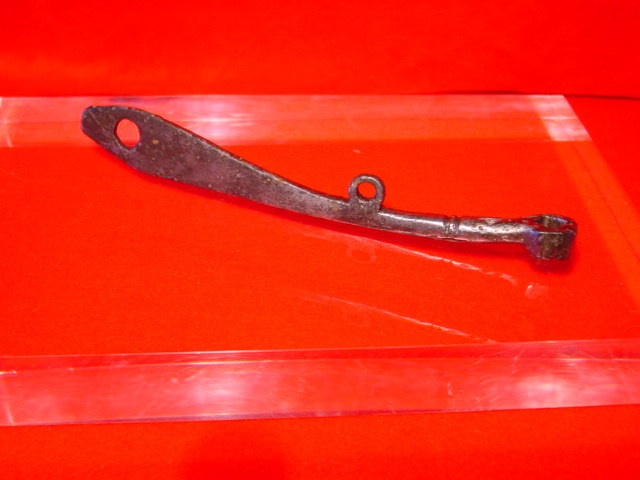

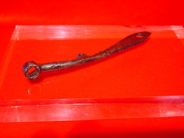

Hi All,
I acquired this wheellock spanner online and was wondering about the approximate dating of the piece. I have a wheellock pistol dating to the Thirty Years War with which the spanner pairs up nicely. The spanner itself is not particularly ornate, but it was a very reasonable price and certainly did not break the bank. I like the fact that both the pistol and spanner have a plain, martial appearance. The spanner is about 6" long and square opening of the spanning head approximately .25" wide.
Thanks for any input!

Hi there,
Not only is this a wheellock spanner but a combination tool, in that its flattened lower end acted as a screwdriver! The ring was for a attaching a suspension cord.
Moreover, the round hole was meant to measure and identify the caliber of the lead balls used (caliber gauge, German: Kugellehre); its small diameter denotes that the spanner once accompanied a pistol or carbine.
Tools of this kind can be dated to the Thirty Years War era (1618-48).
