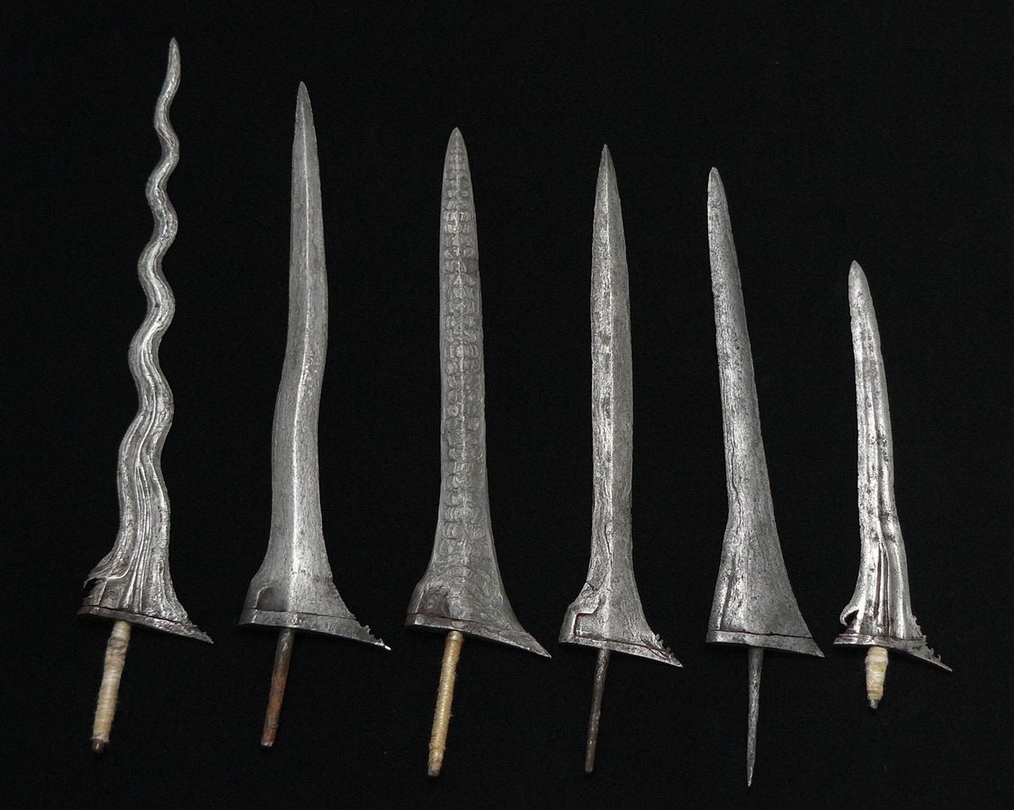

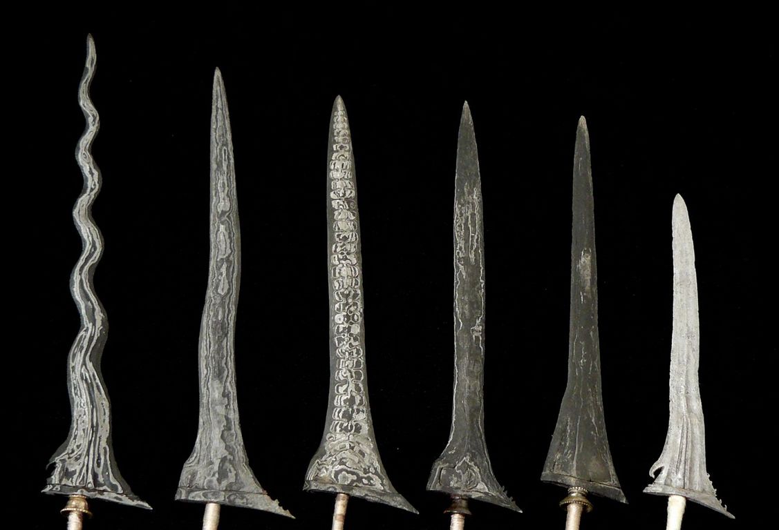

I realize that this work might look better in person and Jean has stated he photographed quickly, but to my eyes much is left to be desired in some of these. In the first grouping it does not appear that the warangan took all that well in the 3 blades to the right. The first and third from the left seem to have the best effect.

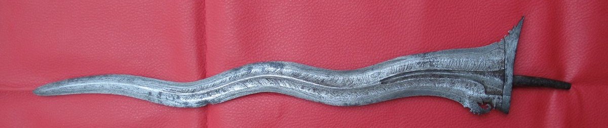

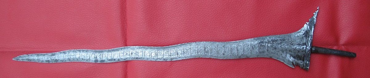

In the next 2 examples the last one seems to be pretty good, though i can't tell if the color is fading a bit towards the end of the blade or if that is a trick of the lighting.

Among the set of 6 blades, only the 3 on the left had relatively intact pamor but very indistinct, the one on the right is a Minang blade without pamor and was cleaned only, and the 2 others had very indistinct and worn-out pamor, the remnant of it being clearly visible after waragan even if the pattern does not look nice but there is nothing better which could be done! I am very satisfied with the results on the 3 blades on the left.

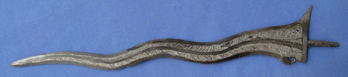

Regarding the 2 other blades (Bugis and Sumatra), they were a bit rusty and very dull, and the pamor was very indistinct (problably never cleaned since 100 years), and I was amazed to see the pamor contrast after cleaning and warangan. On the top one with pamor Lar Gangsir, there is no pamor on the ada-ada so this is why you see a black line in the middle (nothing to do with the warangan work). On the other one, the color is not fading towards the tip but it is an uneven lighting effect only (you can easily notice it on the bue background also)

One aspect which could be objectively criticized by some collectors about the blades which I showed after warangan is that the pamor contrast is too high and the iron color too dark, but I personally like it this way, and with time and repeated oilings the contrast is decreasing anyway.
About obtaining an even color result on the 3rd and 4th blades from the left which have little original pamor (one is from tangguh Pajajaran), I doubt that it could be achieved unless the staining is much milder and the iron would not be black in this case.
