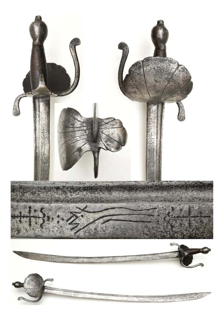

This sword had been in a close friend’s collection for many years until I purchased it from estate at Auction where it had been described as an early Riding Sword. The look and feel of the thing screams cutlass or sabre to me and I would be interested in your thoughts.
Date: Circa 1575-1625 (16th Century)
Nationality: German
Overall Length: 86.1 cm (33.9 inches)
Blade length: 73 cm (28.7 inches)
Blade widest point: 3.011 cm (1.2 inches) near hilt, 3.115 swollen tip (1.2 inches)
Hilt widest point: 11.6 cm (4.6 inches)
Inside grip length: 7.5 cm (3 inches)
Marks, etc: So called ‘Passau Wolf’ mark 16th Century, anchor marks
Description
Shell Guard Riding Sword c1575
The steel hilt has a very large upturned guard, styled as a sea shell, and a smaller shell with thumb ring for the reverse guard. The knuckle guard and quillion are of equal length and create a most graceful sweep through the cross guard. The pommel is of a large globular shape with pronounced tang cap. The grip is turned wood covered tightly bound brass wire that is now extremely smooth to the touch and black with age in patches. Steel ferrules are fitted at the top and base of the grip. The curved single edged blade has a single fuller running two thirds of its length and is marked with the 16th century version of the Passau Wolf and early German anchor marks. The blade swells slightly towards the tip.

Wow! An excellent example of a Dutch clamshell saber from the 17th century, indeed used and favored by the buccaneers and seamen of that era. i don't believe despite its size that it was used as a cavalry piece. There is much similarity with the so called Sinclaire sabers and I know we're discussed this type before. Jim is an excellent source of info on these, if we can drag him in!

indeed a beautiful Dutch hanger but not 1575 but 150-200 years later , from the 18th Century.

I also looked at the Dutch Hanger in Sim Comfort’s book but the shell and pommel configuration of this particular sword appear earlier to me. It actually compares more closely to the one featured on page 5 EW5 and this blade is also of German manufacture.
Personally, given the blade on this sword I struggle to accept that the cutlass is as late as the 18th century. The sword does not appear to be a marriage of earlier blade with a later hilt; they appear to have been together for a very long time. The balance is wonderful it is simply a pleasure to hold.
Does anyone know how long these Dutch Clam shell cutlass’s where around, and when they first started to appear. There is a lot of variation out there in the shell design and some of the other Dutch ones I have seen are far cruder than this one. The ones featured in the link do not look to be as old as this one. I actually have a Rapier with a similar shell guard, so it looks like the design was utilised across Europe for an extensive period.

I think my example is also one that has clearly employed a Solingen blade, hence my initial thoughts in agreement with that of the previous owner is a date being late circa 1500s or early 1600s. The particular wolf mark and anchor marks support this and as suggested the hilt appears consistent with the blade. No issue with it being Dutch though, until I looked through Sim Comfort’s book I was unaware of the Dutch cutlasses with shell guards.
I think, when my friend (sadly now deceased so I can't ask him) originally dated this sword he used Dufty as his reference (see attached exerts from Dufty and Peterson). It certainly looks strikingly similar and has a very similar German blade. I have been looking for a reference book on early Dutch arms but all I have found in one on Firearms at this stage. I will start collecting examples for my data base and as I am currently scanning every book in my Arms and Armour library perhaps I will come across other examples in the process.
So at this stage we agree it is not a riding sword and it is a Cutlass, age still up for further debate I think. I am leaning toward 17th century but can’t convince myself it’s as late as the 18th with that blade.

Other similar hilts in the Gravensteen Gent Belgium and also one sold in Czerny's
Best
cerjak
