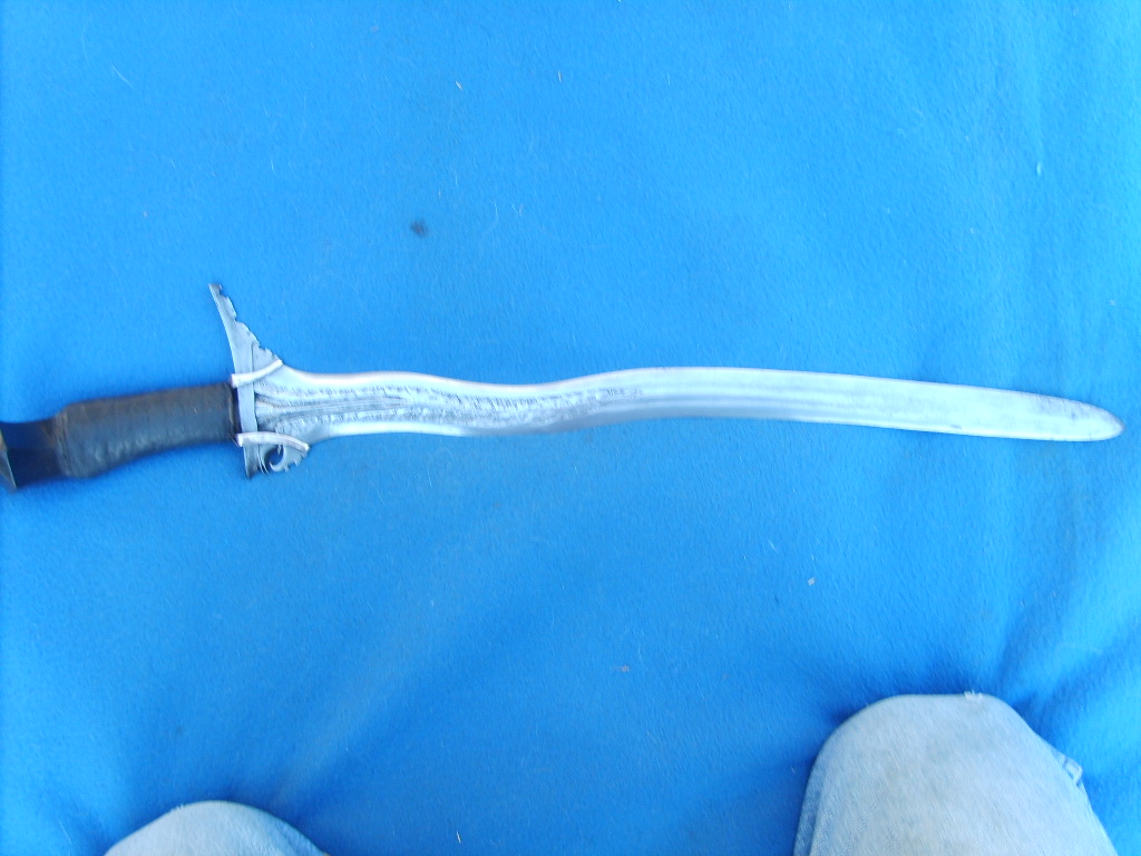

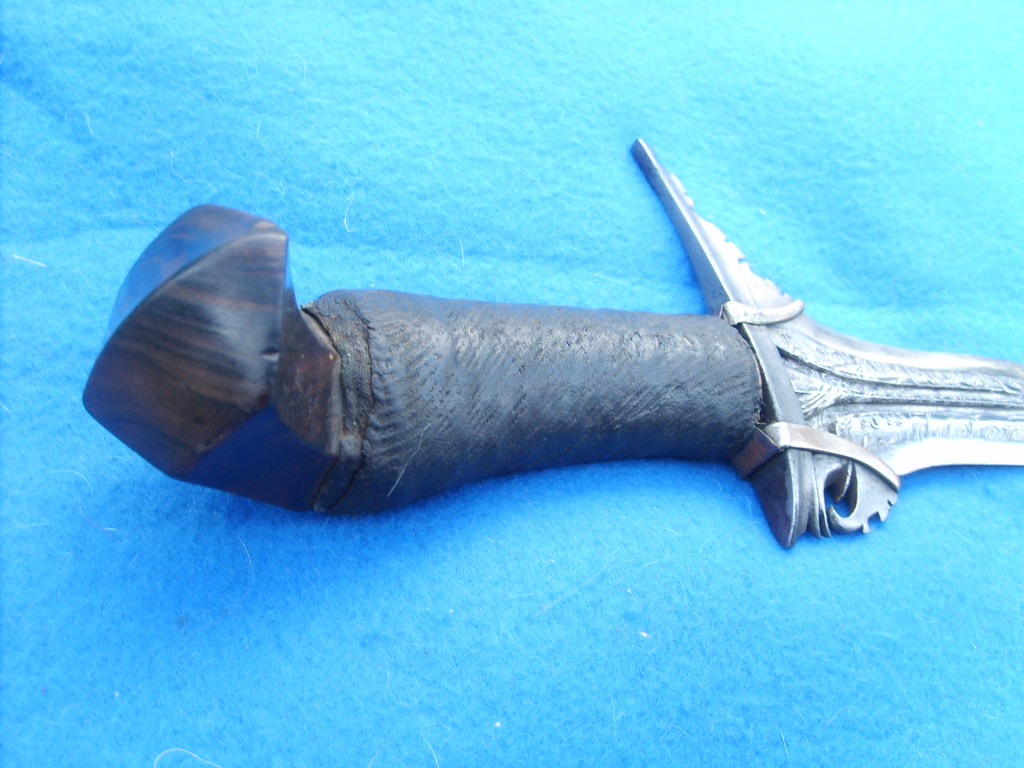

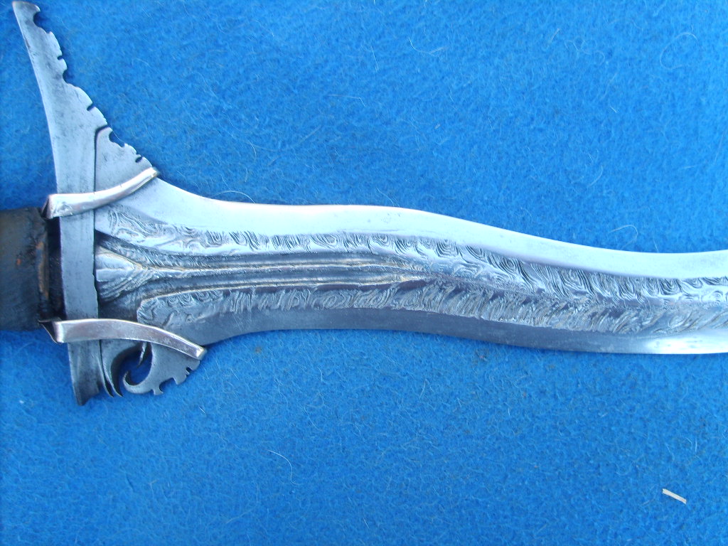

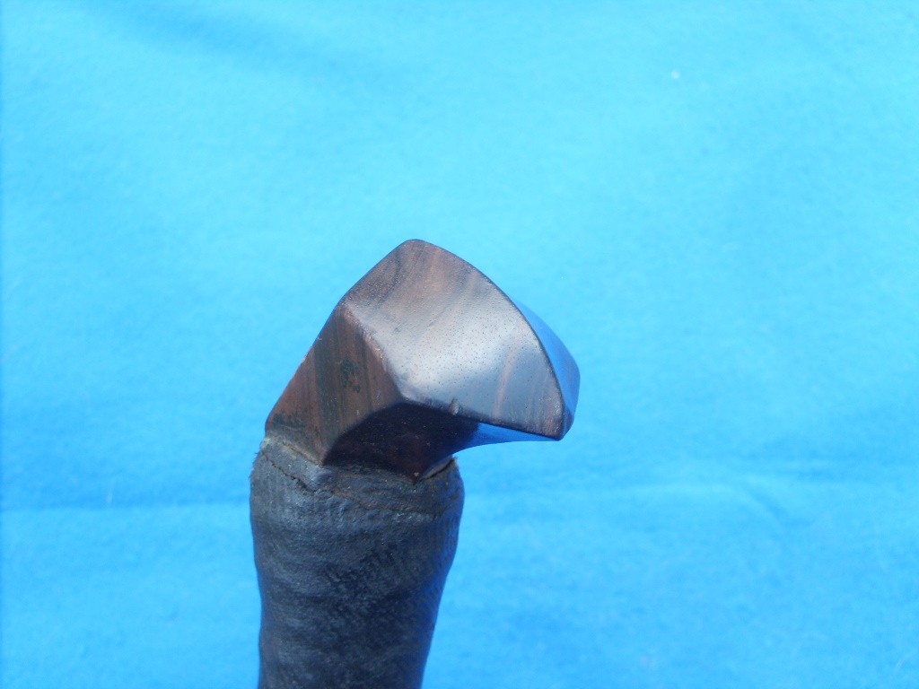

Here is another twist-core i picked up a few years back. This is the
second one i have seen with an offset garuda style pommel. The blade is
19 inches long, 25 inches overall. The pattern is exactly the same on both
sides. No scabbard. Some patterns like this seem to be etched in,while
others seem to look like threads of nickel like an Indo-kris. has anyone ever
figured out how these are done????.......Dave.

[QUOTE=DaveS Some patterns like this seem to be etched in,while
figured out how these are done????.......Dave.[/QUOTE]
Actually both are the same, the first ones are topographically etched, the other not. Newbold (1839) describes topographical etching of kerisses from Malay Peninsula:
"Place on the blade a mixture of boiled rice, sulphur, and salt beat together, first taking the precaution to cover the edges of the weapon with a thin coat of virgin wax. After this has remained on seven days, the damask will have risen to the surface; (...)"
Also the Madurese blades are sometimes topographically etched.

I was fairly sure that the first kind of pattern was done with a deep
acid etch, but the second type with the threads of nickel has to be con-
structed the same way as any type of Indonesian pamor. I can't see that
it could be done any other way.........Dave

oncemore -
both kinds (actually there is only one kind) are done like a normal Pamor from Indonesia or Malay Peninsula, using iron with some nickel % or some other element, which would react differently with acid.
The difference here is only the method of etching - topographical (like described by Newbold - a strong etch) or a normal one.

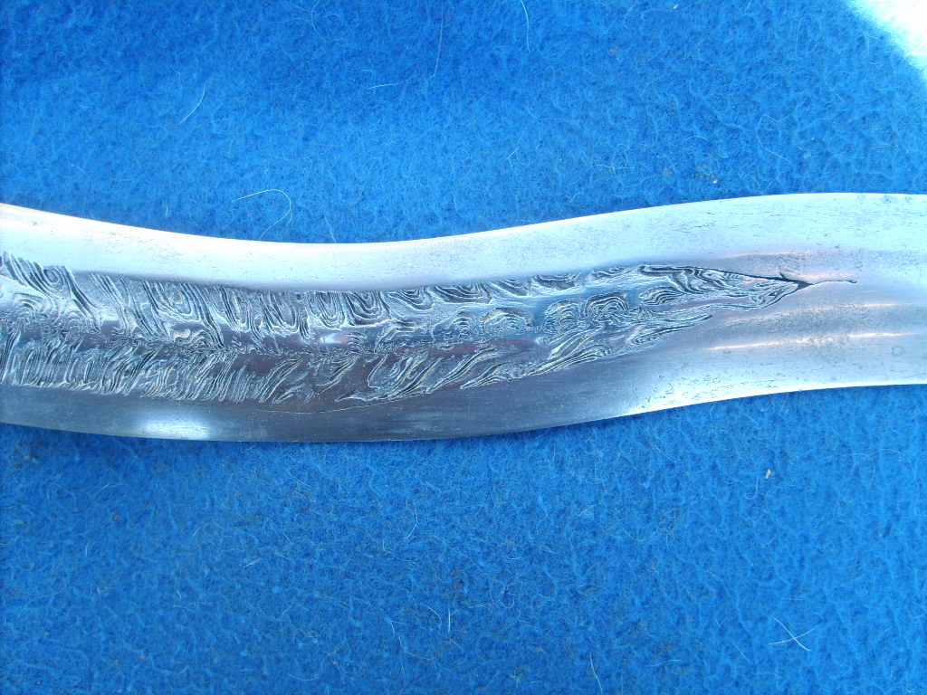

Old 8th December 2013, 04:53 AM   #16
Posts: 7,302
Originally Posted by DaveS
Jose: I have used a high magnification lens and examined the valleys made by the etch. I see no evidence of nickel pamor at the bottom of these valleys. I can't see how these two techniques are the same if nickel threads can't be seen at the bottom of these valleys. Somehow i think we are talking about two different ways that this can be done.
At this point i think i need a bladesmith with experience in making damascus to maybe explain this.........Dave.
Dave, you do realize that nickel is not necessary to create a contrasting pamor pattern in keris making, right? Are you familiar with the research conducted by Bennet Bronson on this subject?
Old 8th December 2013, 11:23 AM   #17
Gustav
Join Date: Jun 2009
Posts: 1,346
valleys.
Dave:
I will give it another try and be more explicite, as I see, this question really bothers you.
There are very rare twistcore krisses, where the pattern and welding are so perfectly done you can't tell difference between a pattern created by simple etching or a real pamor at first glance. I very much like your kris, Dave, yet it doesn't belong to this category.
Please take a look to the picture below: the marked area on the left side clearly shows the twisted bar leaving the topographically etched middle fuller. Actually the Pamor here is very clear, despite the polished surface.
The marked area on the right side shows a forging flaw, which is where the twisted bar meets the core. The welding failed here.
I don't understand very well, what do you mean by the sentence:
"I have used a high magnification lens and examined the valleys made
valleys."
I understand it like the bottom here is without any pamor activity. I don't recognise these places to a sufficient extent on the pictures, yet these most probably would be the places where the twisted bar has been forged or chiseled or etched through and the core has been exposed.
Actually for this information you don't need a blacksmith, becouse this is ABC if you really are interested in pamor techniques. By chance I have had conversations on the matter of pattern welding with a smith, who is quite well versed in twistcore techniques.
To recapitulate the forging&topographical etching matter: the sentences regarding topographical etching from the book of Newbold are handling exactly this subject. The pattern welding technique with subsequent topographical etching (including wax reserve) absolutely isn't something unusual and rare, not only in Philippines and not only in SEAsia.
Gustav
