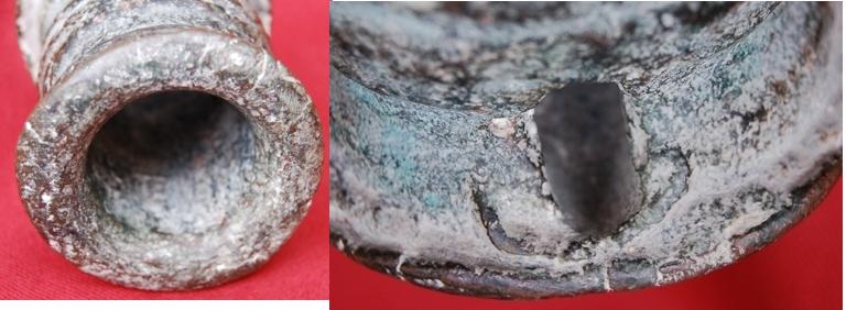

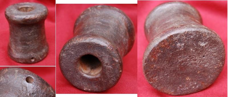

These two are taged as bombards, said to be mounted in articulated devices, but i guess they are more fit to be upright signal mortars, specially because those well defined bases.
One is in bronze, the other in iron. They have similar reduced dimensions, less than 10X10 centimeters.
The one in bronze, dated XV century, has that traditional lip on the fire hole, so often seen in vertical signal mortars.
The one in iron is dated XVI century. It has a much narrower bore.
Bore measure not mentioned in either example, though.
What do you Gentlemen make of the bombard definition, as well as the date atribution ?

Hi Fernando,
Let me please thank you for posting that really important thread.
I must admit that I have almost never encountered any more detailed differentiation than the one you gave us to tell "bombards" from "handguns": the first are usually identified by their traditionally added lips or priming pans, as well as by their notably swamped rear ends which so to speak seem to have predestined them for standing upright when being fired. That may also account for their more familiar names, such as "little noisemakers" and Böller (German alpine regions). On this basis I should suggest a date of 16th-18th century for your copper alloy cast piece.
The second sample illustrated by you may even come from the Aljubarrrota battle field (Portugal, August 14, 1385). I should like to back up that assumed provenance as, like in on the example in my collection, the small touch hole is placed near the rear end and the overall appearance of the little barrel is apt for being fixed to an iron stick stock by iron bands.

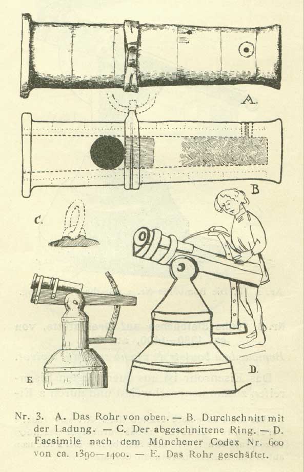

To be more precise and trying to 'upgrade' my first introduction, besides the different age and historic/geographic active life given to the two different pieces by such website, their purpose is similarly described, as having both been mounted as cannons (so to say); the way the mounting is described is quite intrincate (in castillian) and, if i well understand, is not far from the attached illustration, that i stole from Pope's work ... rather than trying to technically describe it myself.

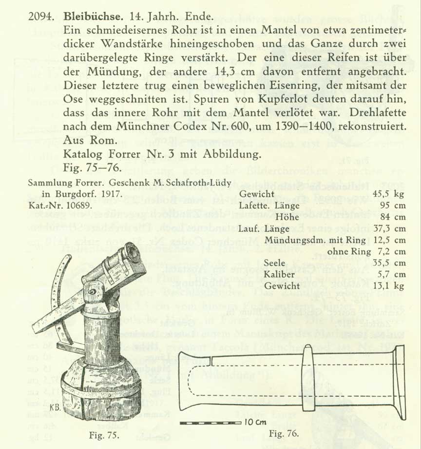

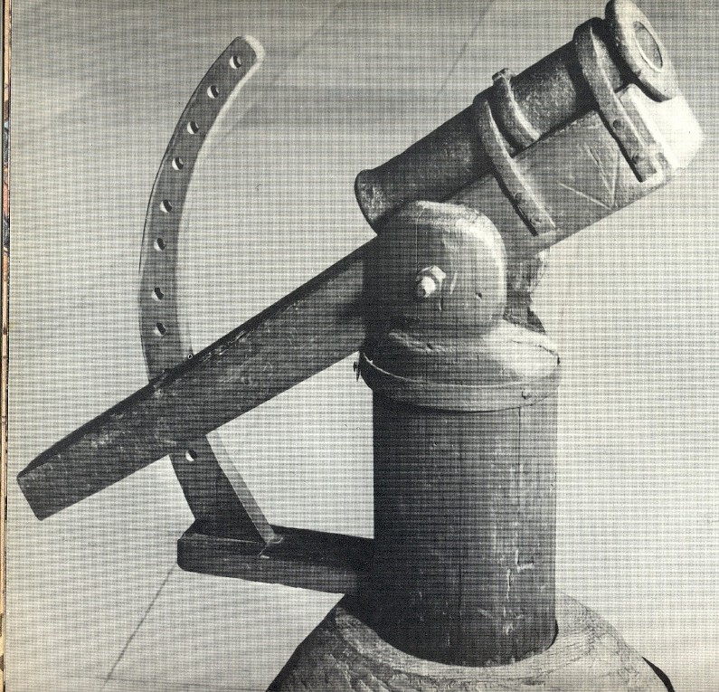

The photo from Dudley Pope's Guns depicts a heavy wrought iron gun barrel from the former Robert Forrer collection which is now at the Historic Museum Berne, Switzerland. All the wooden parts are late 19th century reconstructions but in correct historic shape.
I should say that the barrel with is pronouncedly reinforced muzzle and almost no staging present is really a very early piece, late 14th century. The sectional drawing shows the bore of very early form, and the measurements are taken from the Berne 1948 inventory. Forrer noted that the barrel was still loaded with powder and a lead ball, so he called the piece Bleibüchse (lead gun), in differentiation from contemporary stone firing barrels.

I forgot to add that the central reinforment of the Forrer/Berne barrel bears a fragment of an iron ring which is now missing. The original use of that ring is left to speculation.

I also forgot to mention that - highly curiously - this Berne barrel actually consists of two wrought iron tubes, the thinner one placed inside of and copper soldered to an outer one about one which is centimeter thick (0.40 in.).

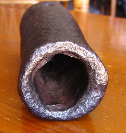

This reminds me that my hand cannon is also made in two parts; only in such case the inner part is a thin sleeve.
I will take it with me to Lisbon this weekend, to try and find out whether this was a regular procedure or, in the best probability, define its provenance by that particular detail.

It's pity that my humble, inferior Aljubarrota barrel consists of only one single layer ...
