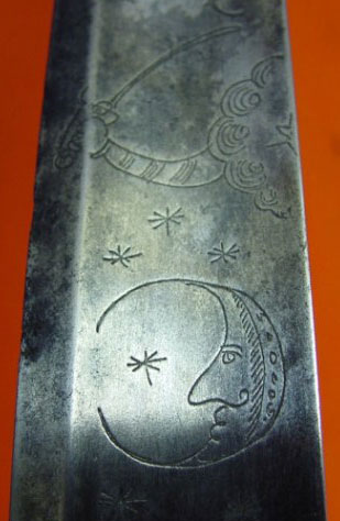

Ok, does this change things?

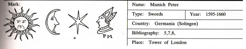

I'm probably the most ignorant of all of you, but it looks like Solingen's sun and moon motiff to me.
