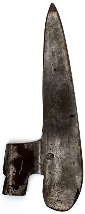

Hello everybody,
has anybody ever seen this stamp before?
I bought some time ago this heavy berdiche head but don't know how old it is and the origin. Germany ?
Kind Regards

Yes, a Christian symbol referencing Jesus. The cross and crossed bones also indicate this. Likely a wood cutting tool, especially if the blade is offset/off center from the socket, which seems to be a case here. Jesus was a carpenter, so this could be why such stamp was used.

Google "Austrian Goosewing Broad Axe" and you'll see many similar. There's one currently listed on a popular auction site with deep cross mark similar to yours. They were mounted on short wooden shafts and used as wood cutting hatchets. Yours is Austrian or possibly German, 18th-19th Century. Well made and with interesting and quite rare mark.

I also discussed the axe with someone who knows more about them, and based on form he thinks it is earlier, possibly 17th-18th C and also possibly used to be a weapon before being modified into a hatchet.

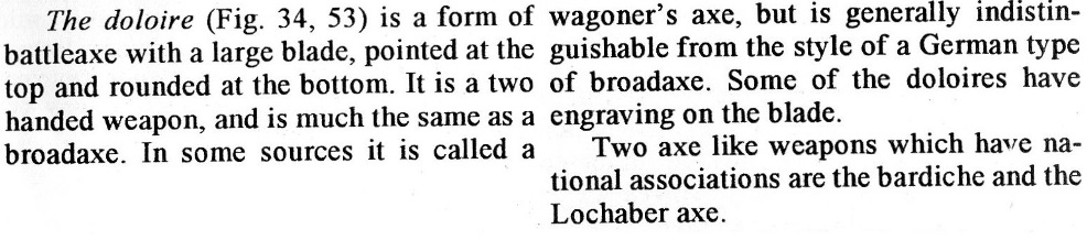

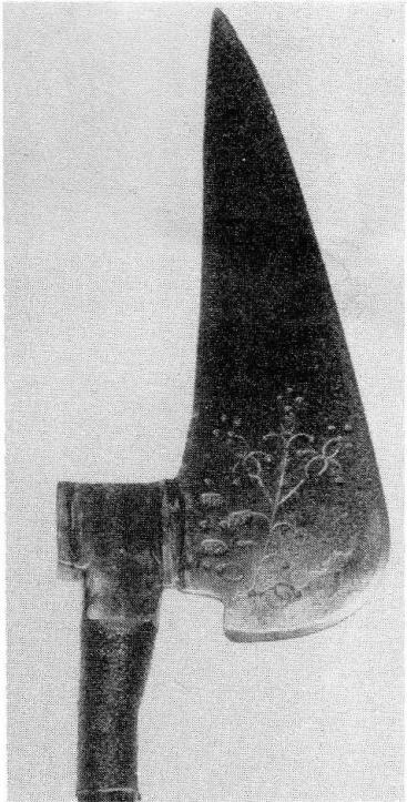

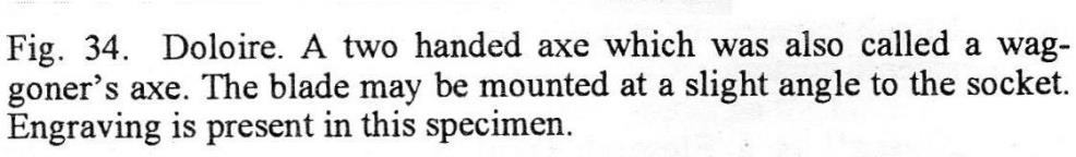

Should we compare francantolin's example with a Doloire shown in George Snook's publication ... and read what he says abouth these axes.
Old 13th May 2017, 09:38 PM   #10
francantolin
Posts: 973
Thanks a lot Fernando !!
I found these informations,
seems to be an Austrian axe ''tool''/ weapon called Doloire:
