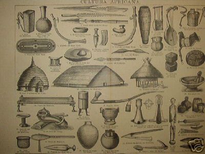

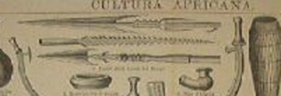

Question Another spear tip
Hello friends, here another spear point (sorry for the bad picture). Mine is the first pic and the second i have found on the web and it's identical to mine. I think Mangbetu, but I don't know it with certainty. Please help me
Old 18th May 2005, 10:51 AM   #6
Freddy
Freddy's Avatar
Posts: 830
Arrow
According to the book I mentioned above, these barbed spear head come from tribes in the northern part of the area occupied by the Zande tribe in Congo (close to the border with South Sudan). The Mangbetu also have barbed spear heads. But..with Mangbetu spears the spear heads are quite small.
These were used for light throwing spears. The shaft was a simple wooden stick, sometimes with som iron banding at the end (as counter balance).
