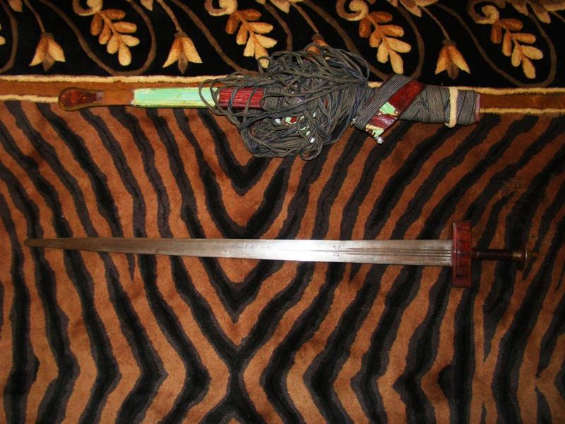

This seems to be old ... i wonder if 19th century.

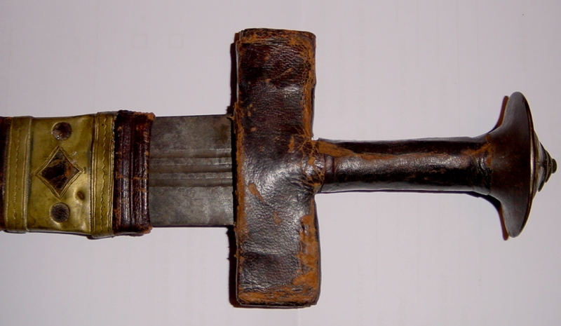

Blade is 82 cms long, 4,5 cms wide and 3,5 m/m thick. Three fullered, double edged, sharpened to within 15 cms from the hilt. The usual two half moons in each side.

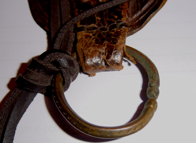

Scabbard visibly original; pitty the end 'complex' is missing. One suspension ring and the leather baldric are home made.
Gentlemen, your coments will be so much welcome, namely on its possible age and provenance region.

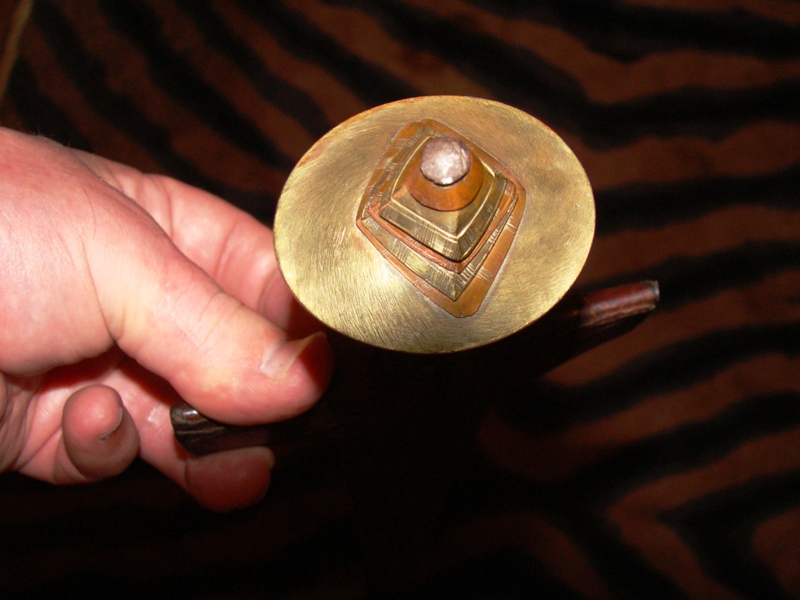

Another question i have goes for the grip size. We can see often discussed the size of Indian hilts, namely talwars. It happens that the hilt of this takouba is so small that my small hand struggles to fit in its grip, having to acomodate tightly to its pommel 'shelled' curve; is this the intended idea, or were Tuaregs also a people with small hands? I doubt it though, as it seems other examples appear to have larger grips, as may be seen, for example, in this Forum Resource Site article. I also doubt it is a boy's sword, judging by its regular blade length; this meaning i ignore if Tuareg youngsters would qualify to carry a sword, like in other cultures.
Thanks in advance for your kind input.
Fernando

The 'takouba' is the fascinating broadsword of the fabled Tuareg warriors, Ihaggaren, of the Sahara, and the history of these swords is as mysterious as these warriors themselves.

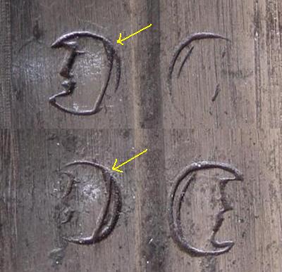

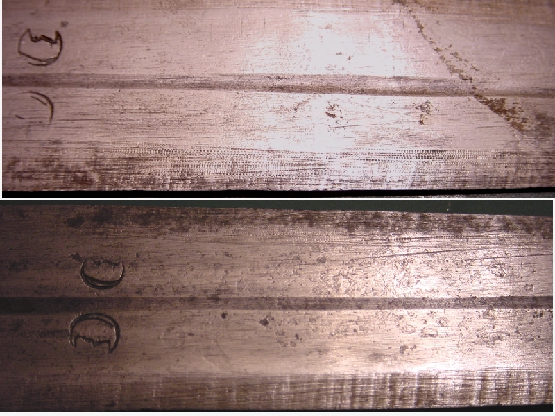

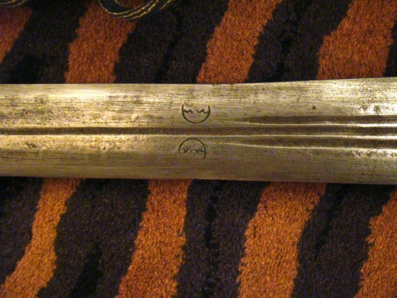

Yours is a sound example, and clearly in 20th century mounts, while the native blade may be latter 19th century. The treble fullers central to the blade recall European blades that have come into these regions over the centuries, as do the degenerated, stamped crescent moons. These are apparantly common in the Eastern Sudan with Hausa type swords and termed locally 'dukari' (Briggs, p.58).* These 'dukari' twin half moons have become virtually standard on takouba blades across the Sahara, and obviously the style has transmitted via nomadic movement, tribal interaction and trade.The moons themselves are copied from these markings on a number of European blades traded to these regions.
According to information found in Dr.Lloyd Cabot Briggs "European Blades In Tuareg Blades and Daggers" (Journal of the Arms & Armour Society, Vol.V, #2,1965 ) it would seem that stylistically your example is likely of 'Central' form which would comprise roughly Ajjar,Ahaggar and often the Air region.
I know that this is not precise, but these are nomadic tribes, and it would be virtually impossible to gain specific provenance unless obtained and documented from a tribesman on location.
While tribal warriors still wear thier takoubas as a matter of traditional costume, they are of course armed with modern weapons (as can be well described by Lee Jones.
One thing I would like to bring up as a case in point. Over many years, I have tried to find the source for the term takouba, which of course included in the Tuareg vocabulary. It seems that the Portuguese were likely the earliest purveyors of European blades to the Tuareg tribes of the Sahara, and the influence for the broadswords may derive from the Almoravides of Spain as early as the 11th c. These early connections of course are broadly applied, but the Iberian note is key in my opinion.
In Mexico City in 16th century New Spain, the Moorish custom of grouping craftsmen of similar work in the same area, and for the metalworkers, including those who fashioned weapons and blades, there was a thouroughfare known as the CALLE DE TACUBA. In time, metalwork from there became known as 'de tacuba'.
While this is clearly an entirely separate region, I would like to know if there is any possibility that the application of this Spanish name or term might have been grafted into Tuareg parlance with traders supplying blades into Morocco.
Just a thought
All the best,

Back to my takouba example, i see that you didn't coment on the short length of the handle; was it because nothing occurs to you on the subject ? Also in the mean time i have read that Tuareg youngsters could gain a takouba by the time of their puberty.
Concerning the age of both blade and sheath, XIX century for the blade suits me fine; however XX century for the sheath leaves me a bit sad, as i am 'alergic' to modern stuff. In fact i have read in Lee Jones article that hardly takouba sheaths may be found with a long age, due to their quick degradation. Even so, i hope my example is quite old within possible, that is, from the early times of the XX century. I am based in the fact that its leather material has shrunk so much that, even inserting the blade with some mussle, a good 3,3 cms. (almost 1 3/8") remain unsheathable. Also worthy of note is the (one surviving) elaborated suspension ring, made in decorated brass, with an interesting patina, instead of those in aluminum, a detail quoted in Dr. Lee Jones's article to indicate a mid XX century solution.
Kind regards
Fernando

My lack of comment on the handle was an oversight, and it does seem that many of these do have unusually small handles. It does seem that native individuals did have smaller hands in many tribal regions, though that argument for small handles has met with great debate in the tulwar case. In looking at clothing, shoes and all manner of apparal of earlier times, it does seem people were smaller (heaven knows I could never get into my high school clothes!). I just read an article on the pgymies, and much notation on nutrition, lack of certain vitamins, diet etc. which accounts for thier size.
I think the smaller size hilt may suggest earlier 20th century, as well as the brass ring etc., you do present a good case, but I wouldnt go earlier than about the 30's. It really is hard to say, as it doesnt take long for leather to draw tight, even without being in the elements in the desert.
