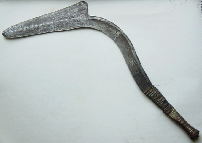

We have been here before. You need to look harder and examine more quality pieces. Superb quality can be found. As to layering, I am certain metals of various carbon content were mixed when available or needed but any visual signs of layering that I have found just seem to be incidental to forging the work. I have big macho spears all the way down to small blades like the old safety razor blades. When I have time I will post pics. Looking at some work, before the introduction of trade steel. There is the most ingenious use of form and fullering to achieve strength with minimum use of steel, if not rare, then certainly expensive and hard won. A different kind of bigness.

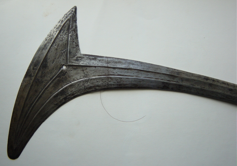

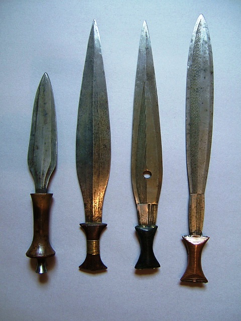

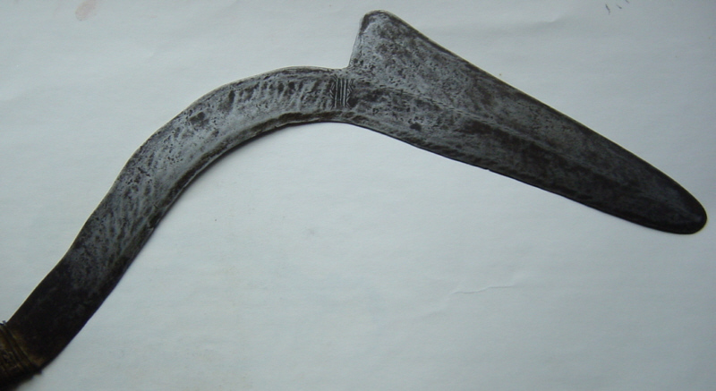

Default Thousand km south and east

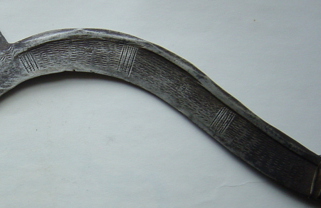

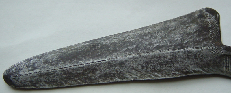

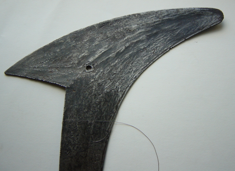

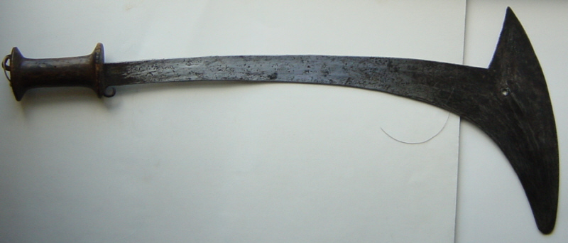

If you down load these pics and examine magnified. You will see a form of layering. Believe me this is tempered. I am sure that if I were to etch the surface, patterns would appear but only incidental. The spine of the spear is over 1cm thick. I think one has to develop more of an eye with African pieces

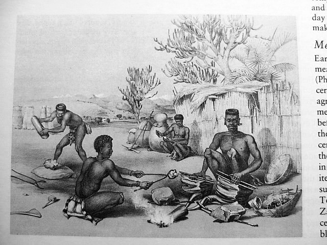

still im interested about the tools they used ,
does anyone have any pictures of the equiptment of a 19th centuary blacksmith of this area?

So far as short blades vs. long blades, I think the problem is the size of the anvil. I know that two-handed swords (either European or Japanese) were hard to make, and hard to temper properly, because they were often too long for the forge. If you've got a small forge, short blades are much easier to make.
Ditto with complex shapes and tempering. Something with complicated curves and cutouts is going to heat unevenly, and it's going to be hard to temper evenly. I would expect perhaps spot hardening (as on a kukri edge) at best.
One problem we haven't discussed is the issue of history. Most of the African blades we see are post-colonial in origin, and most (not all!) were not produced for war. Here's an analogy. Imagine that the only European swords you saw were produced around 1900. How would you judge European sword culture? Probably, you'd figure that swords were minor and ceremonial weapons, as all the blades you could find were badly made (compared to, say, a 14th century sword) and poorly used. Because Africa doesn't have a great historical record, it's somewhat hard to judge how good African swords were or could be. All we see are the modern ones.
Just a thought,

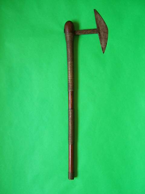

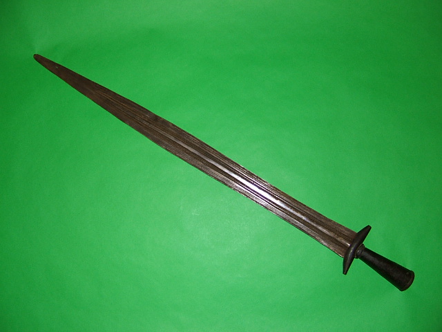

Question interesting
I would have bought this book but have my eyes on other things. I have snatched this picture though.

This is a nice weapon. The beak is 26cm long, not a toy and anybody could pick it up and fight with it. So you see some super things yes?. Lew and I have done so well without Danny, Freddy, Luc and others sure there is more to follow huh
