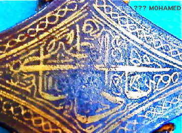

I wonder if the inscription on the guard is in Arabic or Farsi...that may go a long ways towards answering the question....can anyone make it out??
to have a chance to read the inscription on the guard
- no flash
- macro focus
to read, because the translation it's an other story

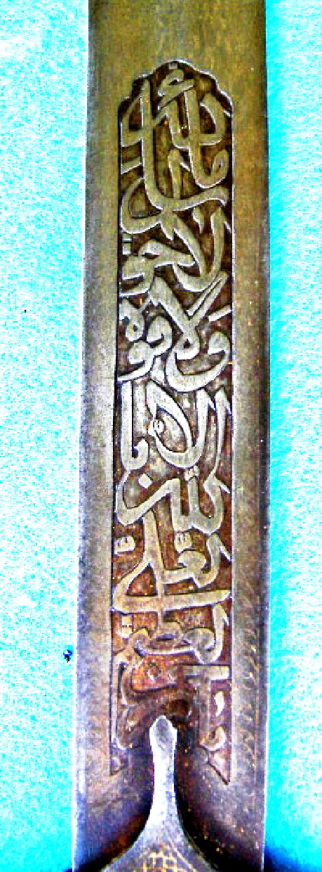

translation of the inscription on the blade, religious invocation
"no power nor strength except in Allah"

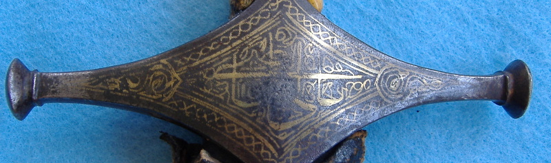

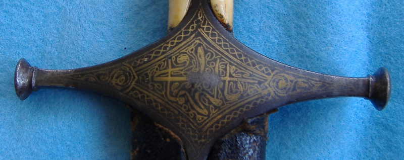

Here are some better pics of the guard without flash, so hopefully that will help in translation.
Obviously the script is Arabic, but is the text Arabic or Farsi??

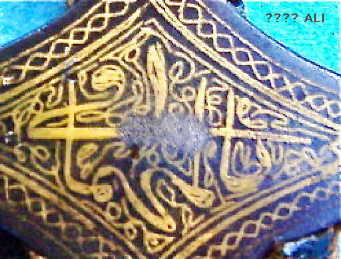

Hi Charles
definitively the text is Arabic,
positively in Farsi, because each side has as mention ??? Ali and ??? Mohamed
the Chiites are usual* to use the mention of "Ali" even associated with the name of Mohamed
à +
Dom
*Ali is much more popular with Chiites than with Sunnites

That is a very astute observation Jens, as these 'trade' blades did indeed appear often in the Syrian mounts (as seen in the hilt in my avatar) as well as many other swords in Arabia, the Caucusus, India and many other regions which received these exports. These began being produced around the late 18th and early 19th c. in Khorassan, Qazvin and Isfahan, and continued even later .
It is my impression from the rather straight type blade, and the fact that this does appear to be one of these Persian trade blades, this is likely an Arab Bedouin sword and quite likely imported via Baghdad rather than Damascus. The Arabs preferred Persian blades and swords, and the hilt on this sword is distinctly of Persian shamshir style.
Oliver Pinchot wrote a magnificent paper on the topic of these blades titled "The Persian Shamshir:and the Sign of Assad Allah" ("Arms Collecting", Vol.40, #1, February 2002) and on p.8 he notes, "...Persian damask blades were still greatly prized among Bedouin Arabs a century later (from 1811) . Elgood mentions the unification of the Aniza tribes under the Amir of Rwala, during the late 19th and early 20th centuries, who traded at Damscus and Baghdad".
This blade appears to have a very good quality watered blade (and I would defer to those he more well versed in metallurgy) but still carrying the devotional panel on one side of the blade and the stylized lion pictogram characteristic of these trade blades.

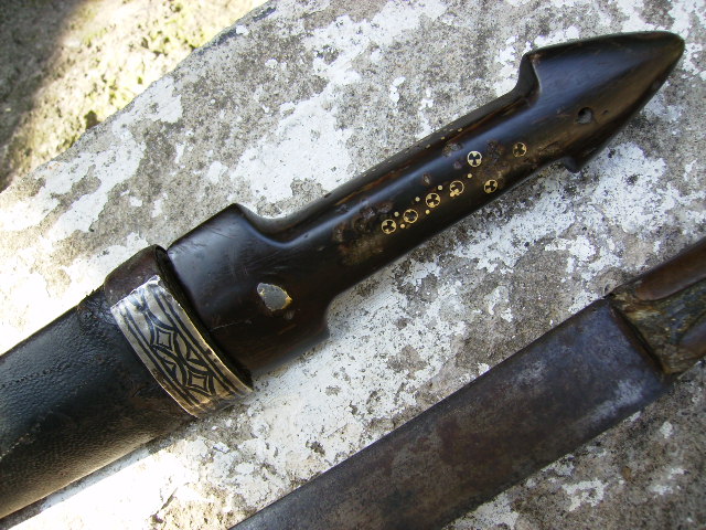

Here is an interesting hilt. The qama on the picture is currently in Bulgaria, but I have been told that it was initially acquired in Istanbul recently. I think it safe to characterize the qama as Turkish.
If Chalres's sword was indeed exported initially to Southern Arabia, what are the chances it made it to Northern Arabia? To me it seems that the hilt inserts are Turkish or Turkish influenced.
