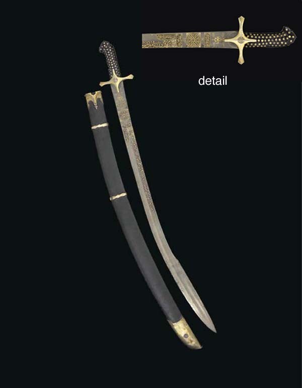

Default Ottoman Pala
Just ended
http://cgi.ebay.com/ws/eBayISAPI.dll...MEWA:IT&ih=014
Barbarically kitschy, but that was the style...
With all due respect and admiration, I am very uneasy about the state of koftgari: isn't it incredibly intact on the background of a heavily cleaned blade? And the crosshatching looks as new as the day it was made ( Hm-m-m-m....)
Opinions of professional blade restorers ( Battara, where are you?) would be intriguing.
Old 24th January 2008, 07:15 AM   #2
Posts: 10,733
It is interesting that the term 'palasche' is used in the auction description of this lavishly decorated sword which is of course,as further noted, an Ottoman pala.
The palasche description is noted from an uncited book on Islamic weapons, which apparantly describes a similar example as an 'Egyptian palasche'. I think the term may derive from the Stone reference (p.479) which illustrates this as a 'Polish sabre' of 17th century with blades either straight or very curved. Obviously the term either readjusted or became misconstrued as it seems now that 'pallasch' refers to a straight bladed sword. Of further interest in the entry is that the sabres shown in Stone, similar in mounts to the kilic/pala, the lavish decoration described as gold damascened and set with coral and turquoise.
As Turkish swords clearly had profound influence on the swords of Poland, despite the obvious conflicts, it is simply interesting to note the similarity of decoration, clearly Ottoman derived from 17th c. and the use of the palasche term in the uncited reference noting Egyptian attribution.
It seems that I have seen a similar example a number of years ago with lavish coral decoration of this type in a pamphlet on Islamic arms which I believe was Rich Wagners collection and I believe the text was by the late Walter Karcheski, and though only a few pages, pretty fantastic! I regret that I cannot recall the specifics, but it seems it was suggested that the sword was from Algeria. I believe these may have been for presentation or diplomatic gifts in the expansive Ottoman Empire.
With diplomatic or presentation swords, if I am not mistaken, it is not uncommon to have koftgari applied and or wording etc. placed on trophy blades which are then mounted, as this may have been. I recall seeing references and illustrations referring to this practice in Russia with older trophy blades with gold inlaid wording as awards to officers for gallantry etc. While this is just an example, it seems of course a widespread practice which likely included the Ottomans.
Although the decoration seems a bit overdone I must admit I've developed a keen admiration for coral and turquoise while travelling through the southwest lately! I am curious about the symbolic or superstitious application of these stones in the parlance of the Middle East.

Ariel, your opinion is very valid. Not only state of coftgari is questionable, but the way/quality of application. It is not "True Inlay", as one would expect on true quality Pala blade. Moreover, it's poorly executed, considering authentic examples. I suspect the whole blade is new (relatively) and I've seen similar Pala blades coming out of India. I have a picture somewhere and will find/post it soon.

10K would be a Great Deal IF this Pala would have authentic blade and coftgari. As Ariel noted, both look suspicious, i.e. not authentic, and I suspect even new. Any other opinions/observations?
Old 24th January 2008, 05:50 PM   #6
I am not saying the blade is new/replaced: it fits the scabbard very well. Taking into account the complexity of this particular scabbard and the need to create custom scabbards for each individual blade ( to account for the curve), I am sure that the blade is authentic.
The inscription, IMHO, is very recent, however.
So, the question will be: does a Kilij/Pala with a sumptuos furniture but with an unembellished, likely unmarked, blade justify such a high price? I think, yes. Not long ago, a somewhat similar sword, with (likely) ruined blade but with gorgeous furniture was sold for ~$20K. It was bought purely for the scabbard.
The price is a matter for the buyer: perhaps, he has a client to whom he can resell it for twice as much.
The real question is: is it legitimate to embellish blades with inscriptions to make it more attractive but in exchange to cloud the origins of the sword for future research ? If, as I suspect, the koftgari is new, the true origins of this Pala are now contaminated with erroneous information.

JUDGEING FROM THE OBVIOUS GRINDER MARKS SEEN NEAR THE ENGRAVING I WOULD DEFINITELY BE SUSPECIOUS OF THE BLADE BEING TAMPERED WITH. IF THE BLADE IS OF GOOD QUALITY AND OLD I CAN'T TELL FROM A PICTURE. AN EXPERT COULD PROBABLY TELL MORE IF IN HAND AND COULD ALSO SEE IF THE CORAL AND TURQUOISE WERE OF THE RIGHT KIND WERE GOOD OLD PIECES OR NOT. IN ONE PICTURE THERE IS ONE PIECE OF CORAL MISSING WHICH IS A GOOD SIGN.
CONSIDERING THE PRICE THIS BROUGHT AND PRICES STATED OF OTHER SALES IT IS LIKELY SOME FORGED EXAMPLES HAVE BEEN MADE OVER THE YEARS. THIS HAS HAPPENED WITH OTHER EXPENSIVE SWORDS THAT WERE IN DEMAND OFTEN SEVERAL TIMES DURING DIFFERENT PERIODS ON THE OLD ONES. I DO HOPE THE BUYER GOT HIS MONEYS WORTH AND ENJOYS HIS SWORD, BUT IF IT WAS JUST BOUGHT FOR RESALE OR INVESTMENT PURPOSES THE SWORD IS NOT IMPORTANT JUST THE CASH PROFIT OR FUTURE VALUE.

I would not dismiss an idea that the blade is/was replaced because I've seen these swords and know people who can modify ANY scabbard for ANY blade and make it look 100% authentic. Looking at just pictures one will NEVER tell.
Below is a picture of newly made Pala sword. The blade of classical Kilij form was just made in India. A new coftgari is being applied as you read this post somewhere in Syria...:-)

The koftgari I agree is a later addition as Rand said. I took a look at the pictures and the quality is more in keeping with that commonly coming out of India now. I think it may be that it is a restoration based on the remnents of what was originally there (I would hope anyway ) and if so I would call it a restoration. As restorers they may have had to re-cross hatch the area to have sharper grooves to "catch" the koftgari. This would of course not be true inlay but koftgari on the surface.
