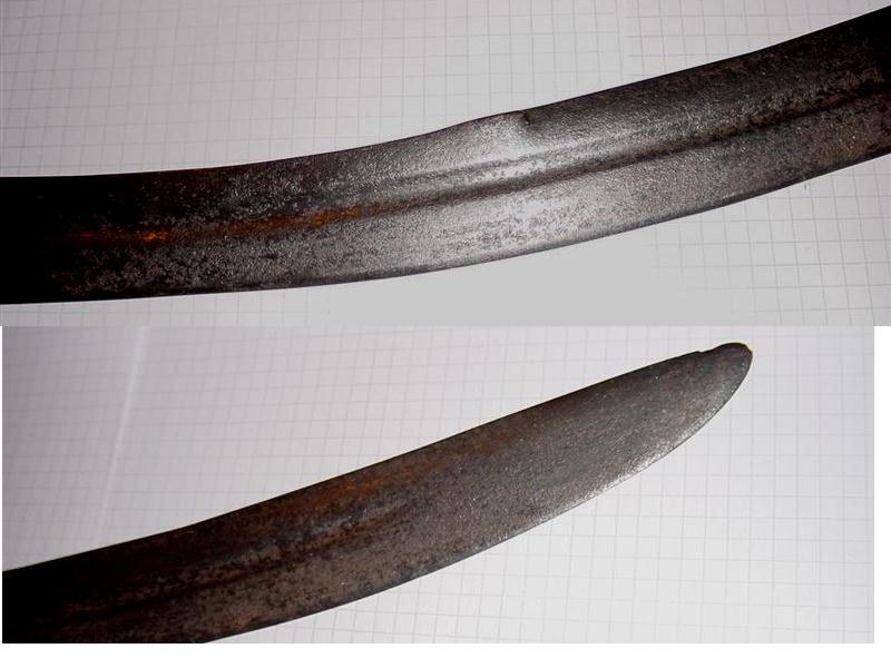

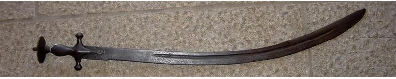

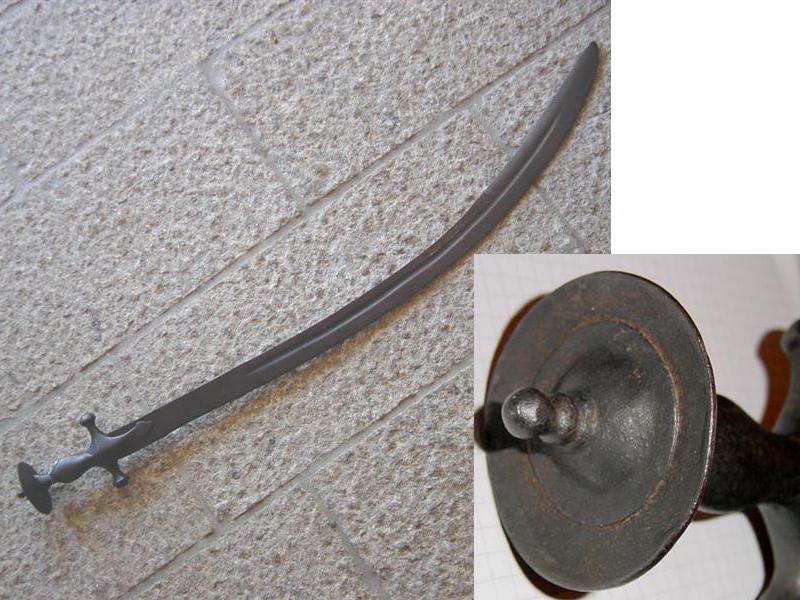

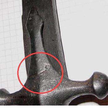

I am calling it tulwar, whereas this could be one of its variants.
Blade is 76 cms.(30") in straight line. The width at forte is 33 m/m.(1 1/8").

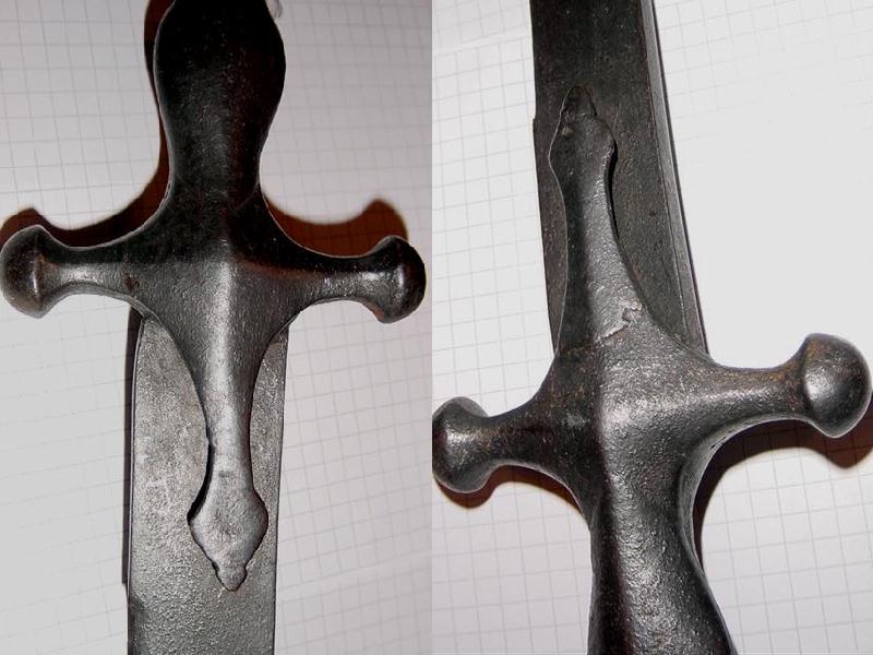

One of the langets was replaced, i think at the period, by brass brazing ( thanks Spiral for the input).
It has a full patina texture, but i am not certain if the dark ( black ) tone is the original, or somebody's later intervention, to perserve it or show it off.
A yelmen is visible, with a discreete protuberance.
What do you Gentlemen think of this specimen?
Thanks in advance.

A wonderful example of what appears to be a tulwar from northwest India regions that is quite likely end of 18th century. It is so hard to really say the age on these, especially from photos, but the sheer simplicity of this piece in the hilt, and the very heavy blade suggests it is indeed a fighting example.
The extremely widening of the blade back is of course what we term the yalman (though it seems there is a degree of dispute on the term), but does reflect influences from much earlier sabre development with nomadic Central Asian tribes. It seems that the feature did not typically stay with most blades found on talwars in the 19th century (there are of course exceptions, especially in very high quality and specially made pieces).
The deep pitting that shows evidence of non uniform pock marking would suggest the integrity of the patination on this sword, but I would defer on that to the more highly trained eyes that often gratefully comment on such matters here. By form itself however, this would seem a good solid example.
It looks wonderful as is Fernando! Please resist the common desire to shine it all up! While there have been some fantastic examples of swords restored here that have endured grinding wheels and terrible overcleaning that were incredibly restored to beautiful condition, this is the one exeption that in my opinion would allow for such measures.
In my opinion, such sound examples of these earlier weapons deserve to wear the patination and darkening they have so honestly earned over so many years (to me it represents a physical manifestation of history but its the romantic in me!).
One thing I always notice on so many talwars is the position of the langet often seems canted to one side and off center. Would this be from the remounting or reworking the weapon? Naturally checking the patination and discolorations etc. for a match would tell more on the age of such work, but could such positioning come from the reseating of the hilt carelessly, or could the position sometimes have been intended? Could striking action cause the hilt to shift later?

Another Tulwar Fernando are Tulwars becoming an obsession
Looks to be a nice, honest fighting sword, I agree with Jim (Hi Jim ) don't be tempted to clean it.....part of its charm is its aged look and once the patination is gone, you can never replace it. (well you could send it to China....they seem to be getting rather good at falsely aging antiques )

Concerning your observation on the tulwar frequent offset of he langets, in my humble opinnion i would go for the version of the mount or remount. Maybe this could easier happen with the specimens without rivet fixation, for lack of consequent adjustment rigour. I keep seeing tulwars without rivets, namely the ancient ones, and in my fantasy the rivet addition came at a later stage ... but that could be because i haven't yet seen enough examples to be certain that these were concurrent versions. Mind you, the example i am showing here was surely remounted, as it had a new langet welded ... visibly not the the same piece put back, maybe because it was lost in battle ( to make it romantic ).

Thank you so much for your excellent response in kind!!! I really appreciate you going into detail with your very well placed observations, and think you are pretty much on target mostly. I am not too sure about the khanda though, I think the early examples seen iconographically are open hilt, but I do agree the knuckleguard seems likely pre European contact or outside that particular influence. The said influence may have reinforced the use of this element already in place, but more specific research needed.
Very good points on the Portuguese fencing styles in comparison to that of Indian, and the point that even with shields used to receive blows, the dynamics of close combat would invariably result in blade to blade contact. In that case, one certainly would need some protection.
Possibly the open hilt talwars were intended for court wear? But then even these occur in munitions grade, fighting use weapons.
I think what you say on the angle of the langet, and of course it might have been rewelded as you suggest, these weapons were often 'in the shop' during thier working life!
Ward, I agree with your note that this is a 'generic' example, but what I had noted was that was the beauty of it, its a good example of a sword not suggesting having been 'worked over'. I believe it would be good to use disgression on the price. I actually learned to favor these weathered and worn examples for thier integrity, but I admit a lot of it was my budget too!
To me having a sound representative example that would not have been worthy of tampering was what I needed for study. These I viewed as solid pieces of history.
