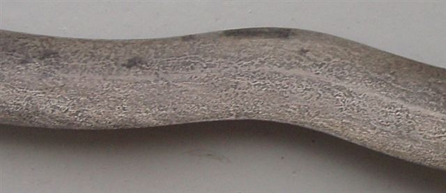

Dear all,
Enclosed some pictures of a keris I have seen. I have seen simular flower motives on a antique silver Malay box. It is said that the South Philippine owner of the keris died in 1942 and that it was sold after world war 2 and ended up in Europe. Can anyone tell more?.
Thanks in advance.
Bart.

That is beautiful metal work. I'm not so sure it is Malay though. The patterns look like okir to me. I think this is a Moro piece.
Do you own this kris now? Or have access to it. I would love to see more close-ups, especially of the blade and the hilt.
Do you know the dimensions of the piece?

I have bought it very recently. and I will try to send a close up picture. The hilt is 12 cm and the blade is 30 cm. So total length is about 42 cm.

Sorry, still learning how to mail. I have bought it very recently. The hilt is about 12cm and the blade about 30 cm. So the total length is about 42 com. I will tru to mail a close up.

I believe it's a Maranao kris, the hilt is a feature. I've seen a similar piece in John's collection. Unfortunately, KampungNet is still not up, yet. Should be able to see it in a a day or two, hopefully.

It is Moro alright, and the metal work is okir with gold and silver. I think though it is Sulu and later than WWII. Nice work for recent material. Might be made for a recent wealthy datu (chieftain).

The base of the blade of this kris has many features of a 20th century piece. I wonder wether it might be a bit older than WW2 period though: There seems to be a separate gangya or possibly just an engraved line...
I second the call for more pics, especially close-ups of the base of the blade!

I agree with Jose. This seems to be a Sulu style of kris, but I would have a small bet it is Maranao made. The okir work looks very much like the contemporary kris of similar style coming frm two brothers in the Lake Lanao region. The quality of their ornamentation is very high, but the blades are poor quality.
I would check the provenance of this one very carefully. It could well be less than 20 years old. This particular type of small kris is being reproduced very well and could easily deceive a buyer into thinking they have acquired an antique "Sultan's kris" (which is often how they are described).
These contemporary kris will appear more frequently outside the Philippines, as they diffuse into more Western markets. Caveat emptor.
Does anyone else think the hilt on this one looks a little Balinese?
Ian.
Edit: An after thought about the blades on the recently produced Maranao "Sultan's" kris. They are usually etched with acid to give a "watered" appearance and are usually not a laminated construction -- the blade pictured above has the rather mottled appearance of an etched rather than a laminated pattern, but it's hard to tell from pictures. They also usually have an engraved line rather than a truly separate gangya.

I will try to make a close up picture of the base of the blade and will post it this evening (EU time). The gangya seems to be seperate.

I will try to mail a close up of the blade base. As far as I can see the gangya is seperate.

The hilt is about 12 cm and the blade about 30 cm so total keris is about 42 cm. Enclosed the best I can do for a close up. I only have a simpel digi camera. Hope you all can tell me more about this keris.
