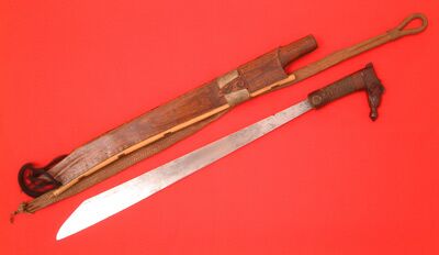

I stumbled across this at an antique mall in Cincinnati, of all places. Not exactly known for it's ethnographic weaponry. Sorry for the bad photos. Shot it very quickly in the fading light last evening.
Can anyone put a better ID on this one. Sorry, i forgot to measure it, but it has a fairly short blade. I'll add the measurements when i get home tonight. I hesitate to call it a mandau because the size and shape seems a bit different. Seems like a well made old blade though and i love the hilt carving, which is also a bit different than ones i have seen.

Old 16th July 2007, 09:44 PM   #3
Fabulous!
This is the classic example of a beheading sword used by the feared Headhunters of Blue Ash!

Old 16th July 2007, 10:52 PM   #7
Hello David,
Hmm, the blade and the hilt do show some skill. However, I'm fairly sure the hilt isn't carved in any traditional style - looks 20th century to me, possibly for someone travelling for pleasure...

Old 17th July 2007, 12:42 AM   #10
I LIKE IT IT LOOKS LIKE DAYAK WORK TO ME BASICLY TRADITIONAL DESIGN WITH A FEW THINGS ADDED THAT LOOK MORE LIKE BATAK, THE SNAKE FOR INSTANCE. I WOULD ESTIMATE IT IS NO NEWER THAN 50 YEARS OLD AND PERHAPS UP TO 100 ,CAN'T TELL FROM THE PICTURES EVEN THOUGH THEY ARE VERY GOOD. I WOULD CERTIANLY LIKE TO ADD IT TO MY COLLECTION IF IT WAS IN MY PRICE RANGE. TOO BAD IT IS MISSING ITS SCABBARD, I SUSPECT THE MANDAU EXPERTS WILL BE ABLE TO TELL YOU MUCH MORE. WISH I COULD RUN ACROSS SOMETHING LIKE THAT IN AN ANTIQUE SHOP AROUND HERE.

Posts: 7,218
hmmm, well the blade is rather weighty and well made and shows considerable wear and patina, as does the hilt. The pictures don't do justice as i suggested earily. If this is 20thC it is certainly very early on in that century. I suppose the hilt could have been a latter addition, but it doesn't look or feel that way. Everything about this piece gives me the impression that it saw a good deal of use. Maybe "someone travelling for pleasure" cut through a few jungles with it on their journeys.
Its overall length is just shy of 20 in. with the blade alone only 14.5 in.
Rather compact, still very sharp and definitely dangerous, even for its size.

Old 17th July 2007, 04:33 AM   #16
Posts: 7,218
Thanks Dave, Ben and Barry for your responses.
Ben, i will try to do some more pics tomorrow evening, but i won't be able to get any more shots up for a couple of days.
BTW, the brass isn't very well connected to the hilt at all. I did a quick re-wrap before i photographed it and frankly i do not know whether the brass ring belongs at the top or bottom of the wire wrap. It seemed to make most amount of sense at the top. When i have time i would like to do a better restoration job on the wrappping.

Old 18th July 2007, 03:32 PM   #18
Posts: 7,218
Yes, i have never seen metal pins in one of these hilts either. I was hoping that might be a clue to its origin. Thanks for commenting.
Given the size and shape of the blade does anyone care to put a more definitive name to this form, or are we best off just referring to it as a parang.

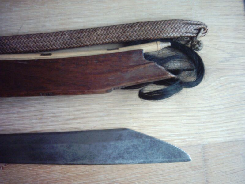

Old 18th July 2007, 03:42 PM   #19
asomotif
asomotif's Avatar
Join Date: Nov 2006
Posts: 2,235
Dear David,
The blade is a mandau. (is assume the blade is concave/convex ie. hollow grind on the other side of the blade)
Simple blades with the rather blunt point often are pretty old.
pre 1900 is possible. (see enclosed pic of my koetei mandau)
So who knows what other forumites may come up with on the hilt.
Old 18th July 2007, 03:51 PM   #20
Posts: 7,218
Mandau it is then. It is a concave/convex form. The blade definitely gives me the feeling it may be 19th C.

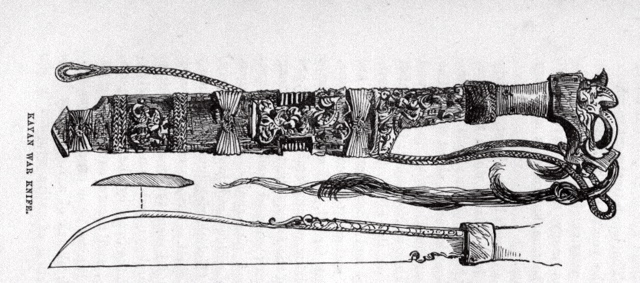

Old 18th July 2007, 05:32 PM   #23
VVV
VVV's Avatar
Posts: 1,637
It reminds me in size of this Kayan parang described in a book from 1880.
Like Ben I don't think the motifs of the handle is Iban but I don't know from which tribe it is.

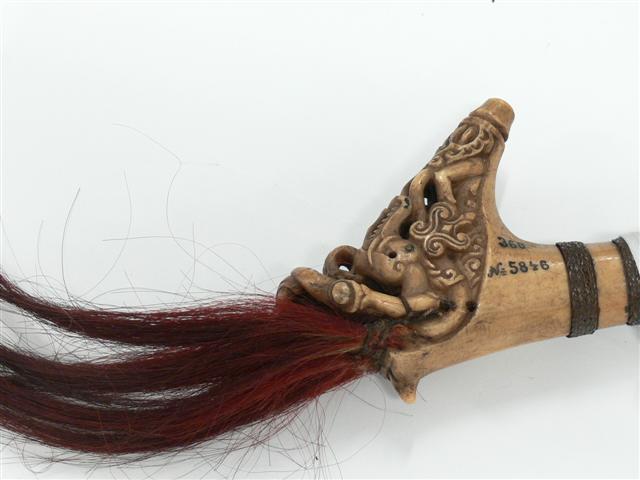

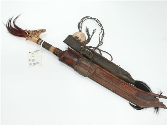

Old 18th July 2007, 08:44 PM   #25
Mytribalworld
Mytribalworld's Avatar
Join Date: Nov 2006
Posts: 400
Hi David,
The piece is indeed from the 19th.
When I did recearch in the collection of Leiden I found a mandau with a similar carving.They have more of this type in the collection.see enclosed pics.
The blades of these mandaus are mostly small and undecorated.
Scabbards have a curious boatstyle endpiece.
Mandaus like this are found in the south of Borneo, on one of these the tag says " Banjarmassin" .Most mandaus of this style are from before 1900.
It should fit in my study course I think these mandaus had there influence on the mandau's in the Kutai area,or probably old Kutai mandaus did also have this shape? Whats quite typical is the " non dayak" style in the carvings of the hilts.Its too early for me to say anything about that,but in the area of Banjar were living a mix of different groups malay,dayak,chinese etc.
possibly they have influenced eachother and that could also be seen on this mandau.
friendly regards,
Arjan.

Old 18th July 2007, 09:01 PM   #26
Posts: 7,218
Thanks for that info Arjan. I see the same mirrorred "S" motif on thios example. Great research!

Old 19th July 2007, 03:24 PM   #28
Posts: 7,218
Thanks for addition info about Kutai mandau, but i don't think Arjan has said he thought mine was from there.
I wish there were some different angles on the photos of your example Arjan, but i can now see on the top the same style of opened mouth creature that is on mine so now that is 2 motifs in common between these hilts. There definitely seem to be from the same area to me. I wonder if the museum you found it in has any more information of were it was collected?

Old 19th July 2007, 04:33 PM   #30
asomotif
asomotif's Avatar
Join Date: Nov 2006
Posts: 2,235
The Hilt of Davids mandau clearly has similarities with the exmaple that Arjan is showing in this thread
Now compare the example from Arjan with my mandau that clearly has a Koetei handle.
Simple short blade, broadening scabbard , rattan stick on the scabbard.
I can see the transition / influence .
