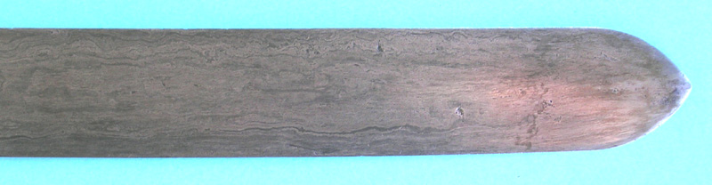

Hello all,
I bought times ago this Moro keris. It has no clamp, the ivory ferrule looks original and hasn't any kind of groove for them. Your opinion is needed.
I would also know its origin.
Thank You in advance
Paolo

Hi Paolo, i don't know about the handle (for sure the scabbard seems recent), but the blade it's a very beauty!! For sure other members will tell you more!

Beautiful, intersting, blade. The hilt pommel appears original, but the ferrule does not seem to be of the same quality...perhaps bone?
There is, indeed, a place for the baca baca, but it appears to have been ground down.
The hilt has certainly been rewrapped, I think fairly recently.
Again, a lovely blade, but the rest may have been worked up to create an attractive, but composite piece. Even so, there is also a possibility that it was reworked in this manner to create an attractive, later, presentation piece.

Does anyone else think that this blade might be of Indonesian origin?
Beautiful BTW.

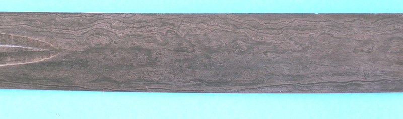

I'm with David - I'm also convinced that the blade was crafted in Indonesia or Malaysia (and most likely all fittings, too). Looks like a piece which Adni could have sold... Paolo, are those pics from Artzi?
I don't think the blade was ever supposed to be fitted with an Asang-asang - the file work in that area resembles more the usual keris style and is one of the reasons why I think a keris smith made this blade. It also seems to have regular pamor. The latter seems to be invariably present on modern reproductions by Maduranese smiths. However, this piece looks nicer than all those "Madura Kris" I've seen and I'd be tempted to believe this is a genuine (vintage?) Malay/Straits piece with new(er) quality fittings. Maybe our forumites from Singapore can chime in?

I don't bought it by Adni. The seller was Asoka arts in England. I took the pics.
Paolo
