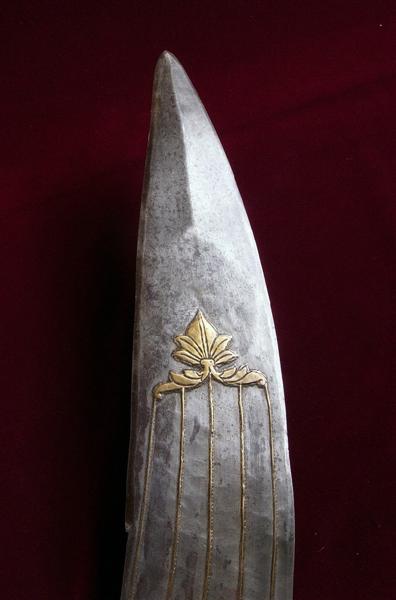

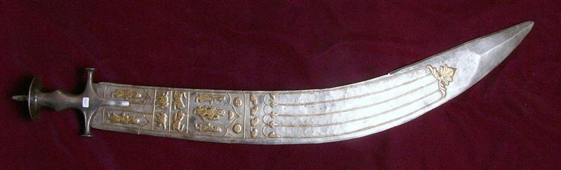

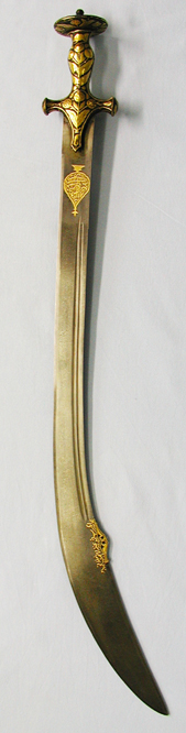

Indian Sword. 38" long overall and 3 3/4" wide.

My intuitive feeling is that Indian swords with profuse brass inlays are more likely to be tourist grade, aimed at dazzling the unsuspecting Westerners... Please surprise me !
Hi Ariel,
Usually I would agree. First, this is a substantial sword. Has a sharp edge, not razor sharp, but enough to cut with the weight of this piece behind it.
Also take a look here.
http://www.oriental-arms.com/item.php?id=2194
Not a definitive answer, but a good indication.

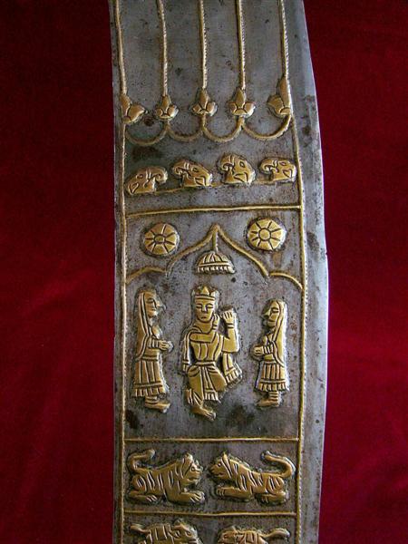

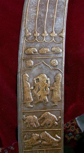

Hi Bill, nice sword!
"Sacrificial" comes to mind
I wonder why the executioner is wearing all those spikes and carrying a shield when his job is decapitating a (presumably) tied victim. Must be an interesting story there.
Emanuel
Thanks Emanuel,
He should not need protection against a tied victim, however there is always a question of a spiritual attack from the dead. Quite a concern, actually, especially if you were the one sending him on his journey!
I don't think that he is necessarily dressed for combat in a usual sense. For one thing he is barefoot which could indicate a desire for a good connection and grounding with the earth rather than protection from the physical weapons.
I do like the armor, but the spikes would be of marginal value against swords, spears, arrows, etc. But it might. if properly consecrated, keep a spirit away, at least in their belief system.
It is very difficult to even get a marginal understand another culture's symbolism unless you can dig deeply into their religion and psyche. Even then true understanding will likely escape you.

I am also looking for references, but not finding much, however.
In Dr.Gaytri Nath Pant's "Indian Arms and Armor," (1980) Volume II, Page 84, he states:
"It is an Indian sabre with a broad curved balde and the hilt like that of a Talwar. It is used by the Muslim, Marathas and Rajputs. Those have hunting scenes engraved on the blades are are called tegha shikargaha.
"In the national Museum, New Dehli is displayed an heavy, 17th century A.D. Rajput tegha . . . ."
He provides no picture or further information.
And as Jens has already stated, Egarton of Tatton, "A Description of Indian and Oriental Armour," 1896, "In use by the Hindu Rangars..." and "Much used by the Mahrattas and Rajpoots in the time of Hyder Ali."
He was a Muslim ruler of Mysore, India in the mid-to late 1700s.
I am surprised that there is not more information about this sword as it would appear that it was popular, at least among the nobility. However I do wonder if the name "tegah" is confused or applied to something else as I have heard it compared to a nimcha.

Here is a tegha from E. Jaiwant Paul's "Arms and Armour, Traditional Weapons of India," where he states
"Sacrificial sword, Rajput, late 17th century A.D., National MUseum, The broad blade is engraved with figures of gods and goddesses, . . . . The sword was used to sacrifice buffaloes during the festival of Dussehra."

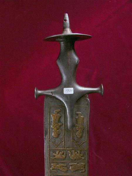

Originally Posted by spiral
Bill, I have had a couple of giant Indian kukri in the past with virtualy identical figures.
The steel wasnt tempered on either of them though.
Is the tegha tempered?
Spiral
Hi Jonathan,
Mine does seem to have a hardened edge. It resists a file. You might also note it has a heavy point, sort of like an armor piercing weapon. While I do not think that was the intent, it shows that care was taken when it was made. I don't think it was made for tourists.
Bill

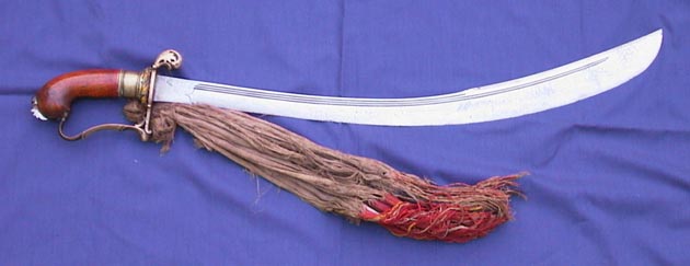

Old 25th December 2006, 02:49 AM   #19
Posts: 6,378
Cool Take This A Step Further ...
You wind up with this.
Old 27th December 2006, 04:21 PM   #20

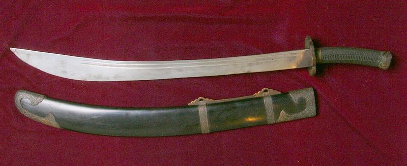

Rick,
I know what you have here, and yet the blade shape reminds me of another sword from far-away China.
Oxtail saber (niuweidao). Qing Dynasty. Commonly known today as " the Chinese Broadsword."
Many of these niuweidao were for the relatively unskilled bloke as a "chopper."
My pictures show an above average sword. Most were cheaply made and mass produced.
